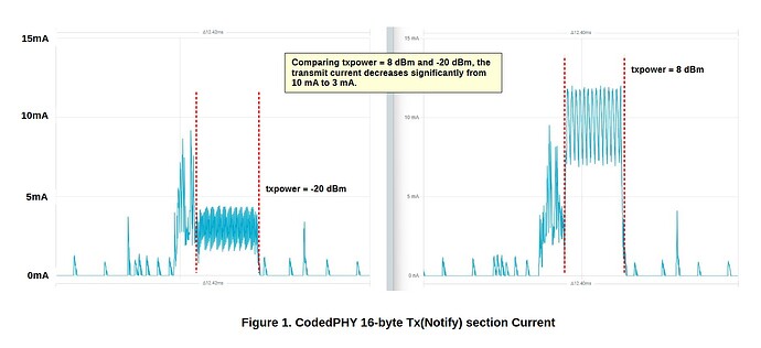

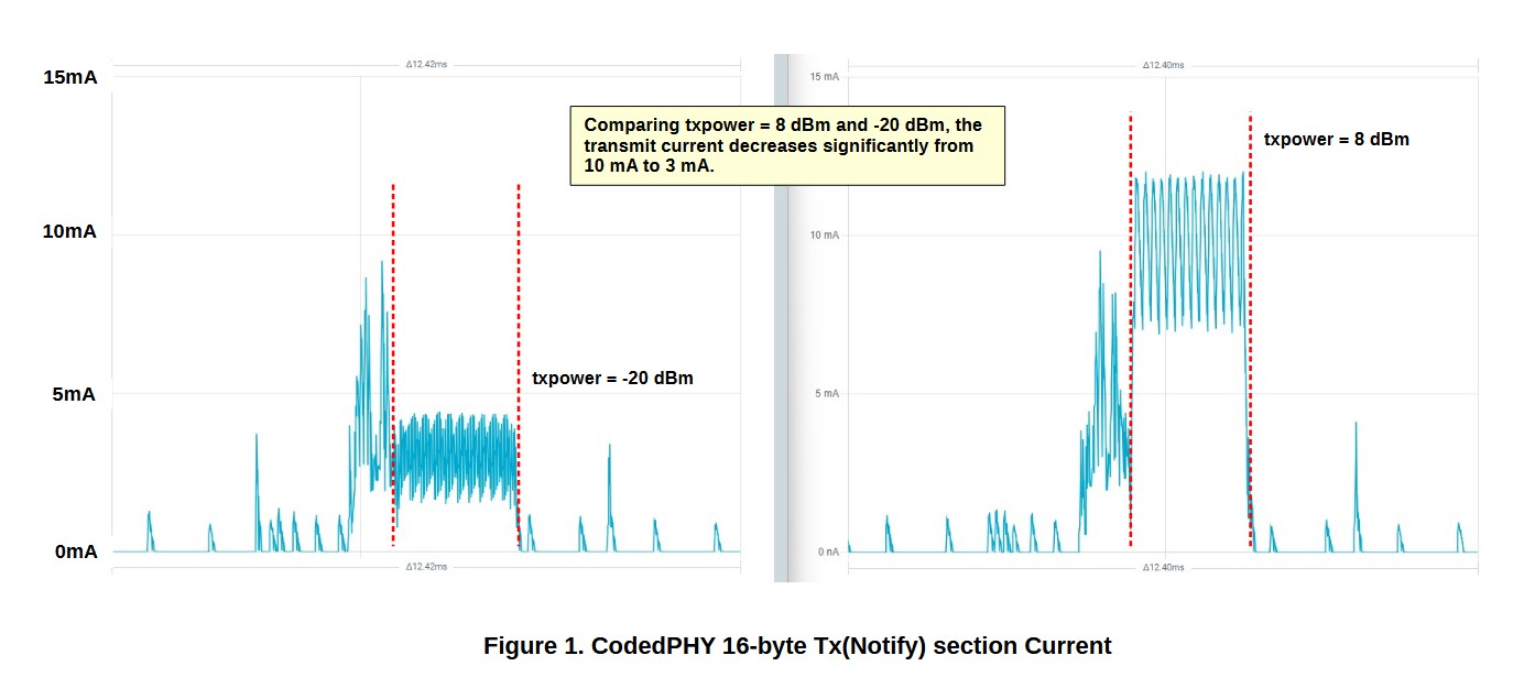

Figure 1 shows the current during a single 16-byte Notify transmission. Transmittion current drops from about 10 mA at +8 dBm to about 3 mA at −20 dBm. Lower TX power clearly reduces transmission current.

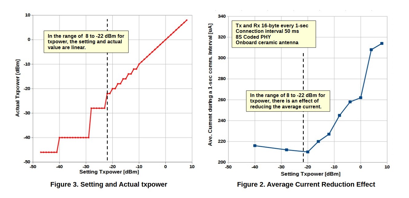

Figure 2 shows the 1-second average current while sending data continuously. Reducing TX power from +8 dBm to −20 dBm lowers the average current to roughly two-thirds. Below −20 dBm, the improvement becomes small because other processing currents dominate.
Figure 3 shows actual RF output vs configured TX power. The output is roughly linear between +8 dBm and −22 dBm. Below −22 dBm, the setting becomes inaccurate.
Because of this behavior, the practical control range is +8 to −22 dBm.

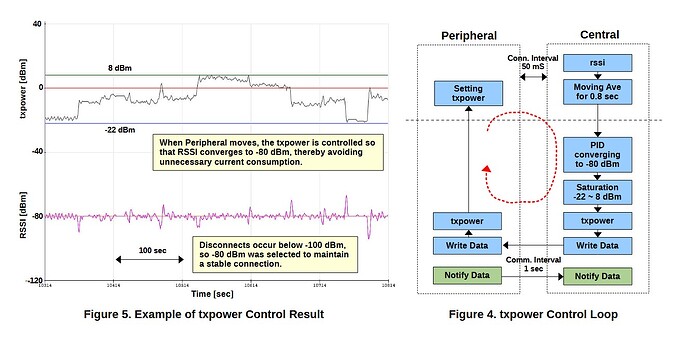

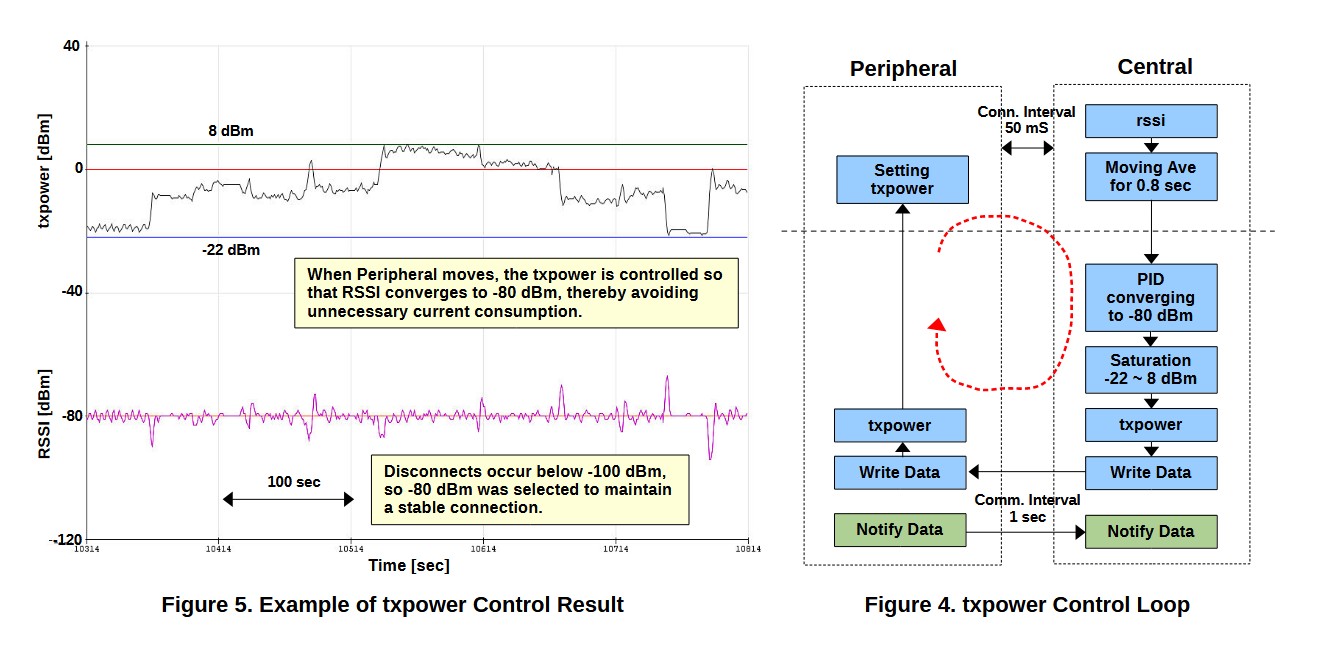

Figure 4 shows the RSSI-based TX power control method. Since disconnections often drop below −100 dBm, the target RSSI is set to −80 dBm for stability.
The control flow:
  1. RSSI is measured every 50 ms
  2. A 0.8-second moving average smooths the signal
  3. Every second, the error from the target is fed to a PID controller
  4. The controller outputs a TX power value (−22 to +8 dBm)
  5. The Central sends the value to the Peripheral via Write
  6. The Peripheral updates its TX power
Figure 5 shows RSSI and TX power during movement tests. The Central stays fixed in a corner. The Peripheral is moved around the room. After movement, RSSI temporarily drops or rises.
The controller adjusts TX power and RSSI returns to around −80 dBm within about 3–4 seconds.
TX power automatically increases when the link weakens and decreases when the link is strong, which helps reduce unnecessary current consumption.
