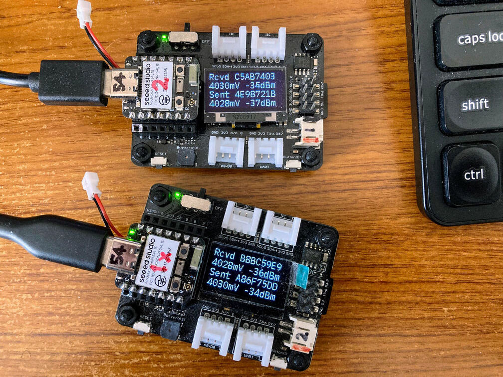

Having become somewhat familiar with using Zephyr+NCS, I wrote a simple project for practice to send and receive data bidirectionally between the nRF54L15 Peripheral and Central. I hope it proves useful to anyone interested.
Both the Peripheral and Central send and receive 16 bytes of data (timestamp, battery voltage, RSSI, and each other’s random number) to each other every second. The transmitted random number is received with a periodic delay, allowing for verification. When running on battery power, set CONFIG_SERIAL=n. The transmit power is set to 8dBm by specifying CONFIG_BT_CTLR_TX_PWR_PLUS_8=y, but this can be changed and verified by observing changes in the RSSI value.
