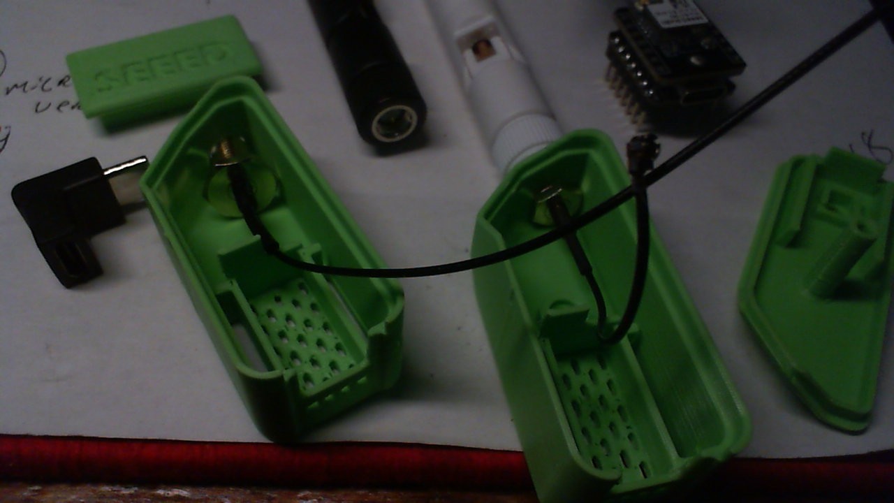

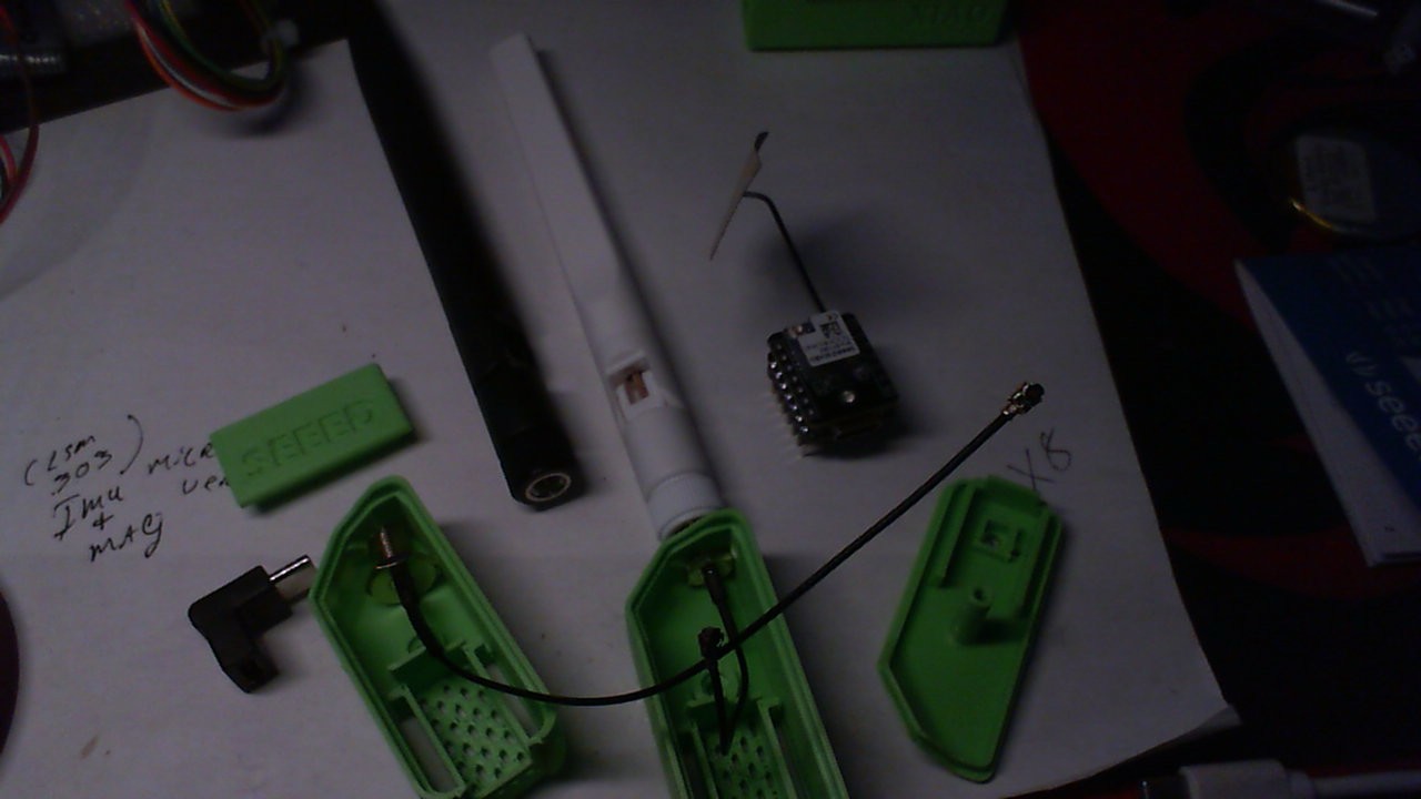

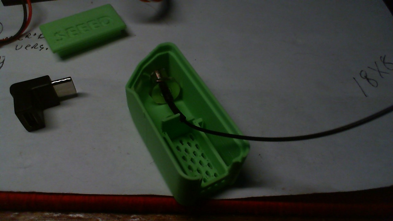

FYI, the original Pigtail had a smaller base nut, so the case doesn’t work with those. I’m modding the case to fit both but Heads up if you order the external Lora Ant. see the diffs:
Printed in that Sweeet Seeed Greeen :grin: :+1:
Stay tuned,
