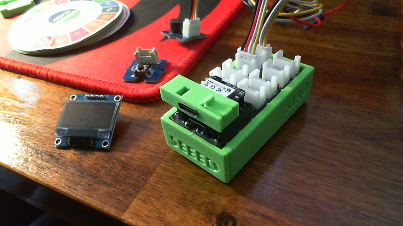

So I have this Problem. I can’t press the reset button. Easily! Sausage fingers?
After 7-11 tries I figured out some geometry and printed it in the Galactic Sun with the help of the “Magic Calipers” and b4 you know it .

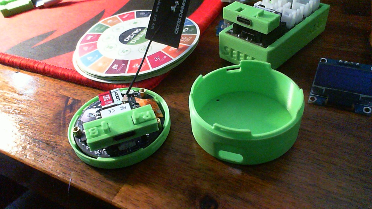

A snap-on Reset Helmet It’s not a shield or a Hat. Oh’-no. It is something that takes about 17 minutes to 3D print. This little nugget, Gives me easy access and I can snap it on or off, I show it on the Xiao BLE and Sense units one mounted in the Xiao Dev board kit with a display and the TAP demo running (Listen Closely) built with Arduino 2.1 to demonstrate. One is connected to a battery pack standalone. If you follow the Seeed footprint for the SMD layout it fits perfectly even when soldered onto a PC board visa-vi EasyEDA and JLPCB :slight_smile: NICE stuff. LOL ;-p
about the print;

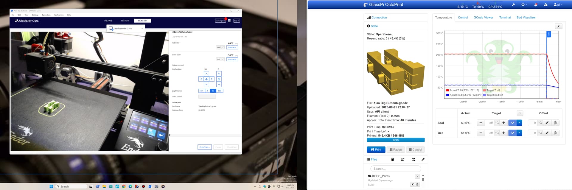

It’s up on Thingiverse and I printed it with PLA, on my Ender 3 Pro with Generic slicer settings in Cura 5.1 , Ironing enabled (top) layer if printed Straight up. I found it’s printed easier Upside down with tree supports touching the build plate. The cantilever button part has a clearance of .30 for an Exacto knife blade or #11 Scalpel to release the button if your printer is not that dialed in.

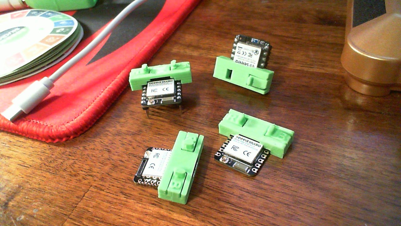

Back by Popular demand… Sequel to the " BIG-RESET "!

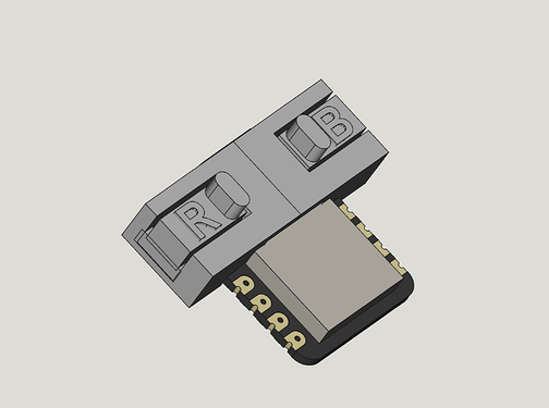

Big Buttons for Xiao…
Updated to the 2 seater…Same everything but better. :grin:
that sweet Seeed Green PLA +. (should be in the store)
Enjoy and ALWAYS , Have Fun! :+1:
Xiao Big ButtonS.zip (577.6 KB)
ZIP has both Nrf & ESP32 , Freecad and STL files to modify and /or slice your own. (I used Cura 5.10.1) also is the G-code if you just want to print it as is. (upright)
