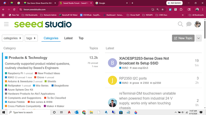

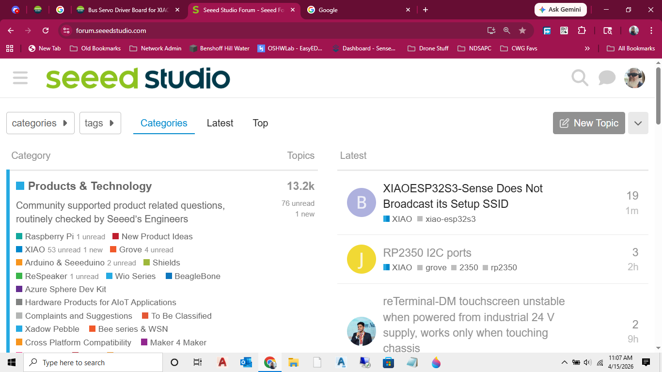

Was there ever a solution found for this? Im having a similar problem, although with the RA4M1, but I assume the solution would be similair and since it wont let me create a new topic until im trusted.. Im searching and piggybacking off of yours haha. I cant seem to figure out how to change the SDA and SCL pins for the Wire library and every solution I have seen on google results in compilation error. Seems like it should be a simple thing and Ive seen a lot of examples or posts about Wire1 or TwoWire and nothing I have tried will actually be recognized by the wire library. If you found a solution it would be much appreciated to share!
you just have to go up to the main level
and welcome here…
