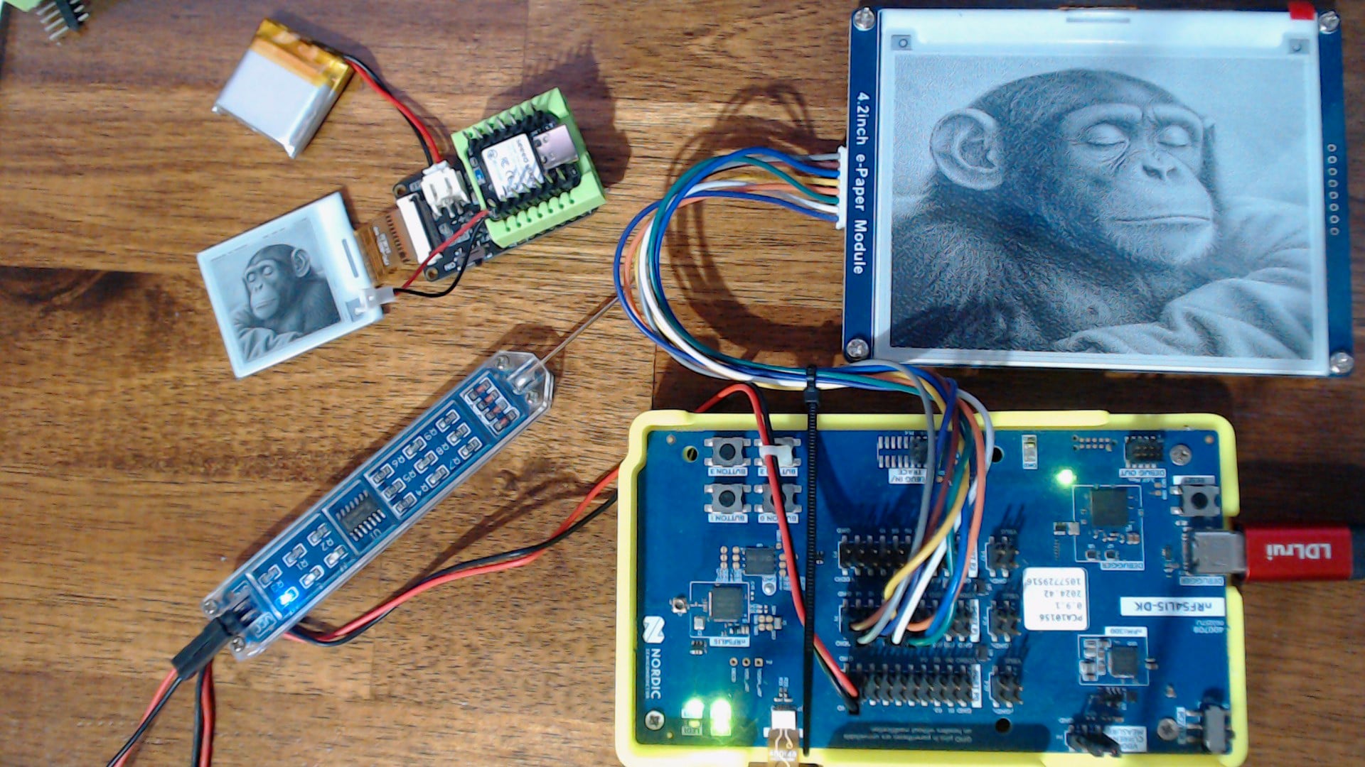

I’m using the E-paper and the Software SPI. (touchscreen) Next!

Demonstration Features
  • Nordic nRF54L15 DK (PCA10156)
  • Waveshare 4.2-inch 400 × 300 monochrome e-paper display
  • SSD1683 controller using Software SPI
  • Clean Arduino Core
  • Multi-page graphical user interface
  • Hardware diagnostics
  • GPIO overview
  • J-Link debug status
  • Floyd-Steinberg graphics demonstration
  • BLE Central operation
  • Battery Service monitoring (0x180F / 0x2A19)
  • Round-robin servicing of multiple sensor nodes
  • Deep sleep with retained display image

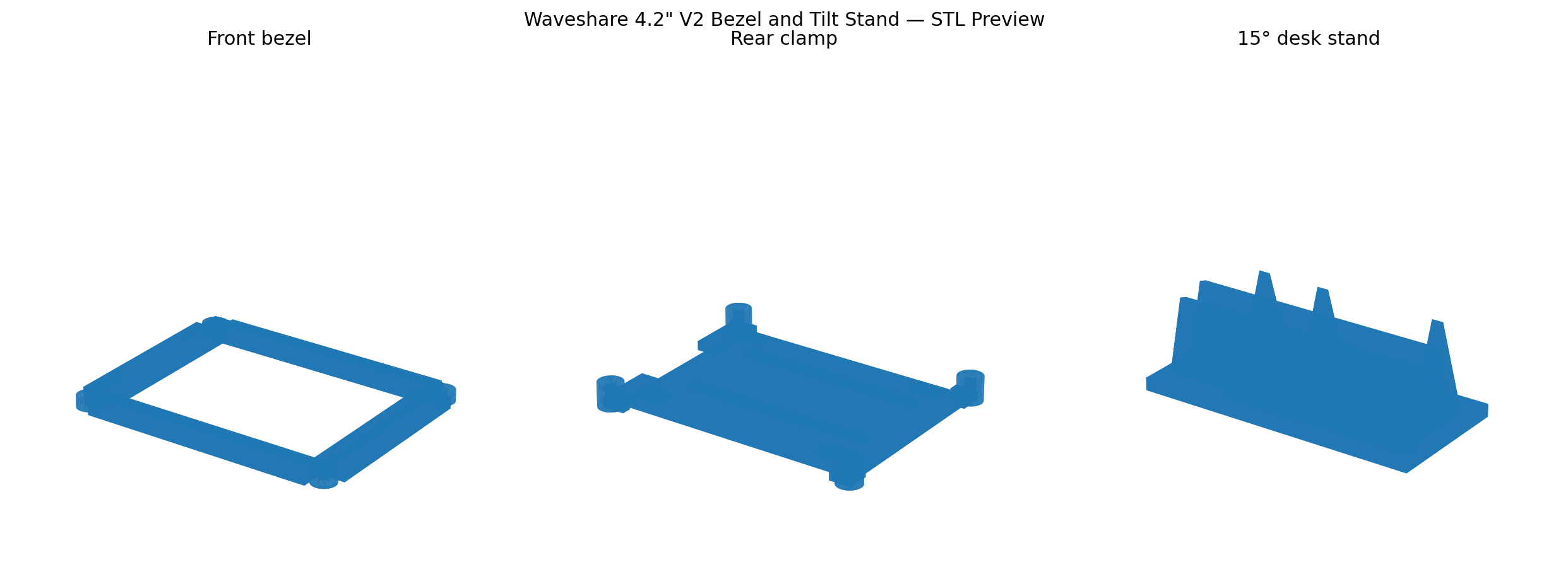

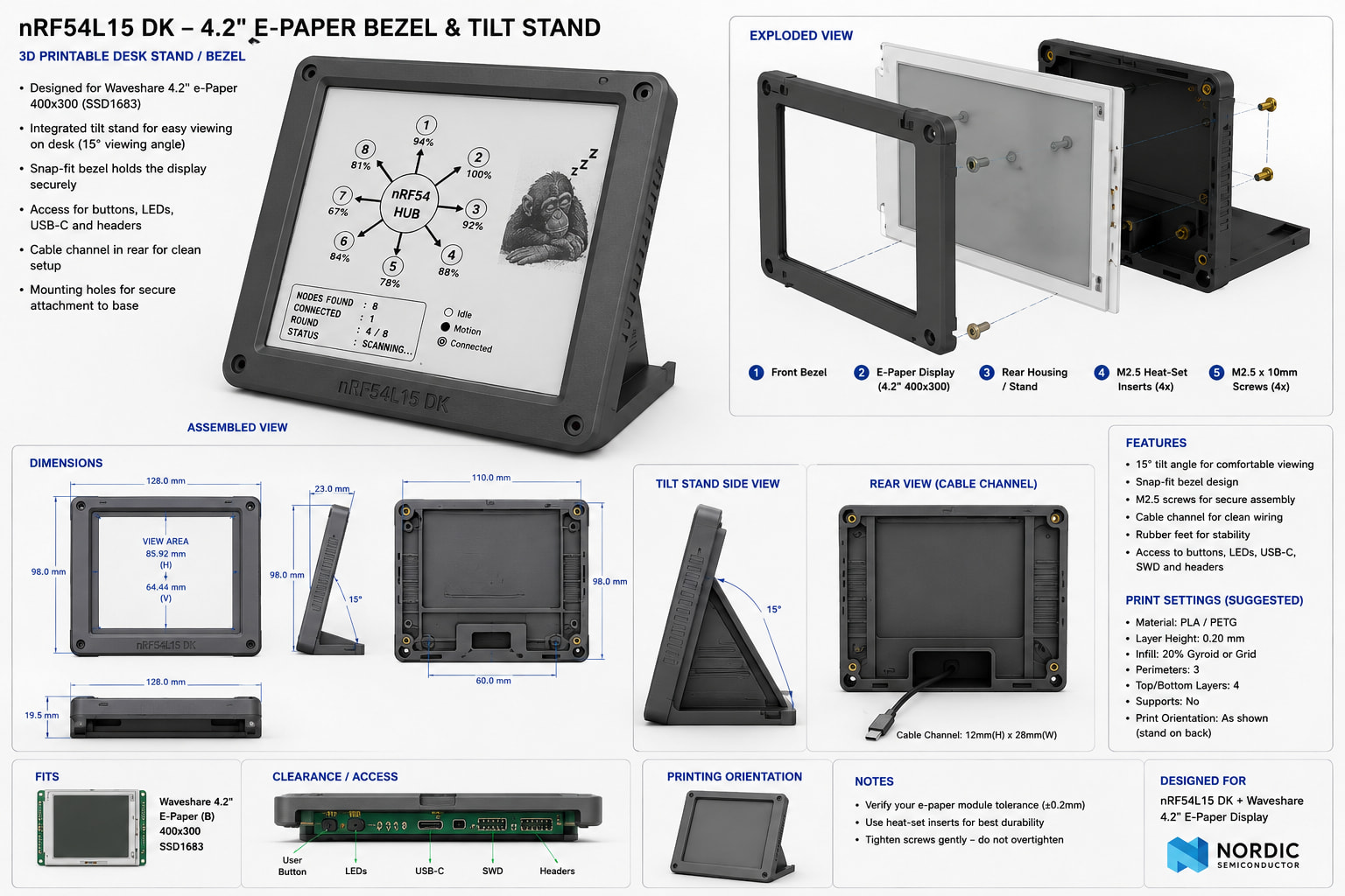

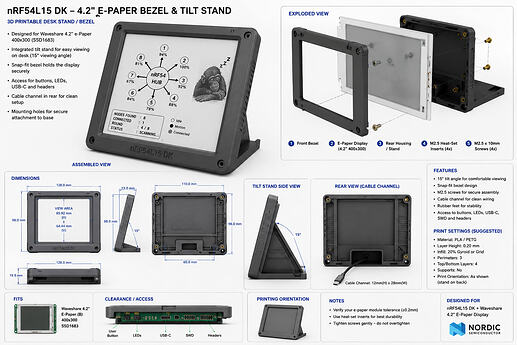

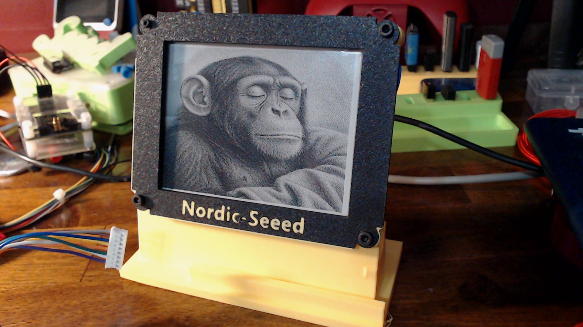

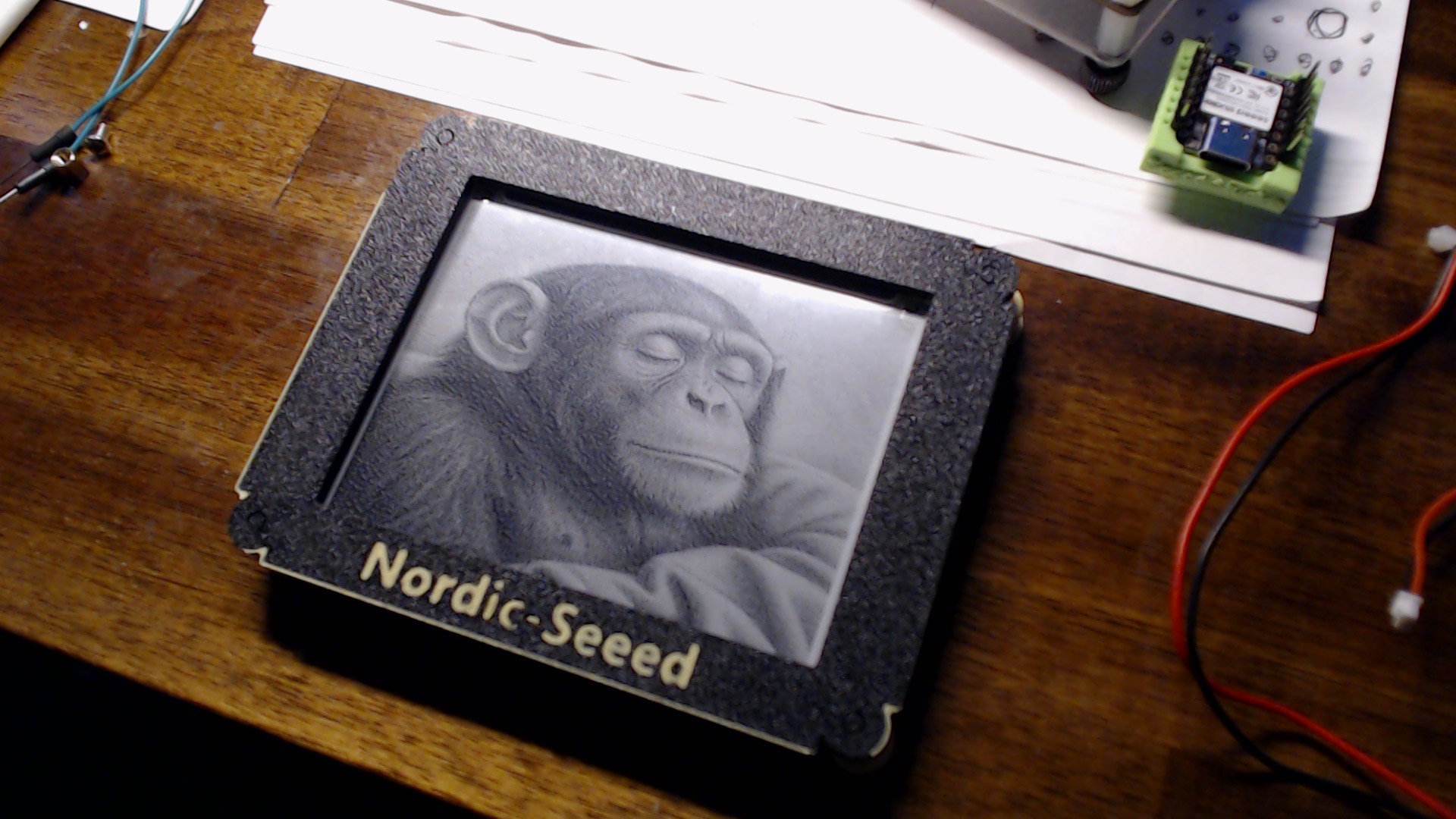

I got the Bezel printing NOW! :+1:

So , The Stand as Promised…
