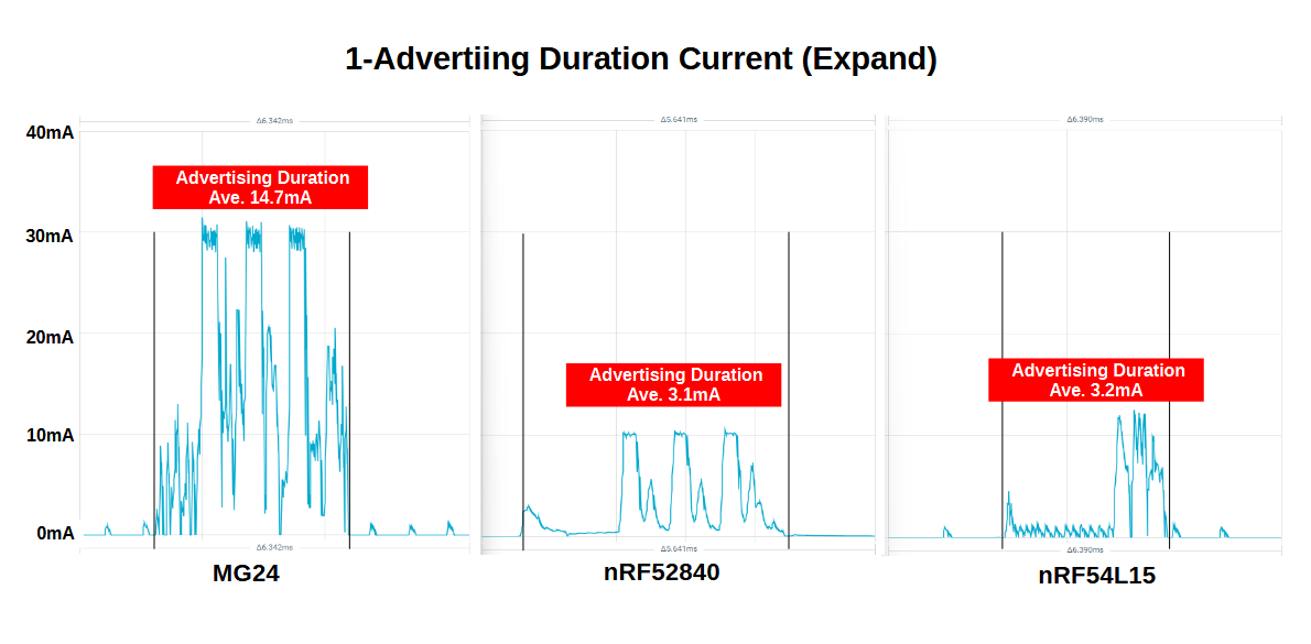

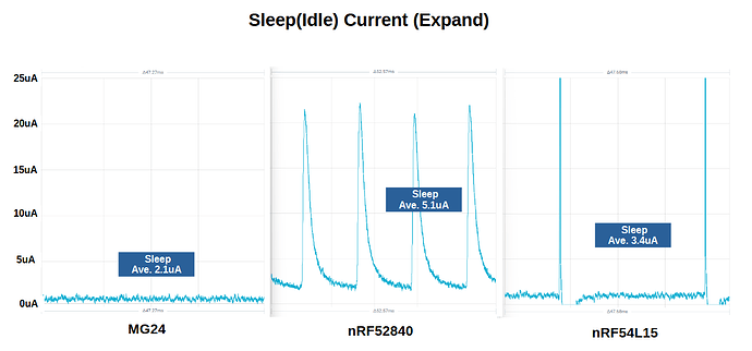

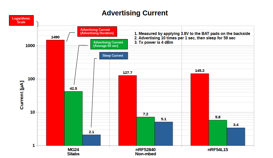

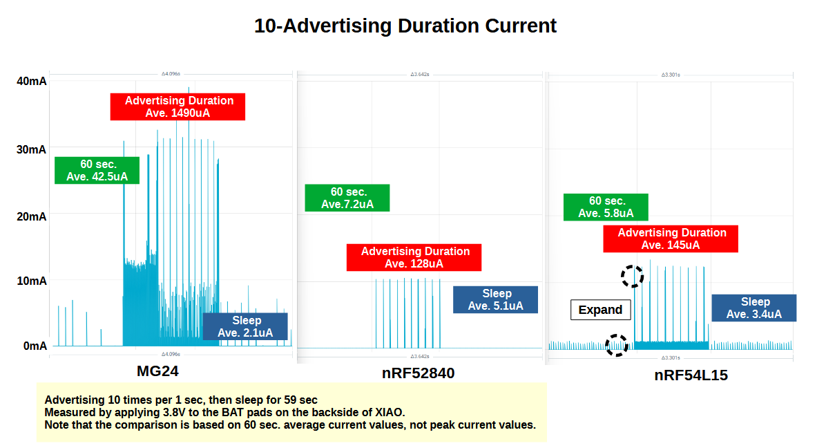

This report compares the average current consumption of my project using a sequence where it advertises 10 times per second and then sleeps for 59 seconds. Since it does not connect, it sends the same data 10 times to increase reception reliability. Furthermore, assuming short-range operation, the transmission power was set to 4dBm.
Only the Arduino IDE, available Board Support Package, and Seeed-provided board definitions for VsCode+PlatformIO were used. Dedicated chip IDEs or low-power coprocessors were not considered.
The current waveforms during advertising and sleep modes, along with a consumption current comparison graph, are shown. Within the limited scope of my project’s assumptions, the conclusions are:
  1. For simple BLE applications, the nRF54L15 cannot be said to be overwhelmingly superior to the nRF52840.
  2. While the MG24 has a larger transmit pulse current, its sleep current is extremely low. Therefore, it may be advantageous over the nRF52840 and nRF54L15 for applications where the transmission frequency exceeds 15 minutes.
    I hope this proves helpful to those interested.
    The code used for the experiments is attached.

Thanks for the information. I am surprised to see the NRF is higher current in sleep? I’m not surprised at the MG24 transmit current - are you not using the full 19.5dBm? I get around 150mA for that… Useful for a device that is a few hundred meters from my nearest router.
My application uses short-range wireless communication that does not require wired connections, so the transmit power is 4dBm.
