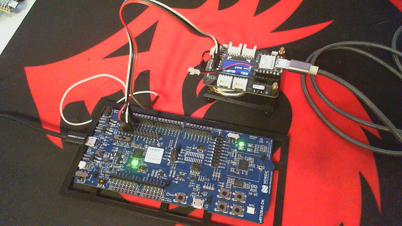

you only need 4 Wires BTW, so fix that.
Also You may need to connect under reset if your JLink isn’t official?
What unit is that?

Start there, can you establish a connection to it? , check your wiring, compare it to what I used on the RAL JLink and connect it the same, I think your mixing too many things together, Stay with the JLink get it working first ,then try different flash methods.
Fix the wires first.
You can Halt, Step, READ registers, Reset the MCU once you get it working , you can do EVERYTHING in Jlink.
