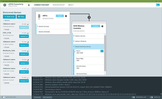

utilizing an XAIO nRF52840 Ble for my sim racing steering wheel buttons. Having an issue with rapidly pulsing signals when I press a button. Any help with will be appreciated, have already soldered capacitors across the switches with no success
And Welcome here…
So after you look around and like and read a few posts you can make your own thread on the subject. The Jist of it has been discussed here though before so have a look at the search for the BLE stuff, what is the setup ? Can you describe it more?
How is it powered , USB ? battery ?
Has it always had this or from a change or edit made , cause it ?
add a pis to you post maybe also, and if you post the code , use the code tags above “</>” paste it in there. :+1:
Lots of smart folks here willing to help.
It is powered by a single 18250 cell, I am using a 4 switch cluster mimicking a d-pad, 4 switches for buttons A,B,X,and Y. A 5th switch for my horn button and a joystick for camera control. It has had the button bounce issue all along and have added the Bounce2 library as well. Already bald, so cant pull my hair out

So , it’s not rogaine :man_bald: but , GPIOTE (GPIO Tasks and Events) The classic RTOS in the way I’m thinking , here is what I know others have run up against and one fellow even used the combo of BLE wireless mouse and HID lib’s
to get it done in the end.
AI agrees,
If you are getting a rapid torrent of pulses when pressing a button on the XIAO nRF52840, you are looking at classic hardware switch bounce being amplified by how the underlying RTOS or hardware handles interrupts.
Since adding standard capacitors didn’t tame it, the issue is almost certainly because the software is reacting to microsecond-level transitions that are too fast for simple RC filtering or standard software debouncers like Bounce2 to cleanly absorb when high-priority interrupts are involved.
Here is exactly what is happening under the hood and how to fix it:
1. The RTOS Culprit: Port Event vs. IN Event
If you are running an RTOS framework (like Zephyr OS or the Arduino nRF52 mbed core), it configures the nRF52840’s GPIOTE (GPIO Tasks and Events) peripheral in one of two ways. This makes a massive difference:
  • PORT DETECT (Low Power Mode): Zephyr defaults to using the shared PORT event sense mechanism (SENSE field in the PIN_CNF register) for normal GPIO callbacks. This is a level-sensitive interrupt. If a button bounces rapidly, it sets off a cascading storm of interrupts that can completely choke the RTOS context switching mechanism, causing a burst of weird, rapid pulsing output events.
  • IN EVENT (High Accuracy Mode): If the framework or a library spins up a dedicated GPIOTE->EVENTS_IN[x] channel, it uses an edge-triggered hardware latch. This mode is blindingly fast and will catch every single microscopic glitch of a physical button switch—far faster than an Arduino loop can handle it.
2. Why Bounce2 or Capacitors Are Failing
  • The RTOS Thread Latency: Libraries like Bounce2 rely on synchronous polling inside your main execution loop (bounce.update()). If the RTOS context-switching or Bluetooth (BLE) high-priority interrupts are busy maintaining the radio connection link for your steering wheel, your loop execution will stall slightly. The button bounces long before the loop gets around to reading the line again, allowing intermediate spikes to sneak through or go undetected until it is too late.
  • Capacitor Discharge Current: Simply soldering a cap across the switch without an inline resistor creates an instant, high-current discharge path when the switch closes. This can actually generate more electrical noise on the line, tricking the highly sensitive nRF52840 input buffers into seeing rapid high/low transitions.
I will look for what info I have on this , it has been flushed out pretty well AFAIK :+1:

Thank you, I have included my code as well. This is after removing Bounce2 and installing AceButton. Removed all capacitors and resistors. Still the same rapid fire pulses.
So , the C&P had some issues…
I ran it through the Wash-machine… :grin:
Give this one a go.
