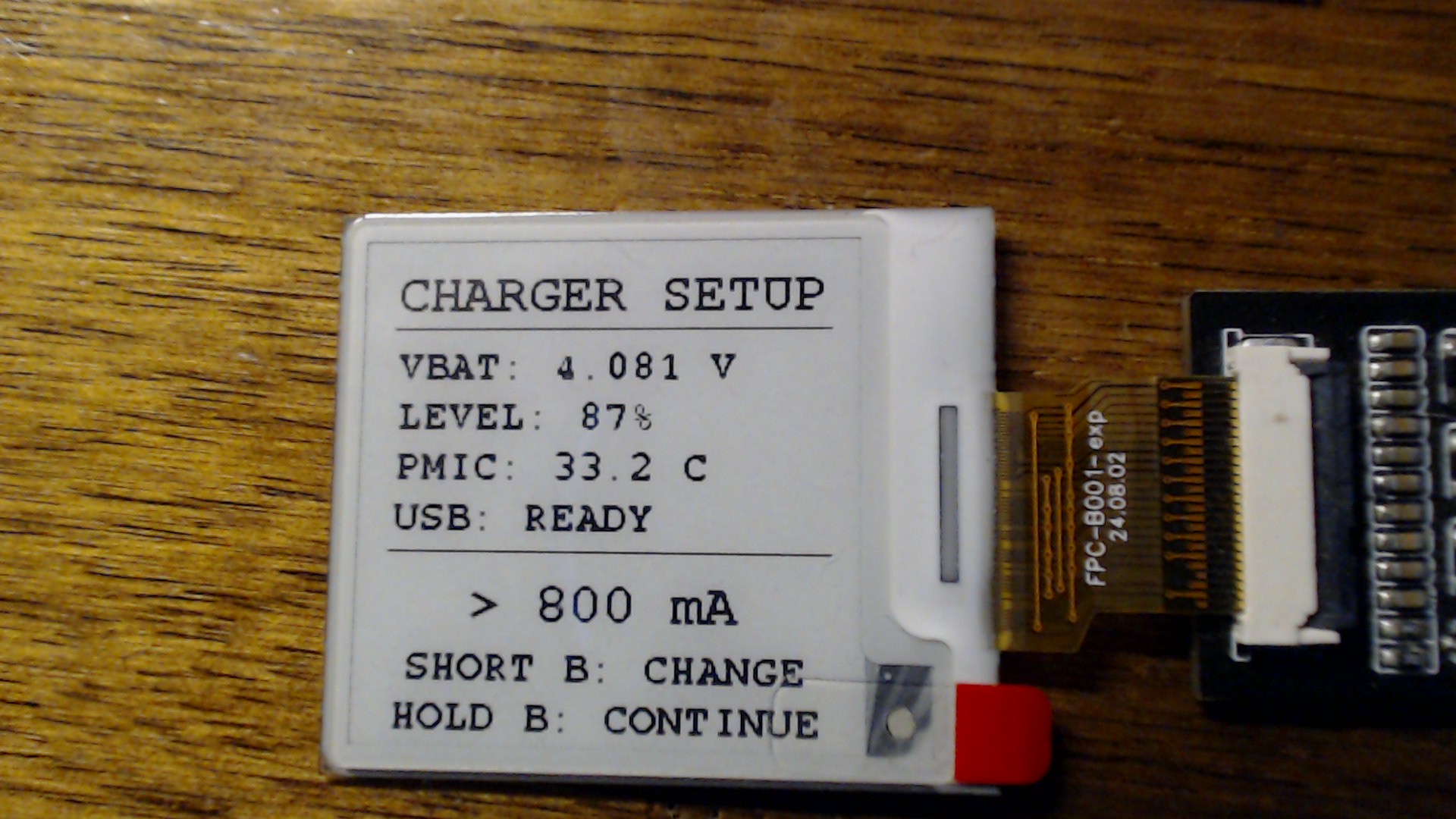

Check this OUT!

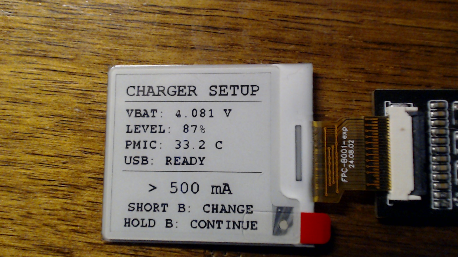

Selectable with the (b) button , 200/500/800 ma.
Still working out the screen formats, but it works like a champ.
here is the screens , video & code forth coming :+1:

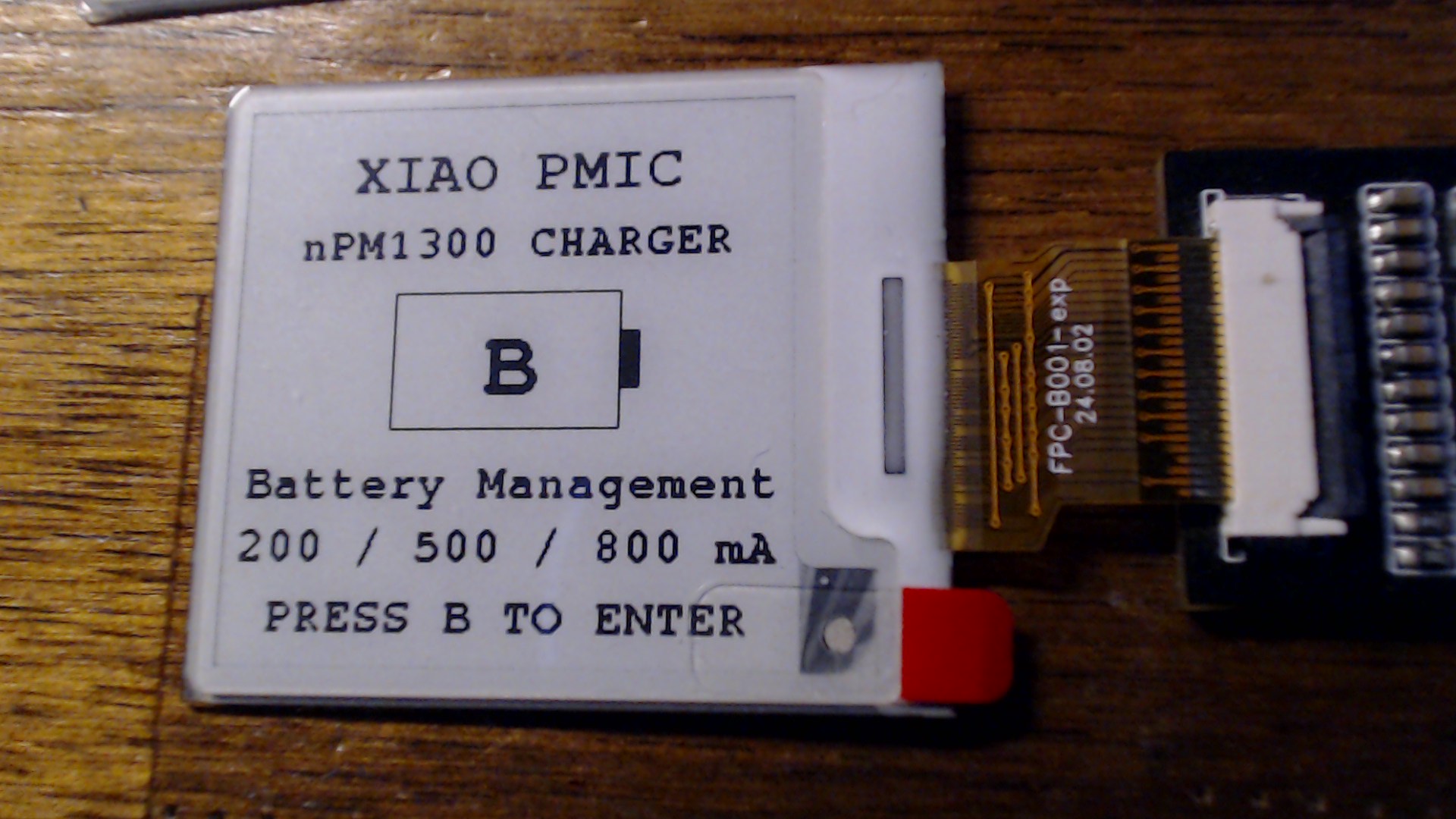

The Most Amazing XIAO to DATE!

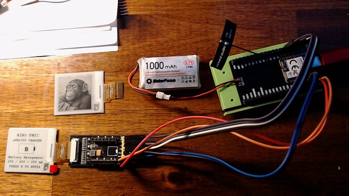

XIAO nRF54LM20A + nPM1300 Fast Charger Demo
I wrapped up a standalone battery charger demo for the Seeed XIAO nRF54LM20A using the onboard Nordic nPM1300 PMIC and the 1.54" 200×200 e-paper display.
This project is intended as both a PMIC demonstration and a reference for anyone wanting to build battery-powered devices with the XIAO platform.

  • Native nPM1300 charger control
  • Selectable charge currents
    • 200 mA
    • 500 mA
    • 800 mA
  • One-button user interface
  • Battery voltage monitoring
  • Estimated State-of-Charge
  • Charge current monitoring
  • PMIC temperature monitoring
  • USB input detection
  • Session statistics
  • Estimated charge time remaining
  • RGB status indication throughout the charging cycle
  • Low-power e-paper interface
The UI is designed around a single USER button, making it easy to operate without any external controls.

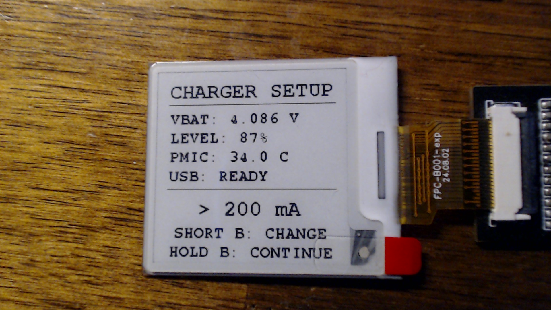

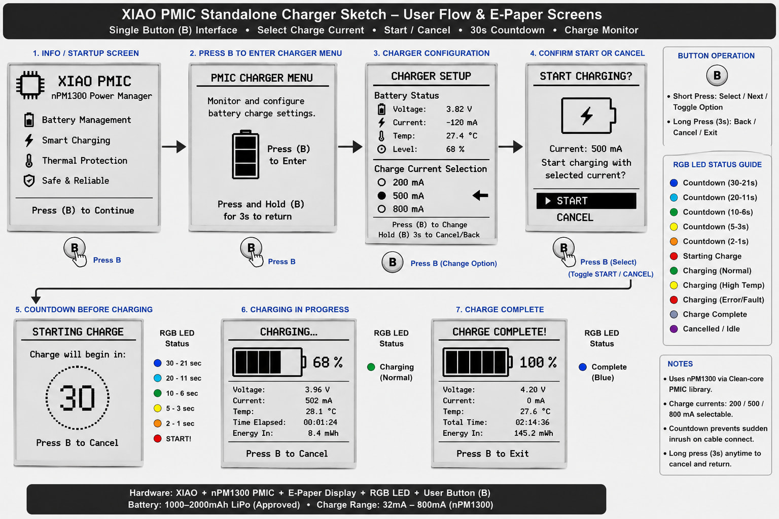

User Flow
  • Fire Horse splash screen
  • Charger setup

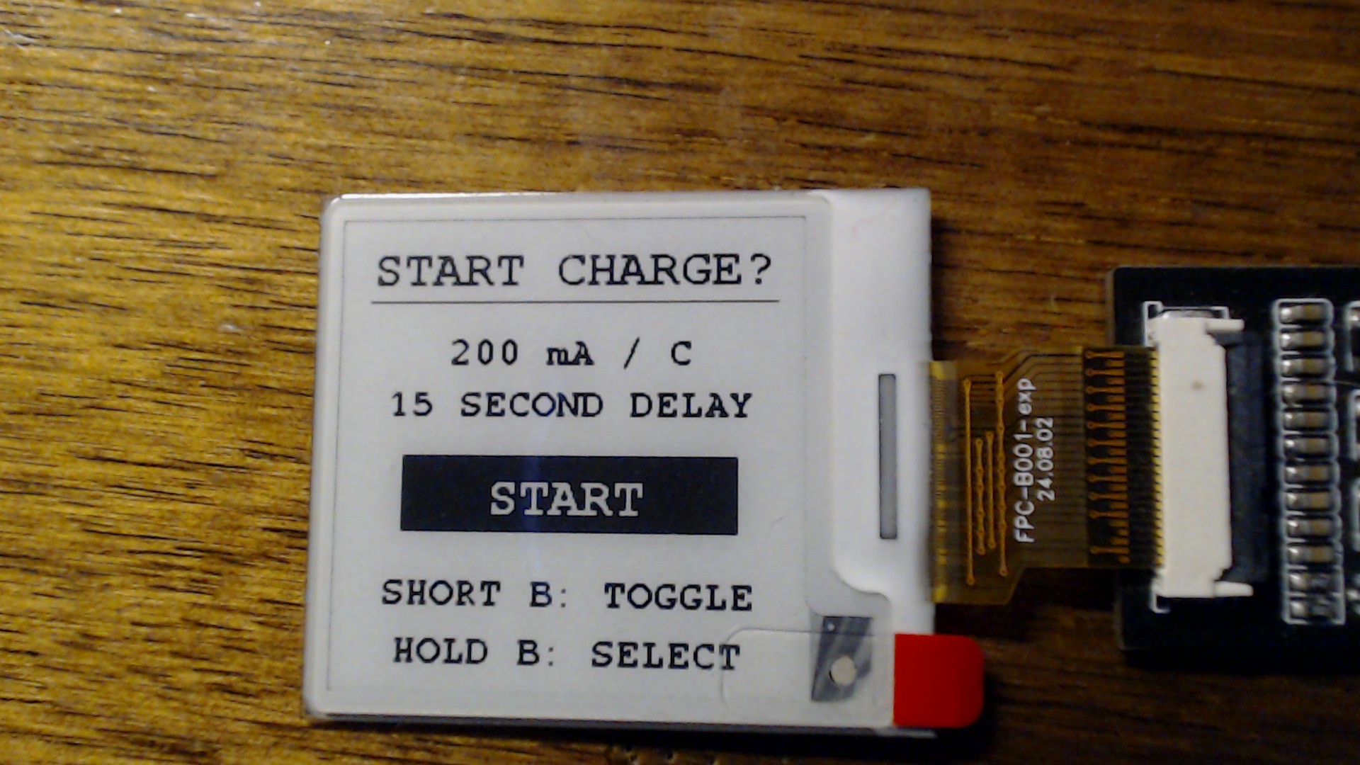

  • Select desired charge current

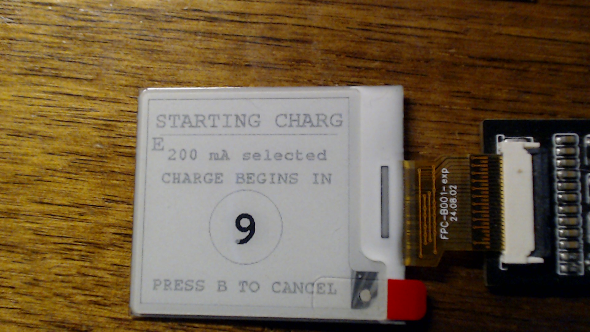

  • Start / Cancel
  • 15-second safety countdown
  • Live charging dashboard
  • Statistics pages
  • Fire Horse “sleep” screen on completion or cancel

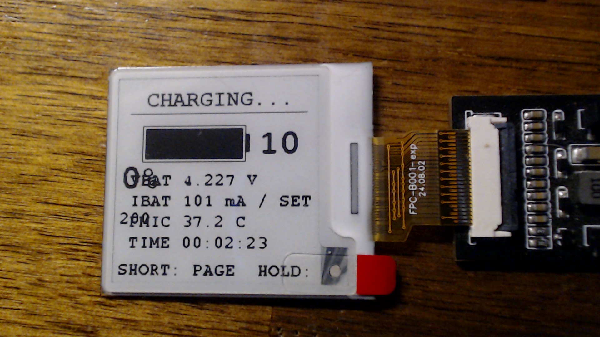

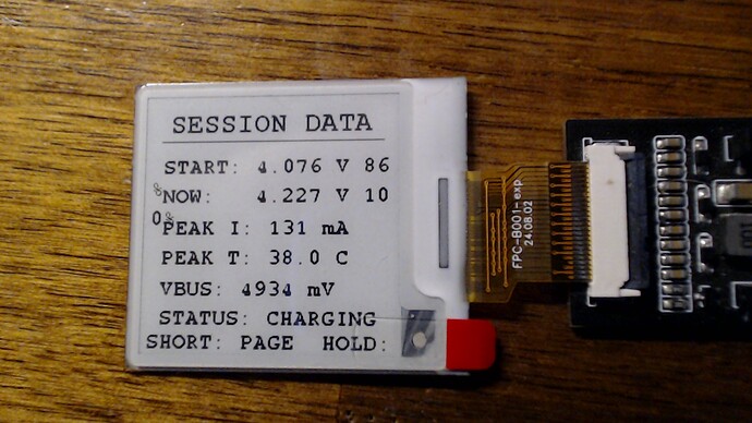

The charging dashboard provides live information including:
  • Battery voltage
  • Battery current
  • PMIC temperature
  • Charge time
  • Battery percentage
  • Peak current
  • Peak temperature
  • USB voltage
The countdown and live displays use partial e-paper refreshes to minimize flashing while keeping updates responsive.

  • Seeed XIAO nRF54LM20A
  • Onboard Nordic nPM1300 PMIC
  • 1.54" SSD1681 (200×200) e-paper display
  • Single LiPo battery (tested with 1000–2000 mAh cells)

Here is the serial output …
=== CHARGE STATUS ===
Set: 200 mA
VBAT: 4227 mV
IBAT: 42 mA
PMIC temp: 33245 mC
Session SOC: 94%
Added: 0.21 mAh
_Update_Full : 1294663
Set: 200 mA
VBAT: 4227 mV
IBAT: 42 mA
PMIC temp: 33245 mC
Session SOC: 94%
Added: 0.41 mAh
Set: 200 mA
VBAT: 4227 mV
IBAT: 41 mA
PMIC temp: 33245 mC
Session SOC: 94%
Added: 0.60 mAh
Set: 200 mA
VBAT: 4227 mV
IBAT: 37 mA
PMIC temp: 34830 mC
Session SOC: 94%
Added: 6.23 mAh
_Update_Full : 1294661
_Update_Full : 1294662
Set: 200 mA
VBAT: 4227 mV
IBAT: 37 mA
PMIC temp: 34037 mC
Session SOC: 94%
Added: 6.70 mAh

So, Here is a diagram of the flow on the Battery code.
