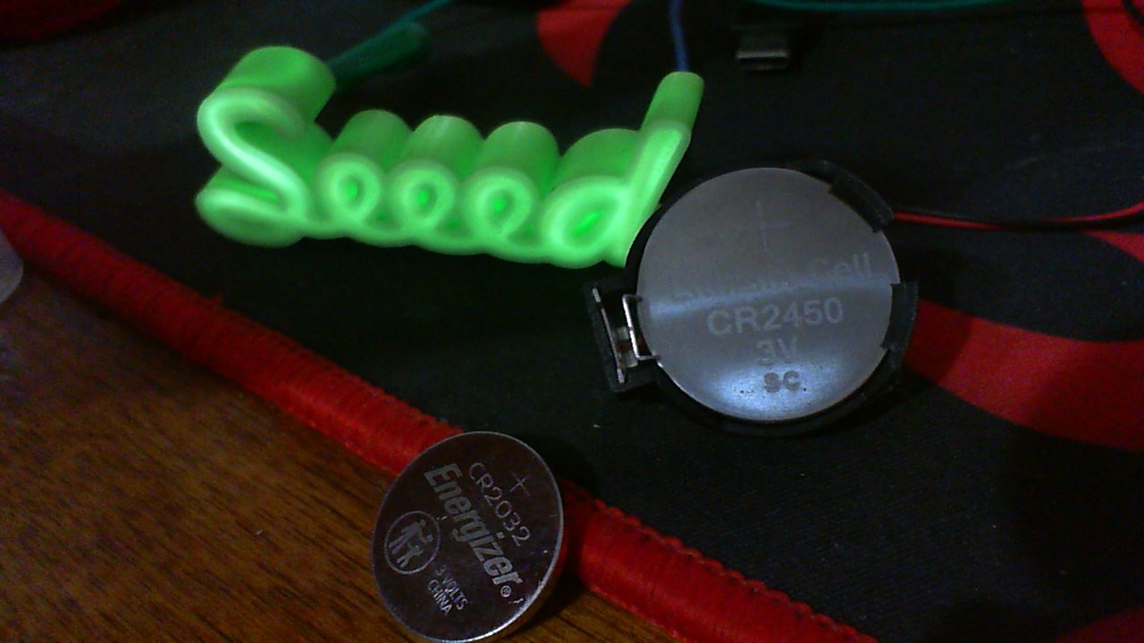

SO keep in mind this is the Silicon Package itself, the Xiao design envelope may add additional overhead, which we all know it does.
either through restrictions or requirements :see_no_evil:
to me the takeaway is the 225 mAh, I like the slightly thicker but more robust CR2450 Approximately 550 to 620 mAh, depending on the brand. (11 years) :exploding_head:

this one on the left…
worth noting also,
  • Limiting factors: A coin cell’s own maximum storage time (typically 4–5 years for a CR2032) is often a limiting factor, as the battery may stop working before it is fully discharged in ultra-low-power applications.
