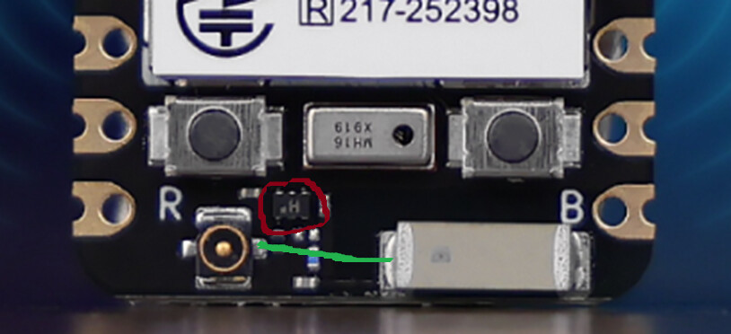

There is somethng you should know about XIAO nRF54L15, it has a 5G radio switch (FM8625H) on the board with a quiscent current of about 100uA. So whatever you can achieve in nRF54L15 Soc you have to add 100uA to it. Or you can switch it on and off to save some battery. Unfotunately the documentation for FM8625H is pretty thin and I haven’t had the chance to test it yet.

@nomad – thanks for the clarification about the RF switch (FM8625H).
If I understand correctly, using the external antenna (which is recommended for better range) means the RF switch must be powered, and that adds around 100 µA of constant consumption.
Is this the same situation on the XIAO MG24, since it uses a similar RF switch?
And is there any clean workaround, such as:
  • desoldering the switch and manually routing the external antenna, or
  • removing the internal antenna and soldering the external antenna directly?
    I’m not sure whether this is realistic or if it breaks the RF chain.

The switch is started by default (see platform-seeedboards/zephyr/boards/arm/xiao_nrf54l15
/xiao_nrf54l15_nrf54l15_cpuapp.dts) on this line
rfsw_pwr: rfsw-pwr {
compatible = “regulator-fixed”;
regulator-name = “rfsw-pwr”;
enable-gpios = <&gpio2 3 GPIO_ACTIVE_HIGH>;
regulator-boot-on;
so you could do some switching on and off but there is a trick. Matter/Thread sends some sync frames “during standby“ independent of your control. I’m currently testing this behaviour. (EDITED: IT’S NOT WORKING by turning switch on and off ).
You could also remove FM8625H but have you seen how tiny it is (1.1mm x 0.7mm) ? From where i’m standing i’m having doubts about making a solder bridge after removig it.

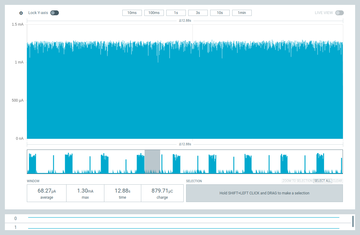

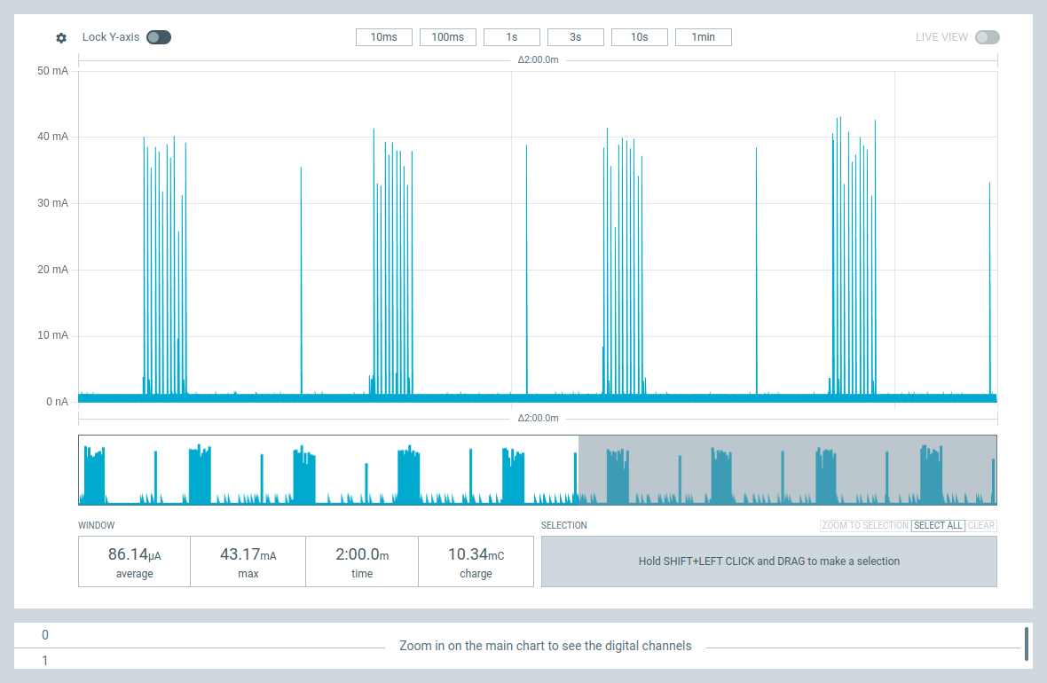

I’m currently running a BME280 sensor connected to a Nrf52840 Dongle with 30 sec sensor read interval (active sleep with unused ram turned off) and it needs 18 uA. If if push the read interval to 60 sec it needs only 10 - 11 uA.
Here are the current diagrams (PPK2) for a Matter over Thread sensor based on XIAO nRF54L15 and BME280.
The sampling rate is 0,5 Hz (2 / sec), Voltage 3,7 V. BME sensor takes about 6 - 7 uA.
Without power regulator and RF switch it can go down to about 12 uA and even better with a higher or variable sampling rate.
