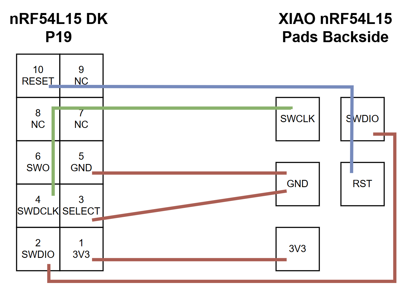

Could you give me a short overview how exactly you connected the nRF54L15-DK to the XIAO?
I followed the documentation of the DK, therefore connected P19 of the DK to the pads 3V3, GND, RST, SWDIO and SWCLK on the XIAO. GND and SWDO_SELECT from the DK are tied to GND on the XIAO (as described in the DK guide). I supply the XIAO via USB-C. The connections look like this:

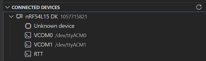

Now I would like to use RTT using the VSCode Extension (I am working on WSL). Under “Connected Devices”, my XIAO is listed as “Unknown Device” and I can’t flash it using JLink and cannot use RTT. The connections between the DK and the XIAO are quite short, I would say around an inch.
If you have done anything differently than me please let me know. Note that in the image above, P19 is arranged exactly like the physical pin header on the DK.

You can verify your setup and connections by using the JLink or the Programmer, but beware what has ports open when you power on. You can’t hurt ANYTHING so don’t be afraid to try different configs. YOLO :grin: :+1:

I will try that. I saw in the video that you have four connections from the DK to the XIAO board, as shown above I currently have five. Could you tell me what connections you have and if I should remove one?
Thank you!
After some trial and error, I am finally able to see the RTT output of the booting process. Thank you so much for your inputs, greatly appreciated!! Cheers!
