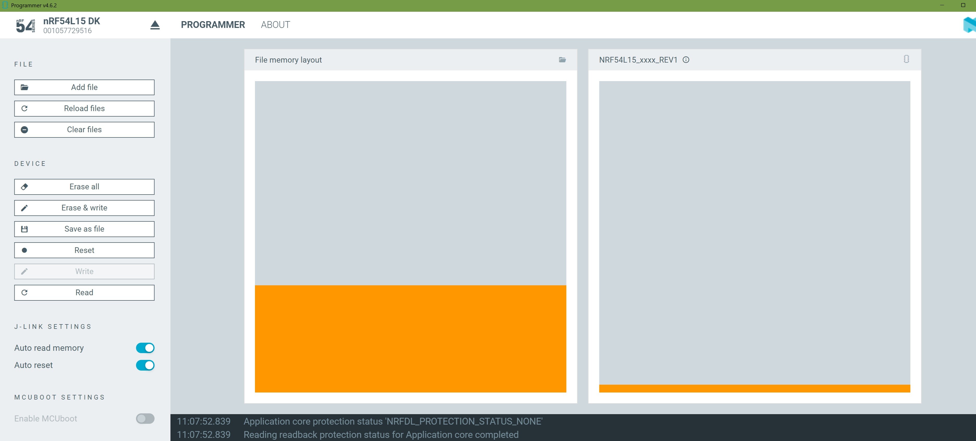

Jlink , connect and erase , Then Loadfile with known good HEX no issues after that TECH. all other methods read and write it after.
here is a programmer read after the recovery, READ…
File on left , Xiao on the Right.
I’m wondering if the OpenOCD doesn’t do a complete erase or better a correct sector erase before it rewrites, which BTW is how it normally does it, not a full erase. This may be why if We full erase outside of it(whatever version) it works again, but the OpenOcd fails… food for thought.

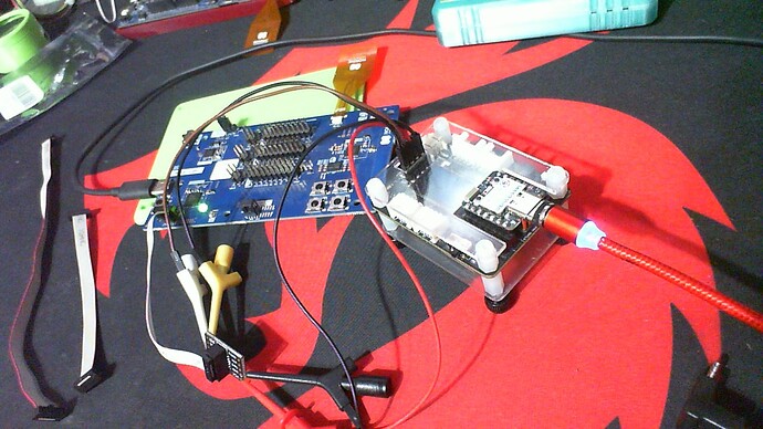

here is a text from a Bad GPIO , interrupt mis configured… had to JLink it back. (i’ll post a video of the process I used)
Crash log output, no touch INT hooked..

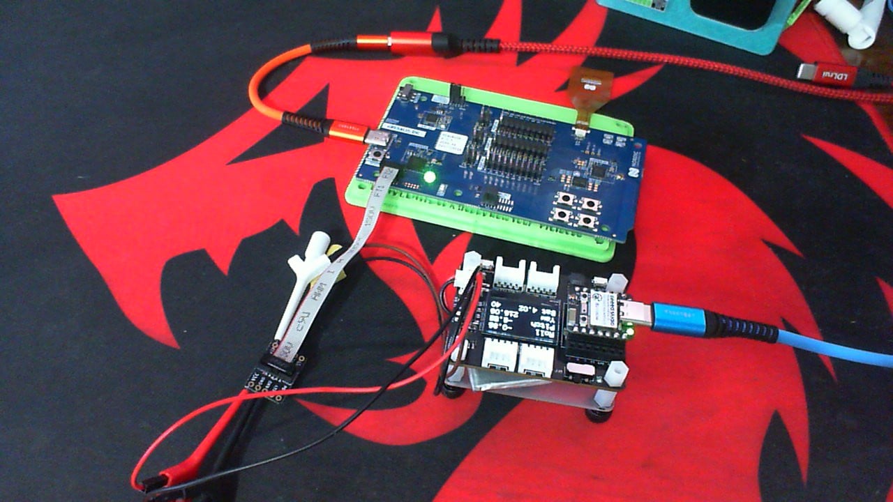

Once they are Jlinked back , I use @msfujino’s IMU test “zephyr.hex” for the Sense version because I get Visual display and IMU test in one
(video forthcoming )
for the BLE only I use the WatchFace.hex (rolo) because the Flasher’s used all provide a reset the result it instant…or pretty close, so you know if it works or not.
If the connections are not solid and reliable the SWD is sketchy and requires several retries until it pops. But with shorter cables it works repeatable every time.
