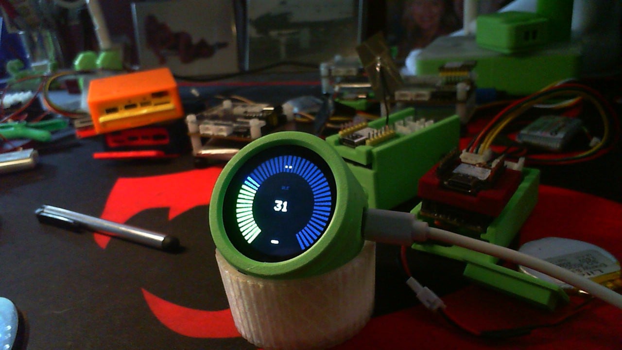

Here is the TouchRing Video Demo and code for you to compile yourself.
The TouchRing Meter Demo showcases an elegant and responsive user interface on the Seeed Studio 1.28" Round Display powered by the GC9A01 driver. Featuring a 240×240 pixel TFT panel and capacitive touch input via the CST816S controller (I2C).
This code project creates an interactive analog-style ring meter that responds to Touch and up/down swipe gestures. The visual interface includes a color-coded arc scale (green to red), a central numeric value display, and on-screen ‘+’ and ‘–’ indicators.
The demo unit is powered by the Seeed Studio Xiao ESP32-C6 or S3 and uses the TFT_eSPI and lv_xiao_round_screen libraries for high-performance graphics and touch handling.
Users can drag their finger to adjust a value between 0 and 99, with immediate visual feedback. The layout is optimized for the round form factor, making it an ideal base for control knobs, gauges, or user input widgets. This standalone version is clean, smooth, and PHAT—perfect for embedded UI prototypes or hardware demos.
AMA
