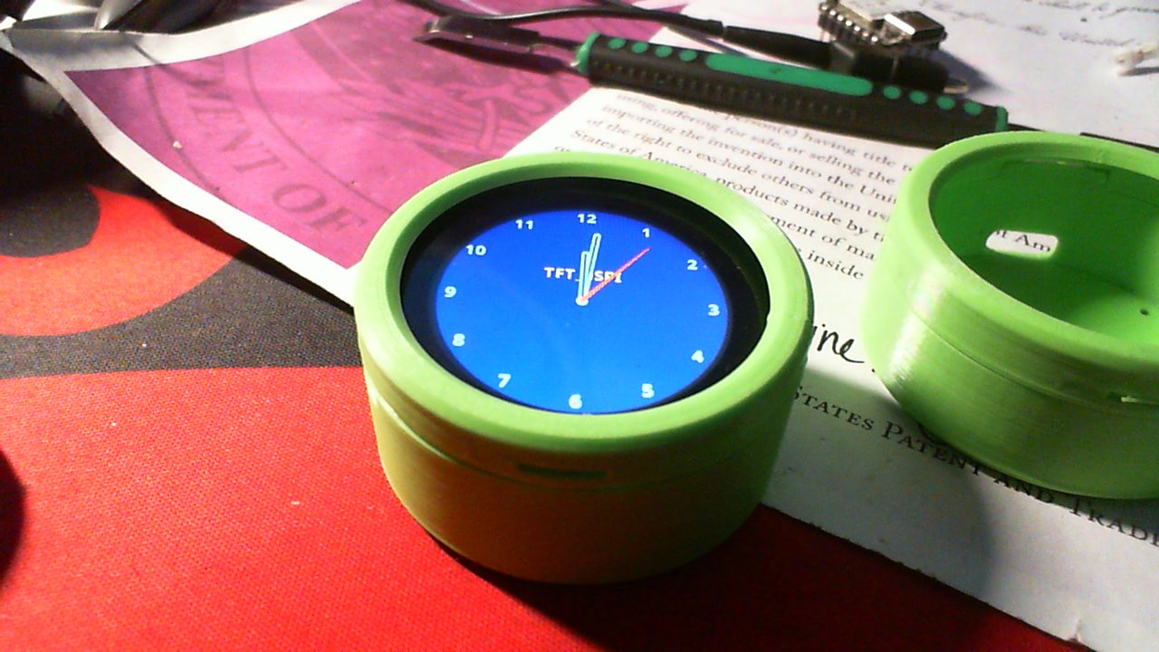

🧐 Round Display w/TouchRing BLE Xiao C6 & S3-Plus
TouchRing_BLE_S3 (Master)
In this demonstration,
I begin by powering on the TouchRing_BLE_S3 Peripheral—based on the Seeed Studio Xiao ESP32S3-Plus with a 1.28" round GC9A01 display and CST816S touch controller.
The startup screen briefly shows the MCU model and firmware revision, followed by the animated Touch Ring Meter interface with BLE advertising active. I launch nRF Connect for Desktop and scan for devices. The Peripheral appears as “TouchRingBLE” with a strong signal.
After connecting, we see the custom 128-bit BLE service with two characteristics: one for notifications and another for writable commands. Tapping on the Notify characteristic activates real-time updates from the device—each touch gesture changes the meter’s value and sends it over BLE, appearing instantly in the nRF Connect log.
When we write a new value (e.g., ‘36 36’) into the writable RX characteristic, the Peripheral responds immediately—updating the ring meter display and printing the new value to the Serial Monitor. The BLE indicator on the device turns blue when connected, and red when disconnected. This confirms full bidirectional communication before pairing it with a Remote TouchRing device.
TouchRing_Re_C6 (slave)
After confirming the Peripheral is working, we now power on the TouchRing_RE_C6, running on the Seeed Studio Xiao ESP32C6 with the same 1.28" GC9A01 round display and CST816S touch. At boot, the display shows the familiar startup info screen, followed by the full-color animated ring meter UI. If the “TouchRingBLE” Peripheral is active, the Central scans, connects automatically, and reads the initial meter value, syncing it instantly. A blue “BLE” indicator confirms the live connection. From this point on, both devices stay synchronized — when we adjust the value on the S3 Peripheral, the RE_C6 reflects the change in real-time via BLE Notify. Likewise, adjusting the value on the RE_C6 via up/down touch gestures sends a Write command to the S3, updating its display and Serial log.
Tapping the center of the RE_C6 toggles BLE On or Off — when Off, the red BLE indicator appears, and both devices operate independently in standalone mode.
This dual-mode behavior demonstrates the flexibility of the system: interactive sync when connected, and smooth local control when not.
What follows is Skinny display version…
Introducing the Skinny TouchRing — all the features, none of the carbs. It’s lean, mean, BLE-synced machine. While the Phat sister’s flexin’ her curves, Skinny’s out here precision-tapping like a runway model with a master’s in microcontrollers. Slim screen, sharp skills — choose your fighter. :sunglasses::sparkles::calling:
Don’t let the skinny frame fool you — she’s got the same smart moves under the hood all the brains with half the bezel. The Slim TouchRing delivers full BLE swagger in a sleeker package. Whether you’re team “Phat Curve” or “Lean Queen,” this ring’s got range. :sunglasses::ring:
Note: I’ve included in the attached ZIP file for each the pre-compiled BIN file and .INO file so you can compile your own, or Use the Flash tool and write the Bin file directly to test your hardware. (don’t forget the address) :+1:
Touch_ring_BLE_S3.zip (605.7 KB)
TouchRing_RE_C6_BLE.zip (665.4 KB)
Skinney_C6_TouchRing_Re_BLE.zip (664.3 KB)
AS you were…

Hi PJ,
Amazing! I am assuming you designed and printed the green round case?
Regards,
John

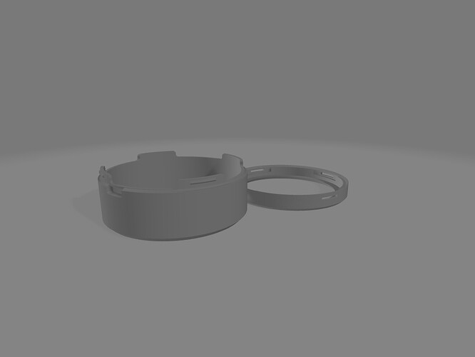

Thanks, No it’s available on the wiki AFAIK. I did stretch it in the Z to accommodate the round battery. :grin:
From this Thread
I added the STL to Zip , if you want to print your own. :crossed_fingers:
Round-Display-shell-3D-Model.zip (2.2 MB)
