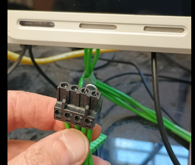

The TX & RX pins are looped back to each other as follows:-
The issue is when I output a string in one shell and read it back in another, there is some strange end-of-buffer issue where I get unlimited spurious characters at the end.
