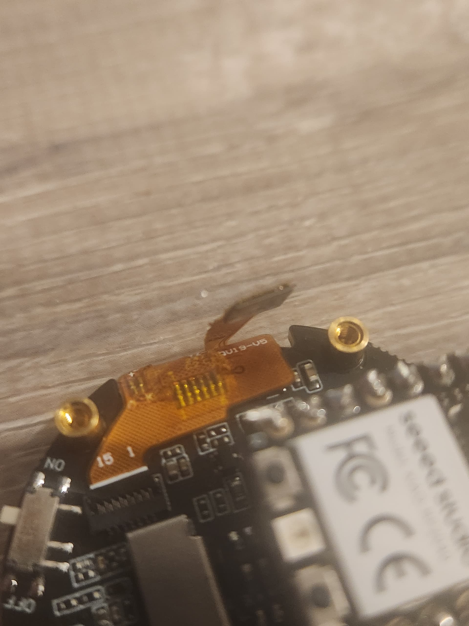

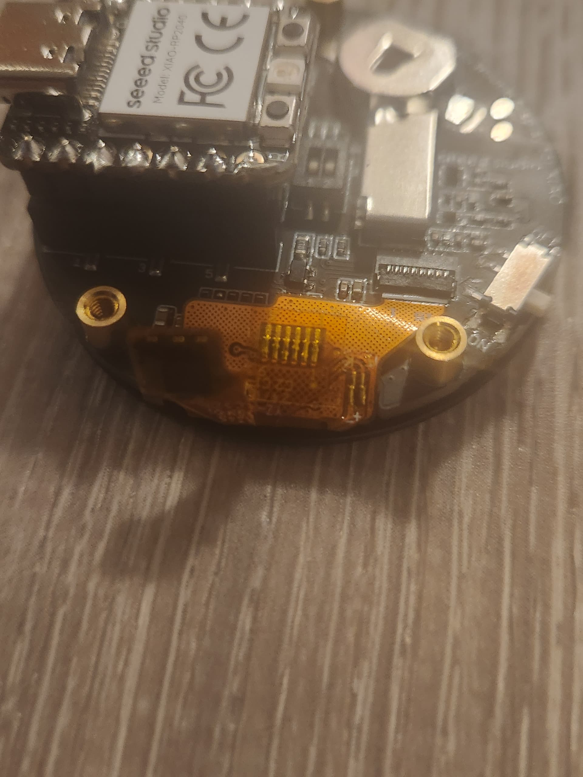

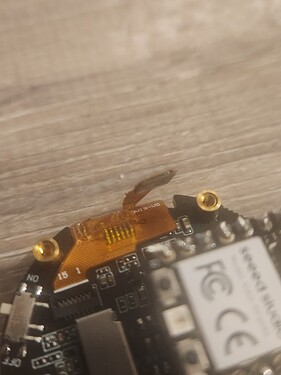

quick question, my display came like this.
is it broken?
it wouldn’t let me post images so here are some links to them.
remove the spaces
shrimpliquid.github. io/20250709_183703.jpg
shrimpliquid.github. io/20250709_183711.jpg
And welcome here,
Allow me, and NO… the glue just seperated… Should be good to go,
that’s the touchscreen chip, it’s normally got a piece of glue tape holding it down, shipping and heat these days maybe? Should work though, here is , what MuY looks , like today. hard to see the thin tape over it all , but its there. :+1:
well, that isn’t good, seeing as my display isn’t working.
