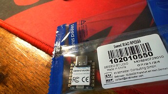

I have one of those (pic) so I will give it a whirl time permitting.
