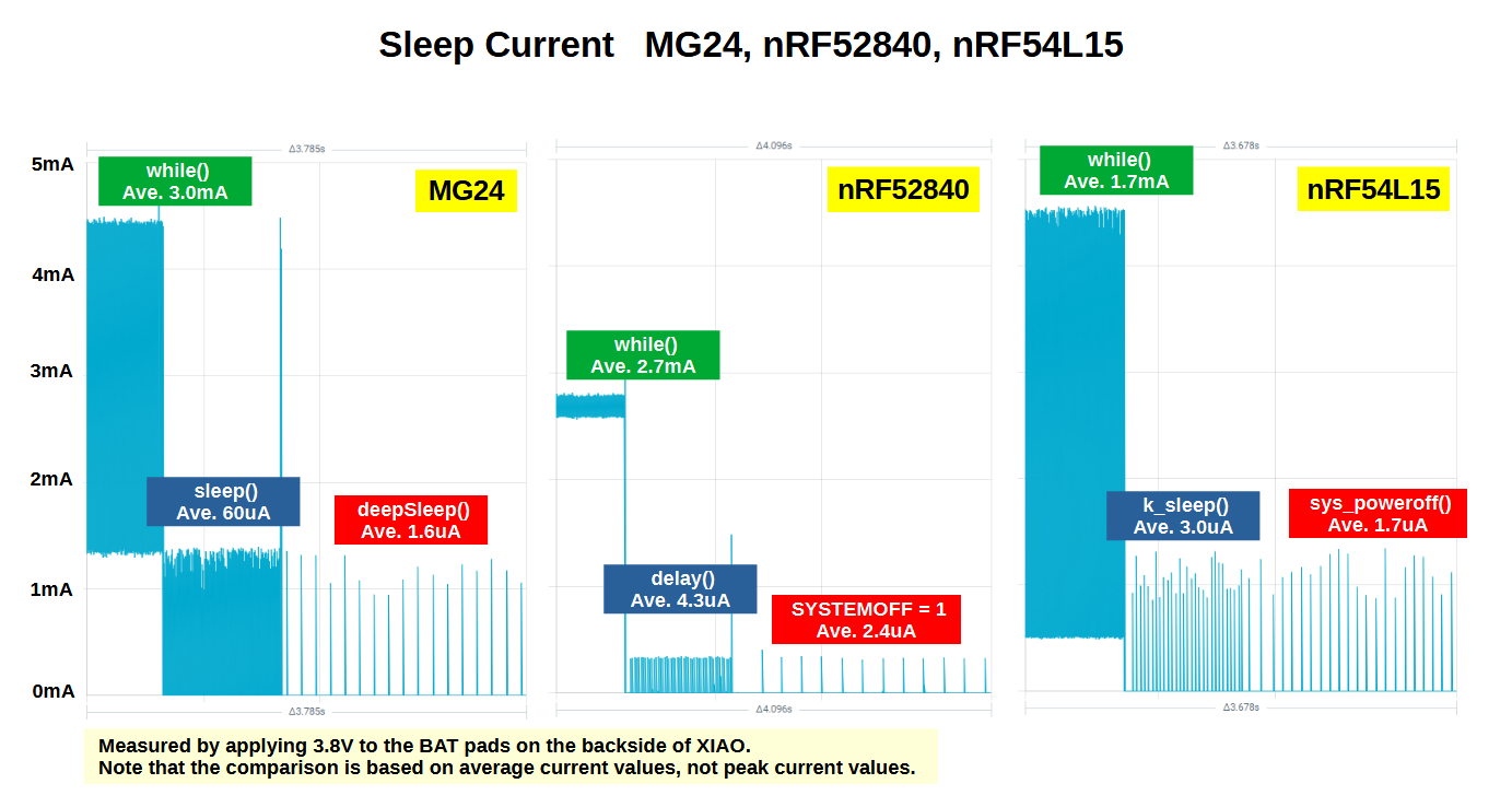

I compared the sleep current of the newly released nRF54L15 with the nRF52840 and MG24, known for their low power consumption. I hope this proves useful.
Measurements were taken using ppk2 while applying 3.8V to the battery pads on the device’s back. Since sleep current is highly sensitive to temperature, room temperature was maintained as close to 25°C as possible.
For the BSP, I used “Seeed nRF52 Boards 1.1.10” for the nRF52840 and “Silicon Labs 3.0.0” for the MG24, working within the capabilities of the Arduino IDE. The nRF54L15 was worked on in a VsCode + PlatformIO environment. No tricky operations were performed to lower the current values.
Comparison results:
  1. Deep sleep current is sufficiently low at around 2uA, showing no significant difference.
  2. Light sleep(idle) current is significantly worse for MG24 at 60uA.
  3. As an example of operating current, I compared the current during execution of while(mills()-timestamp);. The nRF54L15 shows significantly lower current consumption.
Overall, the nRF54L15 appears to be the most power-efficient device.
Results may vary depending on device-specific tuning. Please share any additional information you have.
The code used for the experiment is attached below.

So I feel like some PLUG is needed here, and so much more to be discovered. If seeed would take full advantage more could be gained.
Also Some of the users having issues may not be aware of the Power domains and turning things on when needed, I’m just starting to Scratch the silicon surface :grin:
Thank you for the efforts and enlightenment :bowing_man:

When discussing XIAO’s sleep current, the current consumption of onboard devices other than the MPU must be considered. The most dominant factor is the SBD leakage current, which exhibits significant variation and is temperature-sensitive.
[typ. uA]              nRF54L15   nRF52840      MG24
MPU            I_sleep   0.6       0.4          0.25
SBD            Ir         5       Unknown         5
3.3V Reg       Iq        0.3         1           0.3
LevelShifter   IccA       2          -            -
Measured Value Ioff      1.7       2.4           1.6

Interesting discovery :thinking:
So, with BLE, Zigbee, Matter support out of the box, a stable development and complete environment (including Micropython), the EFR32MG24 is looking to be quite a “favourable” option? (Yes, in Australia and other Commonwealth countries, there is a “u” in “favourable” :smiley: )
The MG24 has excellent sleep current values, comparable to the nRF, but its operating current consumption when the radio is active seems less favorable. I suspect the transmit stage amplifier design is fundamentally different.

I apologize for not starting a new thread for this, but as a new member evidently, I cannot. Using a XAIO nrf54L15 and the Seeed low power example, I cannot get below 5ma as measured by the PPK2. It doesn’t matter if I power via the Vbus , Vbat or 3.3V pin. Anyone have any idea why I am not coming in at the few ua values everyone else seems to get? I built the example using Nordic SDK version 3.3.2 using the board files supplied in the platform-seedboards tree.
keck9939,
Have you tried the project attached to Post #1?
What I tried was very similar, but not identical. I ran the example in post 1 and am getting 5ma where the comment indicates it should be 1.7ma, 2.3ma where the comment says 3ua and 230ua where the comment says 1.7ua. I’ve ordered a nRF54L15DK board for testing and I’ll order another XIAO nRF54L15 on the assumption that something is wrong with the one I’ve got.
Nothing is connected to the XIAO_nRF54L15 except for the ppk2, right?
The only thing connected is the PPK2. It turns out, if I connect to Vbat at 3.8 volts, as specified in Post 1, I actually get pretty much what the comments say. I was originally connected to 3.3v at 3.3v.
