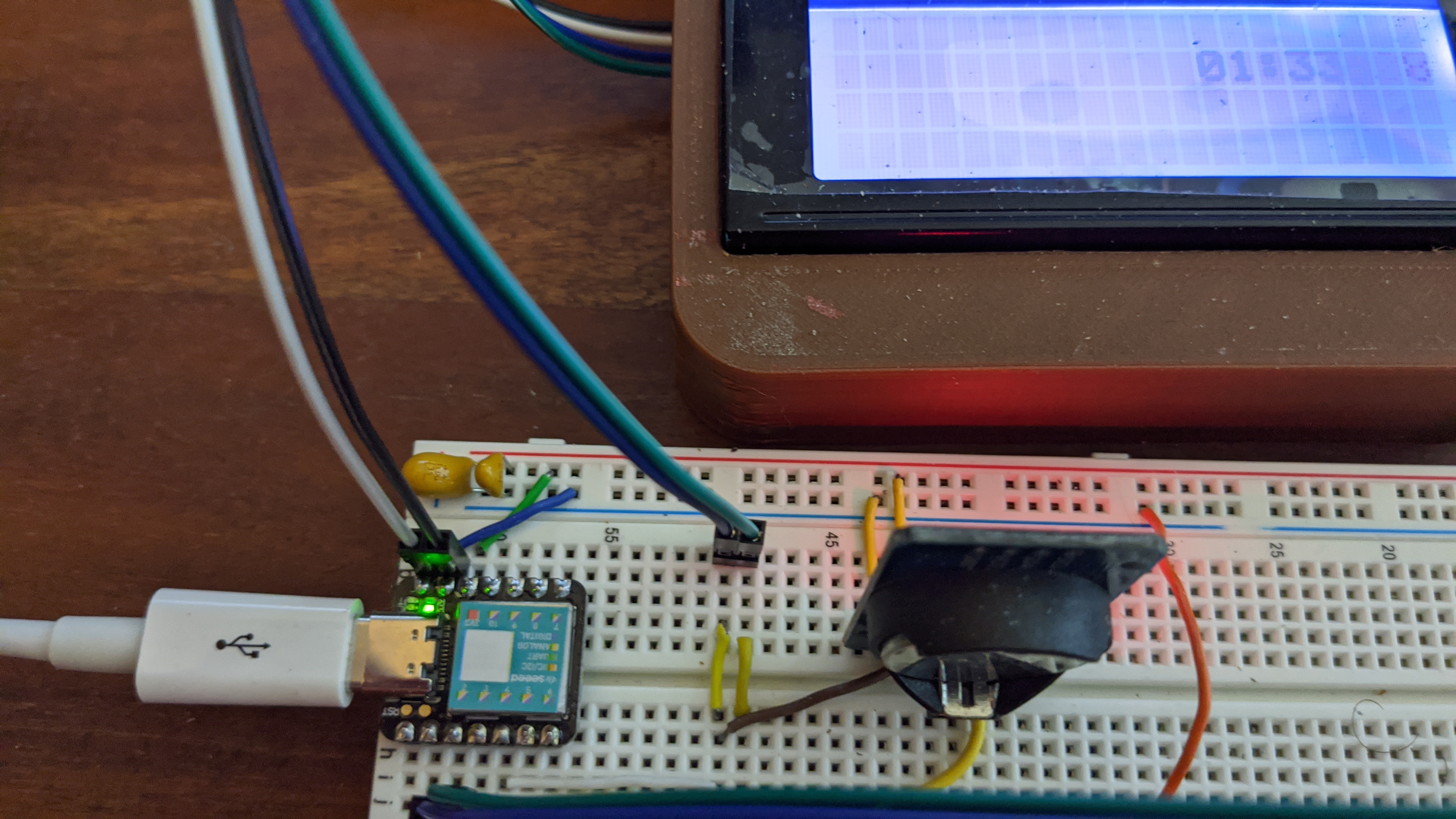

I have 10 uF tantalum and 0.1 uF thin film capacitors on the 3.3V pin and using that output to power an I2C 20x4 LCD display and RTC (DS 3231) dev board with no issues whatsoever.
