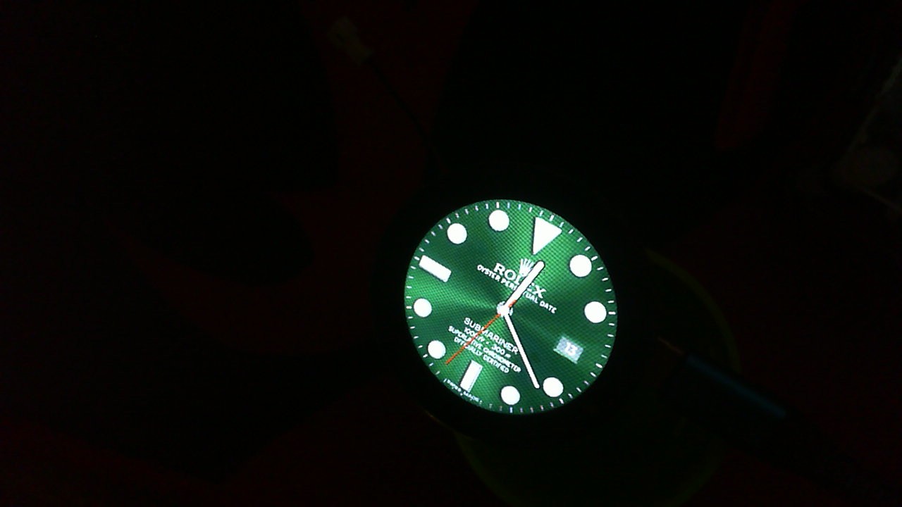

and just to show the potential, his amazing ROLO clone :smiley: Code HERE
