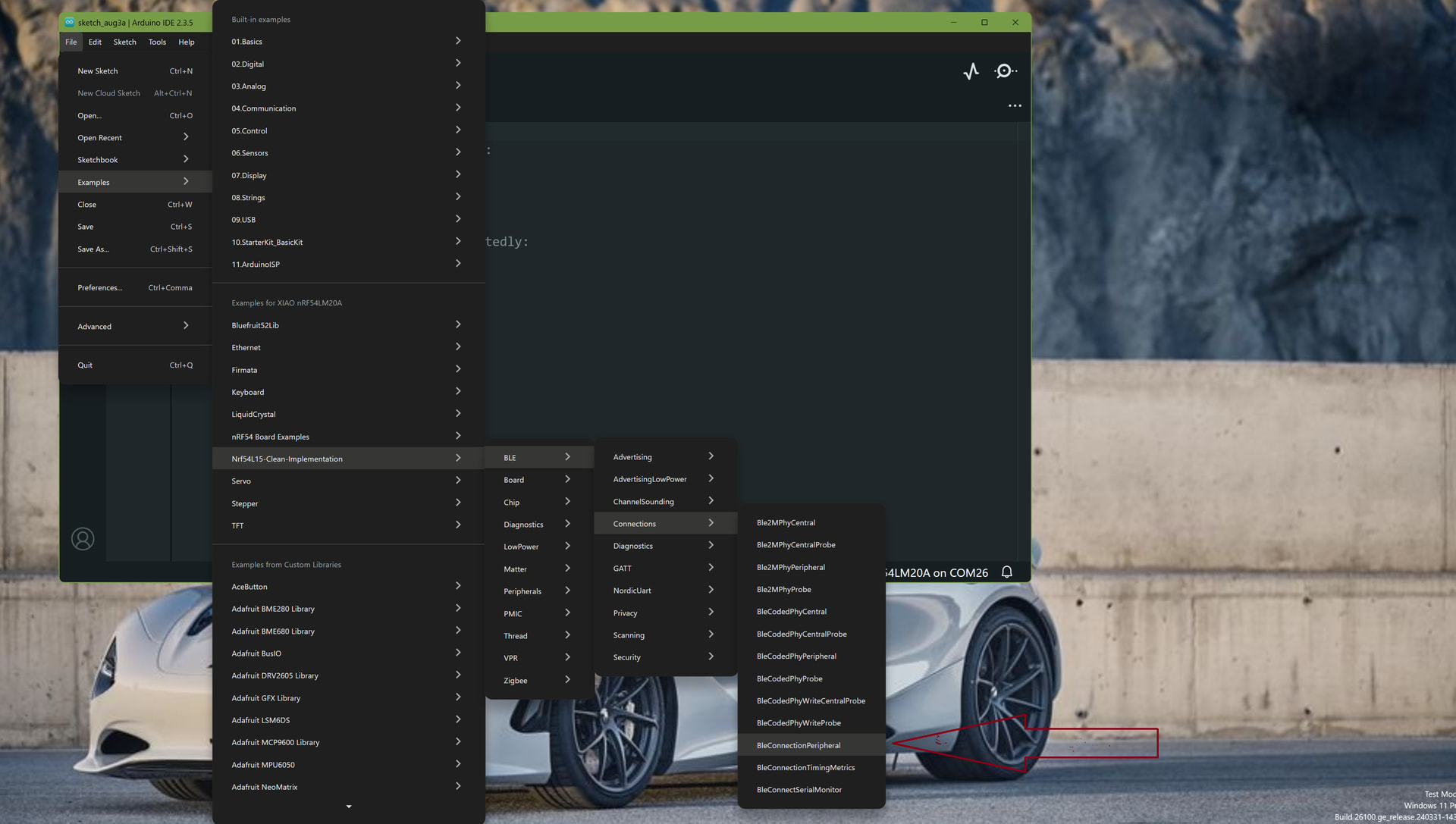

So I would say “YES” , I tried it basically this way…
Opened Examples with Xiao nRF54LM20A selected..

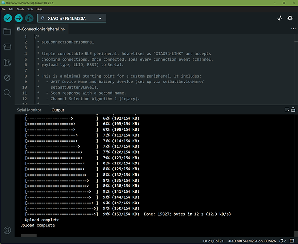

Hit Upload…
It compiled and Did so…

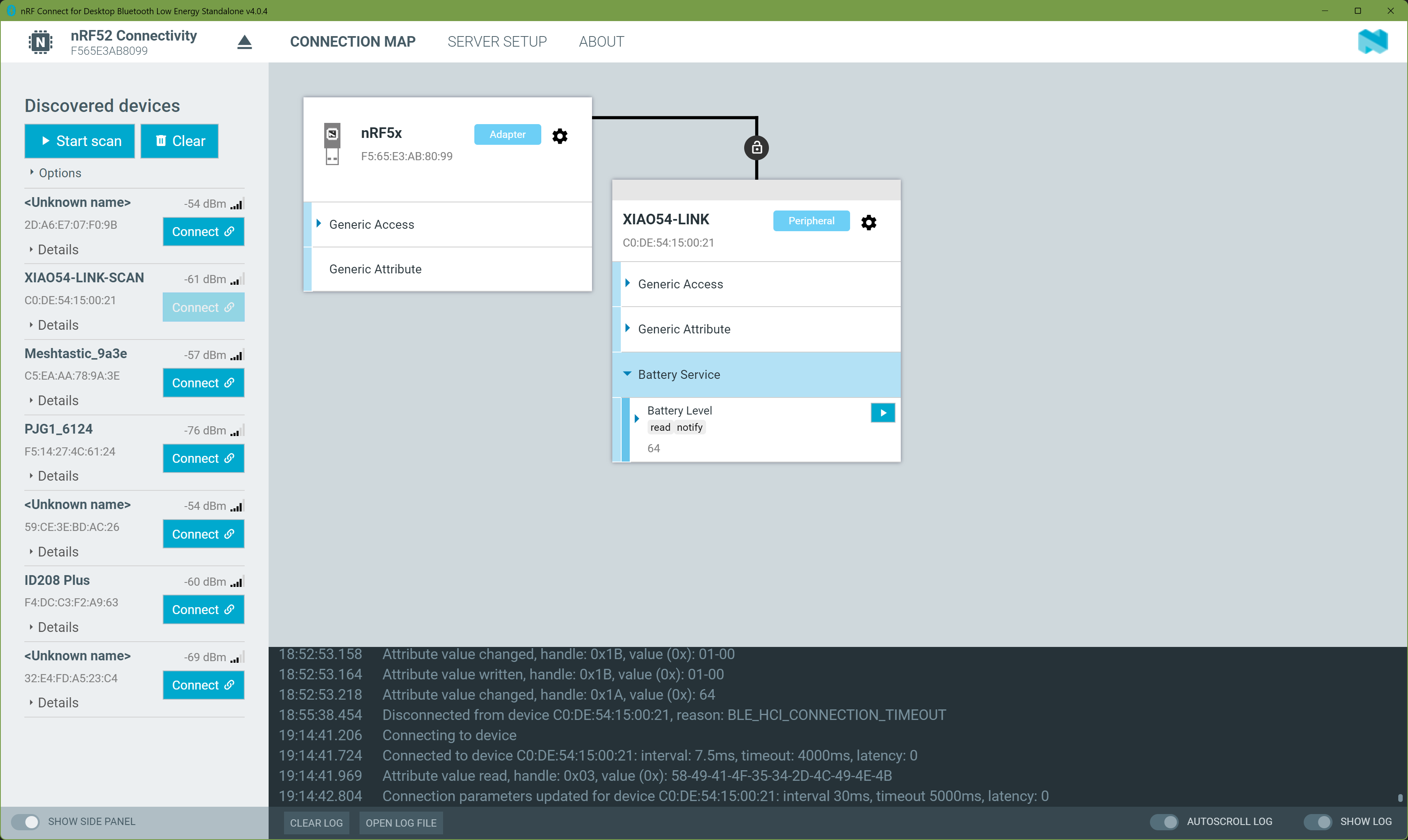

Then I opened the BLE App scanner showed it right away,
Selected it , connected FAST Battery Service works AOK, Updates in Realtime when you turn on the notify.
