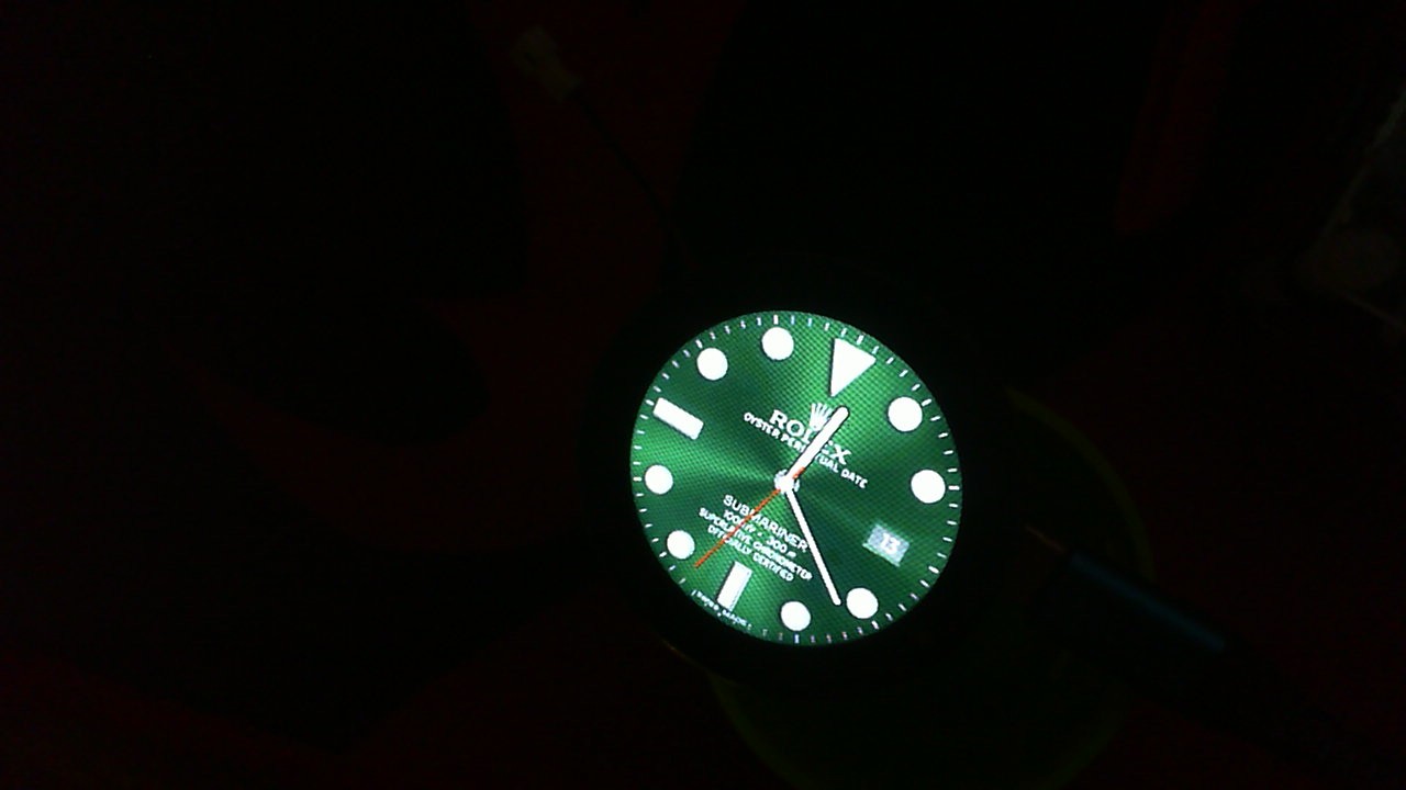

🧐 Xiao nRF54L15 with Round Display... mind the KE switch!

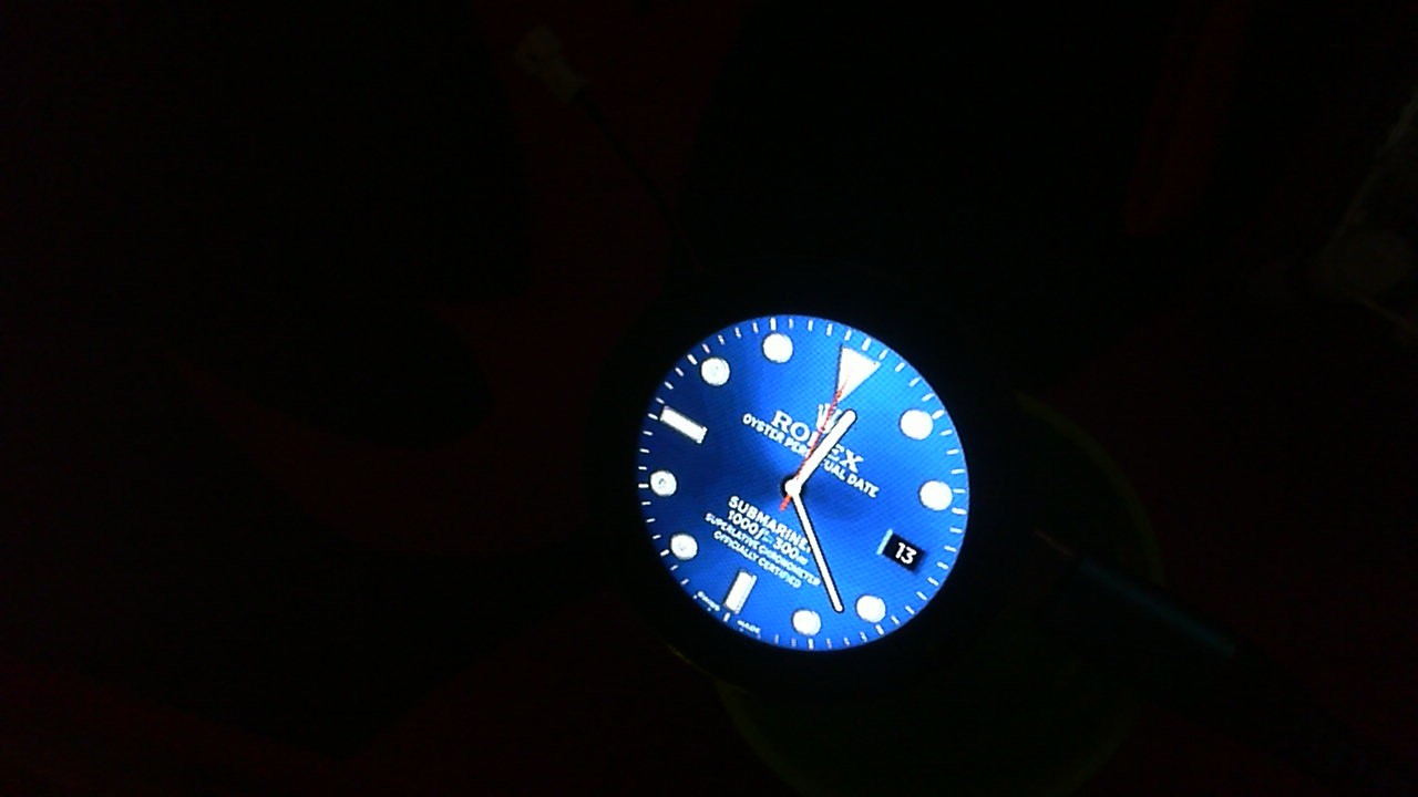

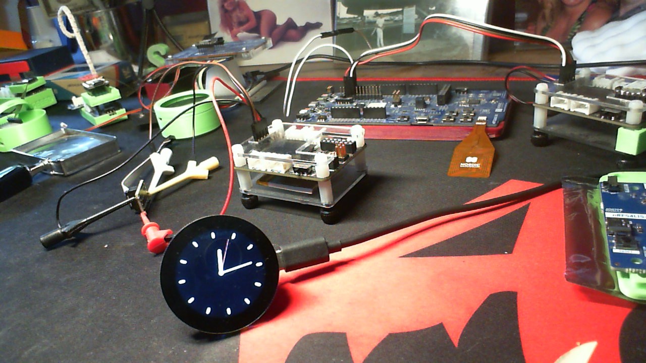

So Yea, It’s a GO with the round display , build on 3.1.1
LVGL example…
NO MCUBOOT ,just does it work test, filmed on a Potato :potato: :film_projector:
SO watch face time… Let’s start there. :grin:
I have enclosed the project folder, You know what to do. :+1:

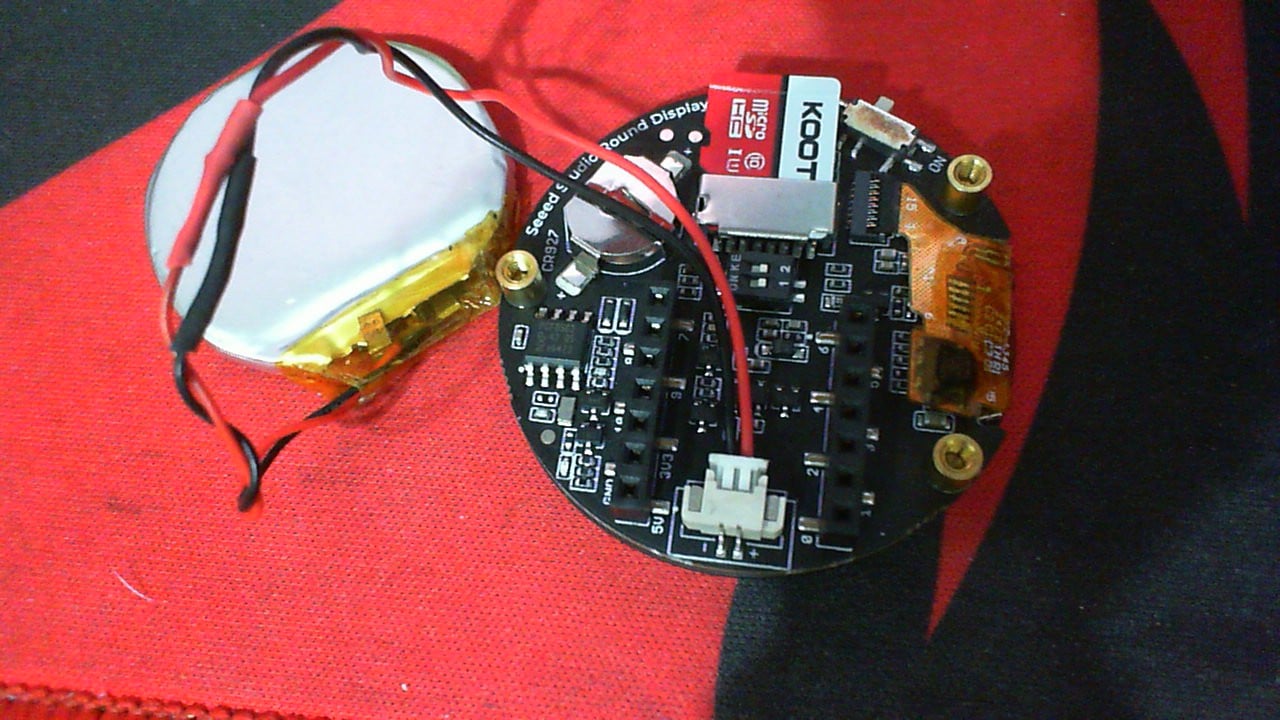

I see you have the SDcard in there, did you get that working with the 54l?
Never mind, I got it working there’s a working SD card sample for the xiao nrf54l15 in the xiao expansion base now.

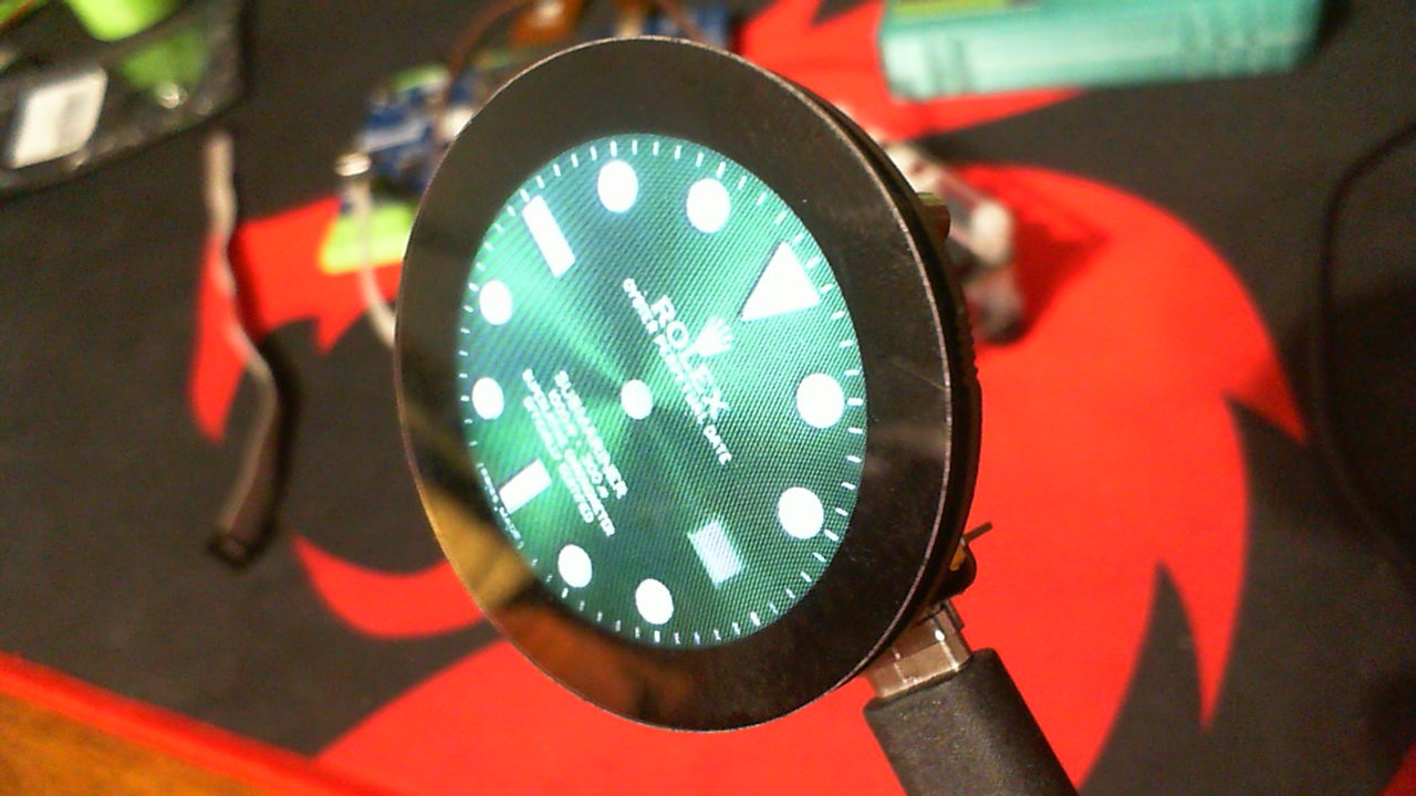

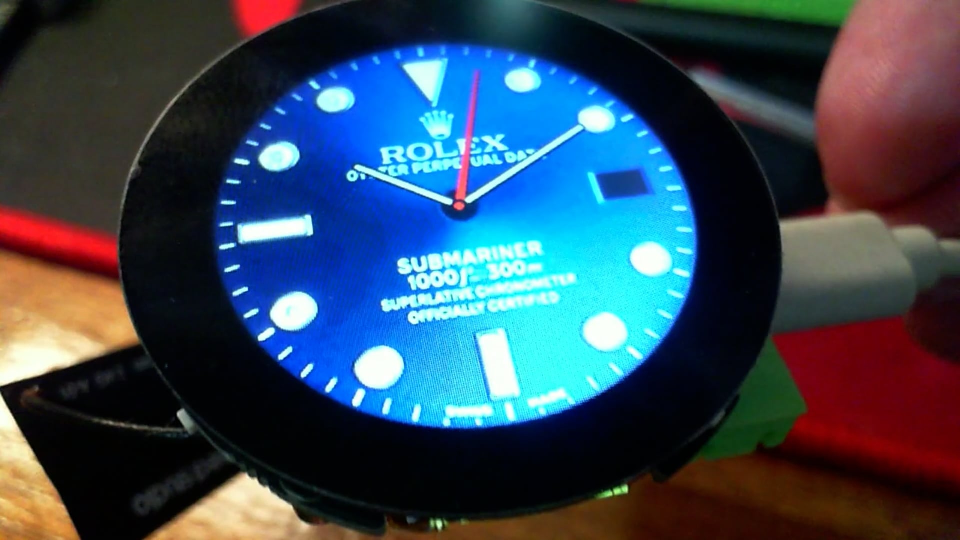

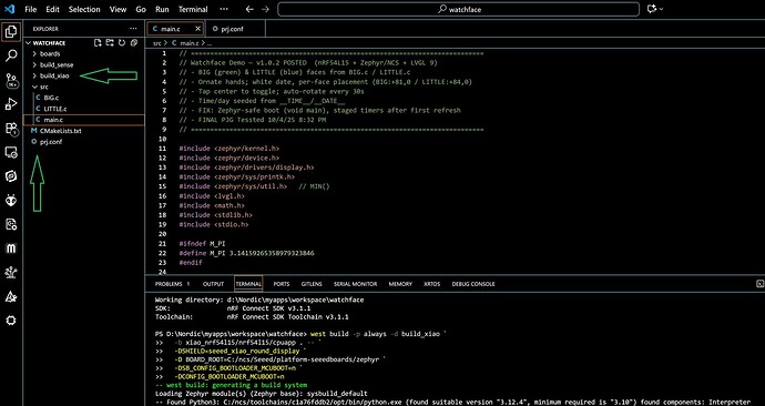

So here is the basic 2 Face Rolo Watch faces switch between the two, just a basic demo with code. Images are HQ jpegs converted to c arrays then to .h files, put them in the SRC directory if you want to use your own, also any 240x240 will work with the round display.
The Hands and date letters are generated and the positions mapped out. I will demonstrate the basic Nrf_sdk/West flow changing the position and building and flashing.

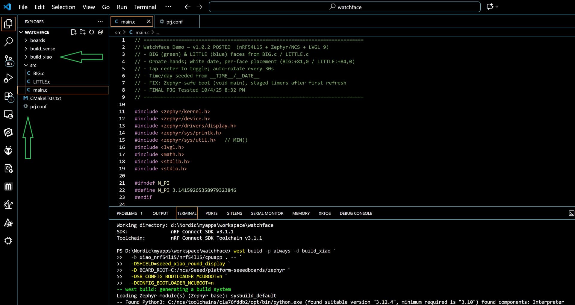

I like to use a target named build directory to keep things good. You should too. :v:
I had to turn the brightness down to see the whole square and the white font on the green face, You can change them to whatever you like.
Everything will be in the ZIP file.
Here is the whole log of the process:
Working directory: d:\Nordic\myapps\workspace\watchface
SDK:               nRF Connect SDK v3.1.1
Toolchain:         nRF Connect SDK Toolchain v3.1.1
PS D:\Nordic\myapps\workspace\watchface> west build -p always -d build_xiao `
>>   -b xiao_nrf54l15/nrf54l15/cpuapp . -- `
>>   -DSHIELD=seeed_xiao_round_display `
>>   -D BOARD_ROOT=C:/ncs/Seeed/platform-seeedboards/zephyr `
>>   -DSB_CONFIG_BOOTLOADER_MCUBOOT=n `
>>   -DCONFIG_BOOTLOADER_MCUBOOT=n
-- west build: generating a build system
Loading Zephyr module(s) (Zephyr base): sysbuild_default
-- Found Python3: C:/ncs/toolchains/c1a76fddb2/opt/bin/python.exe (found suitable version "3.12.4", minimum required is "3.10") found components: Interpreter
-- Cache files will be written to: C:/ncs/v3.1.1/zephyr/.cache
-- Found west (found suitable version "1.4.0", minimum required is "0.14.0")
-- Board: xiao_nrf54l15, qualifiers: nrf54l15/cpuapp
-- Shield(s): seeed_xiao_round_display
Parsing C:/ncs/v3.1.1/zephyr/share/sysbuild/Kconfig
Loaded configuration 'D:/Nordic/myapps/workspace/watchface/build_xiao/_sysbuild/empty.conf'
Merged configuration 'D:/Nordic/myapps/workspace/watchface/build_xiao/_sysbuild/empty.conf'
Merged configuration 'D:/Nordic/myapps/workspace/watchface/build_xiao/zephyr/misc/generated/extra_kconfig_options.conf'
Configuration saved to 'D:/Nordic/myapps/workspace/watchface/build_xiao/zephyr/.config'
Kconfig header saved to 'D:/Nordic/myapps/workspace/watchface/build_xiao/_sysbuild/autoconf.h'
   * Running CMake for watchface *
Loading Zephyr default modules (Zephyr base).
-- Application: D:/Nordic/myapps/workspace/watchface
-- CMake version: 3.21.0
-- Zephyr version: 4.1.99 (C:/ncs/v3.1.1/zephyr)
-- Found host-tools: zephyr 0.17.0 (C:/ncs/toolchains/c1a76fddb2/opt/zephyr-sdk)
-- Found toolchain: zephyr 0.17.0 (C:/ncs/toolchains/c1a76fddb2/opt/zephyr-sdk)
-- Found Dtc: C:/ncs/toolchains/c1a76fddb2/opt/bin/dtc.exe (found suitable version "1.4.7", minimum required is "1.4.6")
-- Found BOARD.dts: C:/ncs/Seeed/platform-seeedboards/zephyr/boards/arm/xiao_nrf54l15/xiao_nrf54l15_nrf54l15_cpuapp.dts
-- Found devicetree overlay: C:/ncs/v3.1.1/zephyr/boards/shields/seeed_xiao_round_display/seeed_xiao_round_display.overlay
-- Generated zephyr.dts: D:/Nordic/myapps/workspace/watchface/build_xiao/watchface/zephyr/zephyr.dts
-- Generated pickled edt: D:/Nordic/myapps/workspace/watchface/build_xiao/watchface/zephyr/edt.pickle
-- Generated devicetree_generated.h: D:/Nordic/myapps/workspace/watchface/build_xiao/watchface/zephyr/include/generated/zephyr/devicetree_generated.h
warning: Experimental symbol MIPI_DBI is enabled.
Parsing C:/ncs/v3.1.1/zephyr/Kconfig
Loaded configuration 'C:/ncs/Seeed/platform-seeedboards/zephyr/boards/arm/xiao_nrf54l15/xiao_nrf54l15_nrf54l15_cpuapp_defconfig'
Merged configuration 'D:/Nordic/myapps/workspace/watchface/prj.conf'
Merged configuration 'D:/Nordic/myapps/workspace/watchface/build_xiao/watchface/zephyr/misc/generated/extra_kconfig_options.conf'
Merged configuration 'D:/Nordic/myapps/workspace/watchface/build_xiao/watchface/zephyr/.config.sysbuild'
Configuration saved to 'D:/Nordic/myapps/workspace/watchface/build_xiao/watchface/zephyr/.config'
Kconfig header saved to 'D:/Nordic/myapps/workspace/watchface/build_xiao/watchface/zephyr/include/generated/zephyr/autoconf.h'
-- Found GnuLd: c:/ncs/toolchains/c1a76fddb2/opt/zephyr-sdk/arm-zephyr-eabi/arm-zephyr-eabi/bin/ld.bfd.exe (found version "2.38")
-- The C compiler identification is GNU 12.2.0
-- The CXX compiler identification is GNU 12.2.0
-- The ASM compiler identification is GNU
-- Found assembler: C:/ncs/toolchains/c1a76fddb2/opt/zephyr-sdk/arm-zephyr-eabi/bin/arm-zephyr-eabi-gcc.exe
=========== Generating psa_crypto_config ===============
Backup: CONFIG_MBEDTLS_PSA_CRYPTO_SPM: False
Backup: CONFIG_MBEDTLS_PSA_CRYPTO_C: True
Backup: CONFIG_MBEDTLS_PSA_CRYPTO_KEY_ID_ENCODES_OWNER: False
Backup: CONFIG_MBEDTLS_PLATFORM_SETUP_TEARDOWN_ALT: False
Backup: CONFIG_MBEDTLS_THREADING_C: True
Backup: CONFIG_MBEDTLS_THREADING_ALT: True
=========== Checkpoint: backup ===============
Restore: CONFIG_MBEDTLS_PSA_CRYPTO_SPM: False
Restore: CONFIG_MBEDTLS_PSA_CRYPTO_C: True
Restore: CONFIG_MBEDTLS_PSA_CRYPTO_KEY_ID_ENCODES_OWNER: False
Restore: CONFIG_MBEDTLS_PLATFORM_SETUP_TEARDOWN_ALT: False
Restore: CONFIG_MBEDTLS_THREADING_C: True
Restore: CONFIG_MBEDTLS_THREADING_ALT: True
=========== End psa_crypto_config ===============
=========== Generating psa_crypto_library_config ===============
Backup: CONFIG_MBEDTLS_USE_PSA_CRYPTO: True
Backup: CONFIG_MBEDTLS_PLATFORM_PRINTF_ALT: False
Restore: CONFIG_MBEDTLS_USE_PSA_CRYPTO: True
Restore: CONFIG_MBEDTLS_PLATFORM_PRINTF_ALT: False
=========== End psa_crypto_library_config ===============
-- Found gen_kobject_list: C:/ncs/v3.1.1/zephyr/scripts/build/gen_kobject_list.py
-- Configuring done
-- Generating done
-- Build files have been written to: D:/Nordic/myapps/workspace/watchface/build_xiao/watchface
-- Configuring done
-- Generating done
←[92m-- west build: building application
[5/10] Performing build step for 'watchface'
[4/551] Generating include/generated/zephyr/version.h
-- Zephyr version: 4.1.99 (C:/ncs/v3.1.1/zephyr), build: ncs-v3.1.1
[61/551] Building C object CMakeFiles/app.dir/src/main.c.obj
D:/Nordic/myapps/workspace/watchface/src/main.c:191:6: warning: return type of 'main' is not 'int' [-Wmain]
  191 | void main(void)
[551/551] Linking C executable zephyr\zephyr.elf
Memory region         Used Size  Region Size  %age Used
           FLASH:      537732 B      1428 KB     36.77%
             RAM:       55536 B       188 KB     28.85%
        IDT_LIST:          0 GB        32 KB      0.00%
Generating files from D:/Nordic/myapps/workspace/watchface/build_xiao/watchface/zephyr/zephyr.elf for board: xiao_nrf54l15
[10/10] Generating ../merged.hex
PS D:\Nordic\myapps\workspace\watchface> west flash -d build_xiao -r openocd
-- west flash: rebuilding
[0/5] Performing build step for 'watchface'
ninja: no work to do.
[4/5] cmd.exe /C "cd /D D:\Nordic\myapps\workspace\watchface\build_xiao\_sysbuild && C:\ncs\toolchains\c1a76fddb2\opt\bin\cmake.exe -E true"
-- west flash: using runner openocd
-- runners.openocd: Flashing file: D:/Nordic/myapps/workspace/watchface/build_xiao/merged.hex
Open On-Chip Debugger 0.12.0 (2023-01-14-23:37)
Licensed under GNU GPL v2
For bug reports, read
        http://openocd.org/doc/doxygen/bugs.html
nrf54l-load
Info : Using CMSIS-DAPv2 interface with VID:PID=0x2886:0x0066, serial=E4E44CBA
Info : CMSIS-DAP: SWD supported
Info : CMSIS-DAP: FW Version = 2.0.0
Info : CMSIS-DAP: Serial# = E4E44CBA
Info : CMSIS-DAP: Interface Initialised (SWD)
Info : SWCLK/TCK = 1 SWDIO/TMS = 1 TDI = 0 TDO = 0 nTRST = 0 nRESET = 0
Info : CMSIS-DAP: Interface ready
Info : clock speed 1000 kHz
Info : SWD DPIDR 0x6ba02477
Info : [nrf54l.cpu] Cortex-M33 r1p0 processor detected
Info : [nrf54l.cpu] target has 8 breakpoints, 4 watchpoints
Info : starting gdb server for nrf54l.cpu on 3333
Info : Listening on port 3333 for gdb connections
Info : gdb port disabled
    TargetName         Type       Endian TapName            State
 0* nrf54l.cpu         cortex_m   little nrf54l.cpu         running
 1  nrf54l.aux         mem_ap     little nrf54l.cpu         running
[nrf54l.cpu] halted due to debug-request, current mode: Thread
xPSR: 0xf9000000 pc: 0x00002574 msp: 0x20009aa0
537732 bytes written at address 0x00000000
downloaded 537732 bytes in 9.843083s (53.350 KiB/s)
shutdown command invoked

Works pretty well, no Wifi , on the S3 demo I used NTP server and WiFi, look at that one too!
