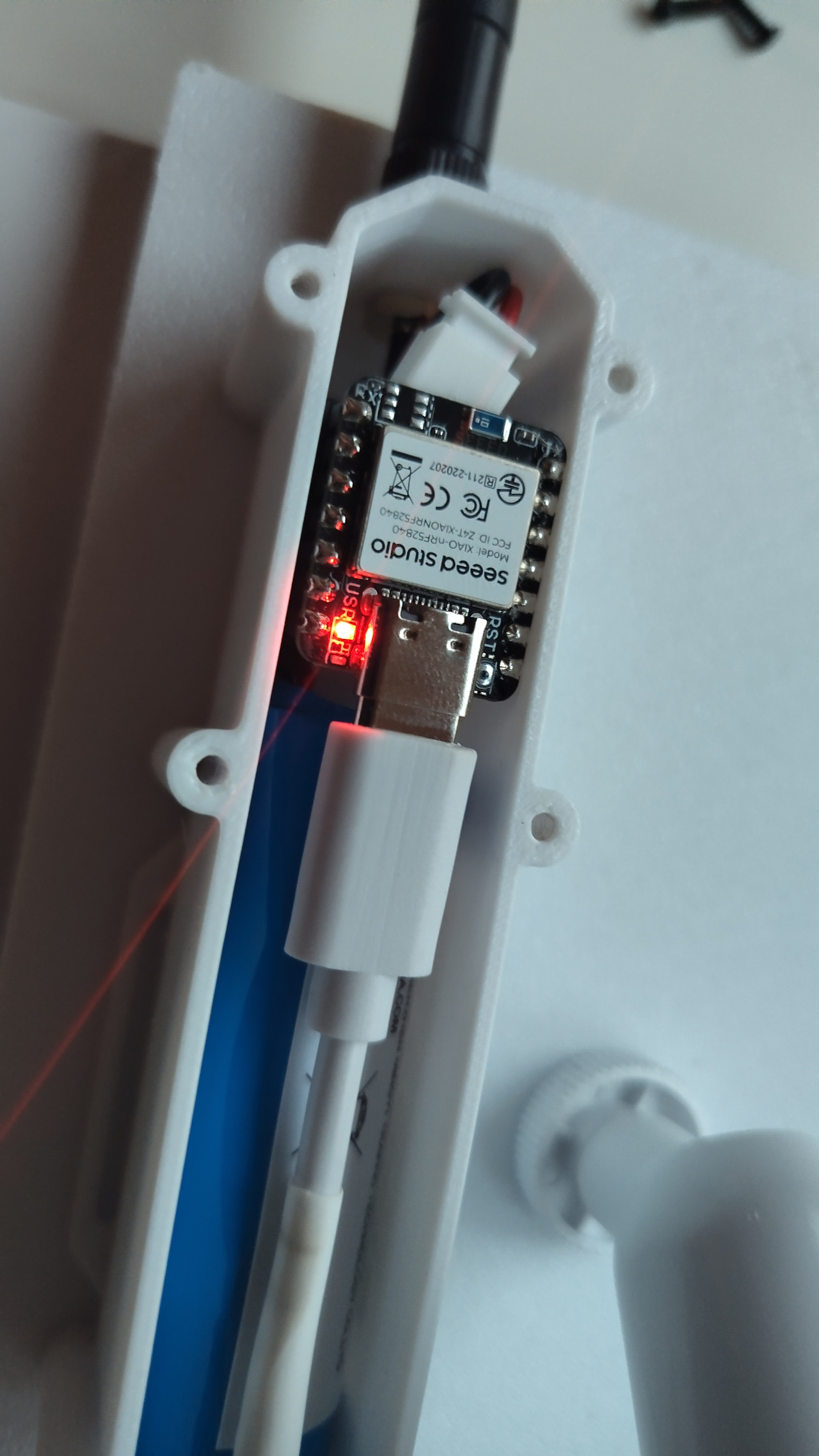

So it just happened again - after around 18hrs:

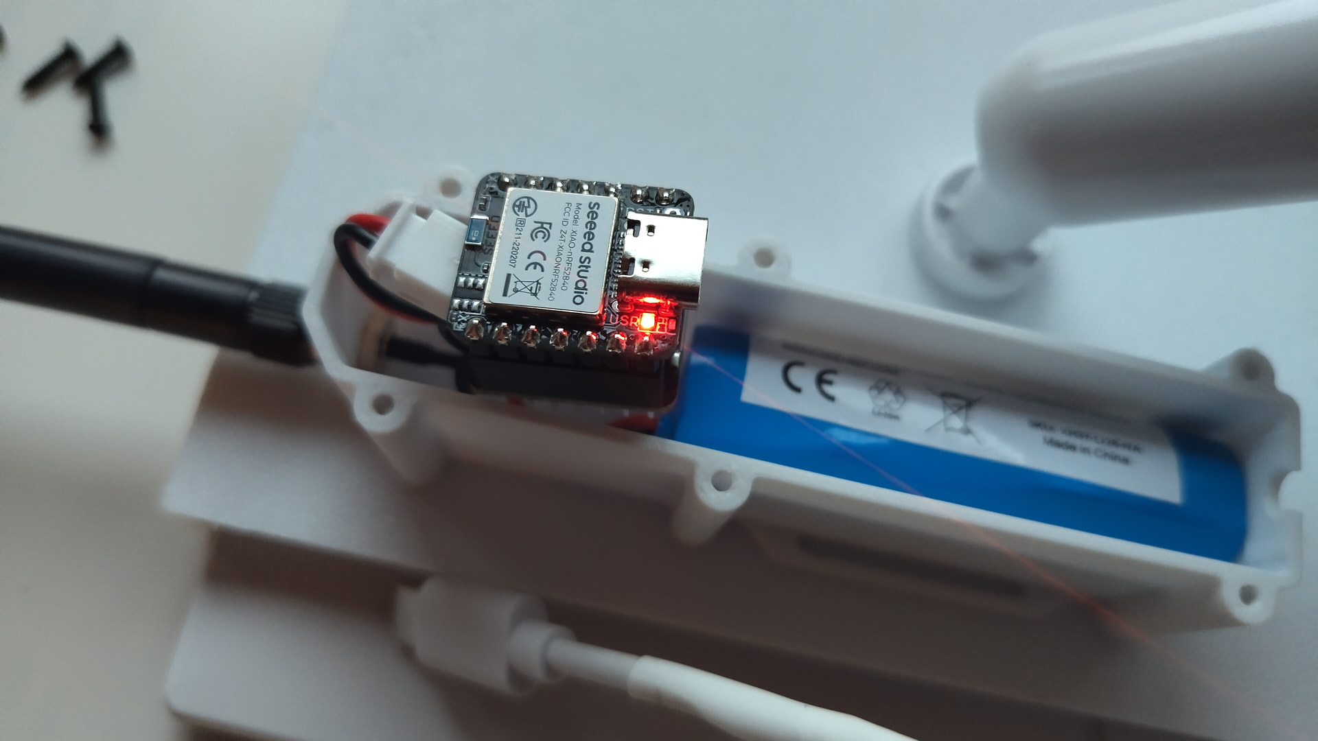

After unplugging the solar-panel it is still not working:
I have to unplug the battery:

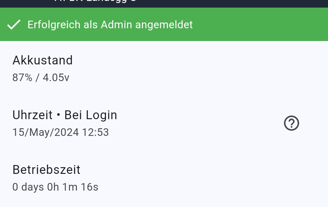

After reconnecting it, the device boots normally and shows the following stats:

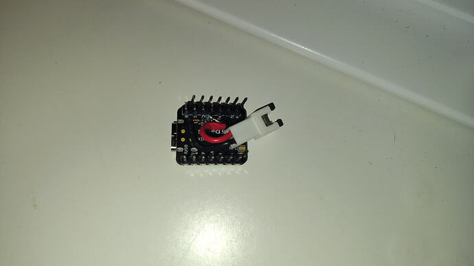

did it come pre-soldered? can we see the battery connection to PCB :eye:

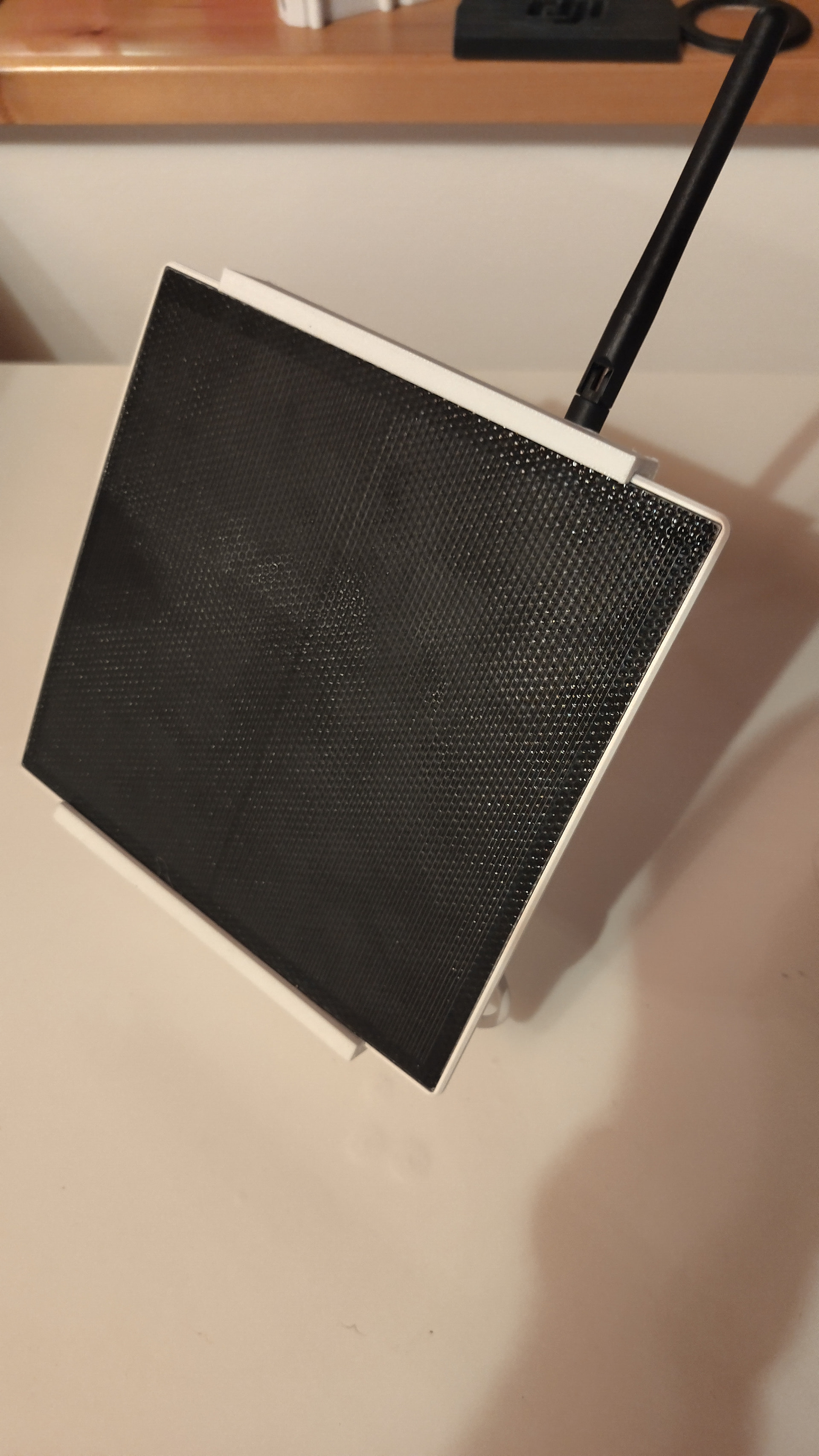

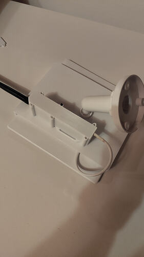

Yes the USB is always connected, it is the solar-panel, I 3d printed a minimalistic housing:
It did not came pre-soldered, but I`m mot sure if the soldering is a problem, because I have a second (identical) build that has the same issue.

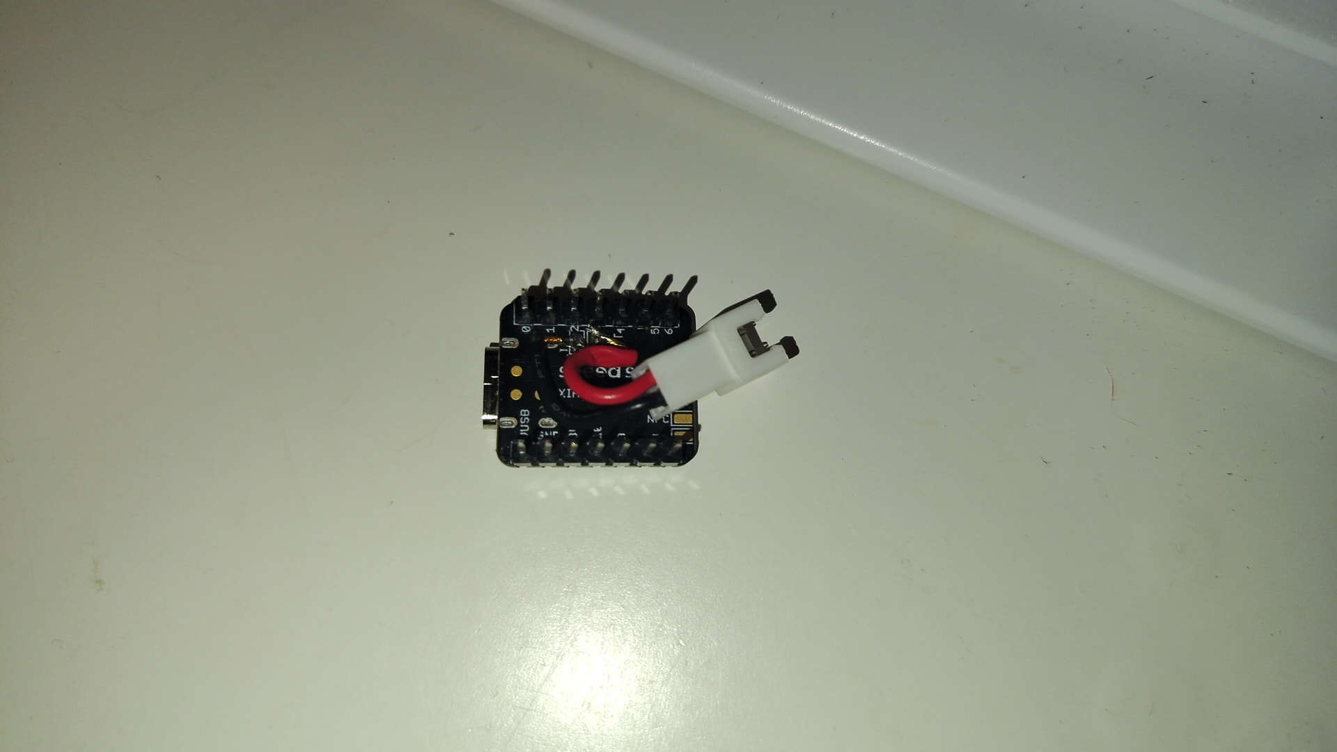

You have soldered to the battery pads under the nRF52 board? Edit: I see you posted photos, looks fine but you’ll have to check your soldering.
It gives me “Reset: Cold Boot; Shutdown: Unknown” which is kind of expected since I had to restart it because it was stuck. Do you really think a bad soldering could cause this issue? I mean if it was not soldered well, wouldnt there be always an issue? It works (and loads the battery via solar) for several hours and then suddenly stops working. First I was thinking about the outdoor temperature but then it worked a full night at -3°C without any errors.

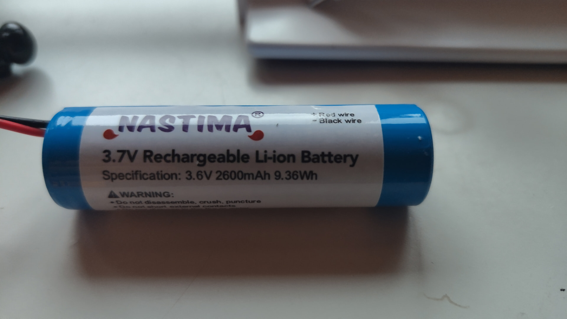

There are some fake Li-on batteries, do you have a capacity tester? You could also weigh the battery, an 18650 should weigh about 45-50 grams
AOK, looks good, nice work on the minimum :grin:

Can you test it with a battery Bank plugged into the USB-C and connect the battery also, how long before it stops (does it always have the RED RGB led ON ) when it fails , thats a USR LED. Hmmm
The solder is only somewhat sus, unless they are soldered the same way?

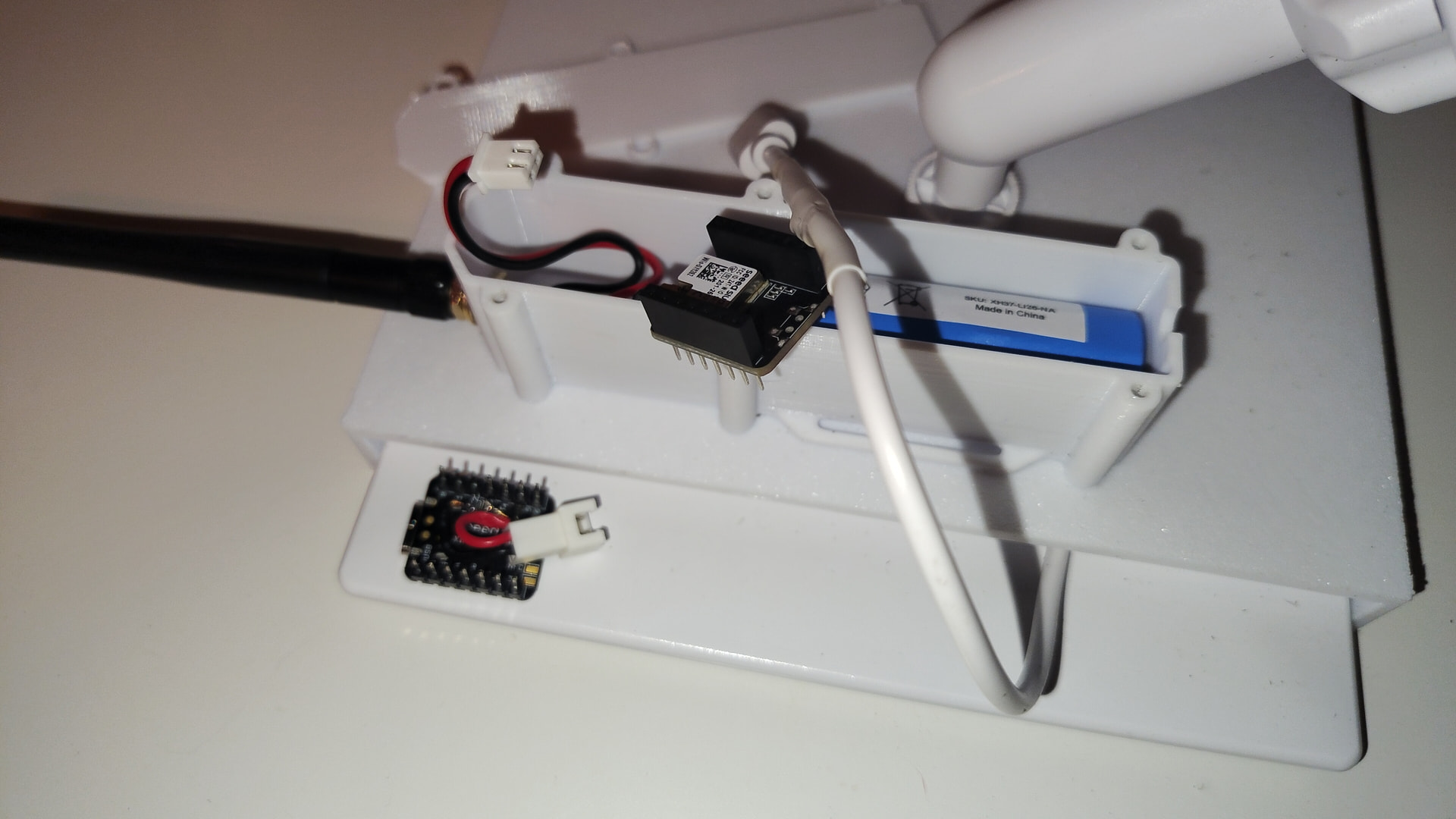

Solar Panel (BQ25101) in the middle and Battery, a pretty large one at that.:grin:
At some point the BQ is feeling the Heat or pressure, maybe unevenly and it latching up or crowbarring ??? Something is up with the Power rails as a result I’m betting.
Any Idea on how much current it operates normally on? How did you size the Battery?

Also I don’t think you need such heavy wire, I know you just used a pigtail that matched the whopper that comes on the Battery :grin: :crossed_fingers:
