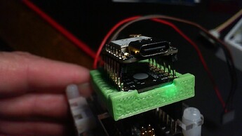

Works Great I used a socket with long pins.

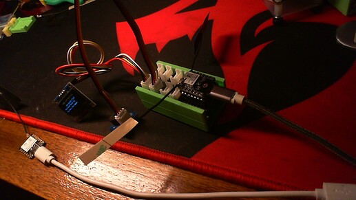

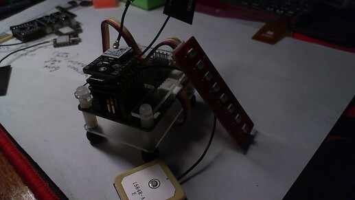

LORA + GPS + Xiao +expansion w/OLED and WS8212 LED Strip for status.

Thanks for the info and pics, I appreciate it! I read you could, and I read you couldn’t stack them on the expansion board base.
Sure, NP.

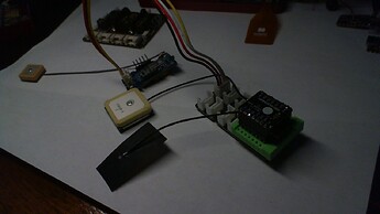

The stacking can be done by putting the GPS on the Bottom too.
Depending on Which Xiao kit you use , it changes slightly. :v:
GL: :slight_smile: PJ :v:

So, Having done exactly that , NOTHING to worry about, Both are supported, so
I don’t know where you get the “Beware” vibe from… :face_with_peeking_eye:

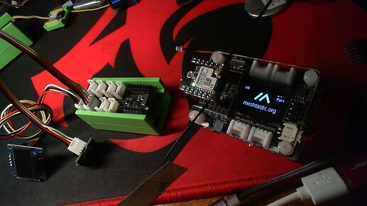

Not only does it work but , Look Mom, :blush: it has a display too…

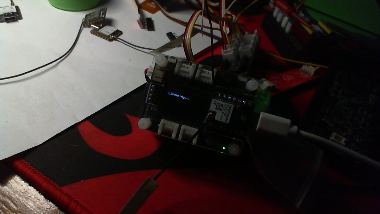

You can use the Other Grove Ports also…add a WS8212 8-bit Strip and use it for status

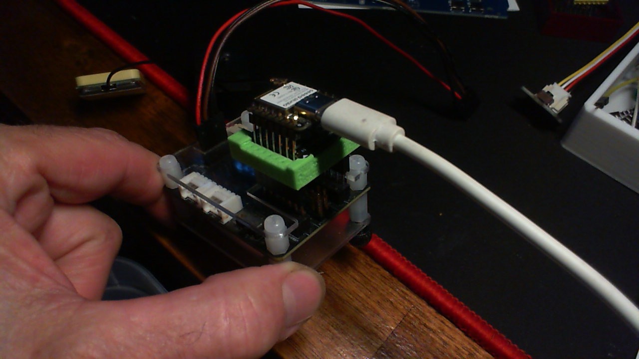

Works on the Smaller Breakable to a shorty :smile:
