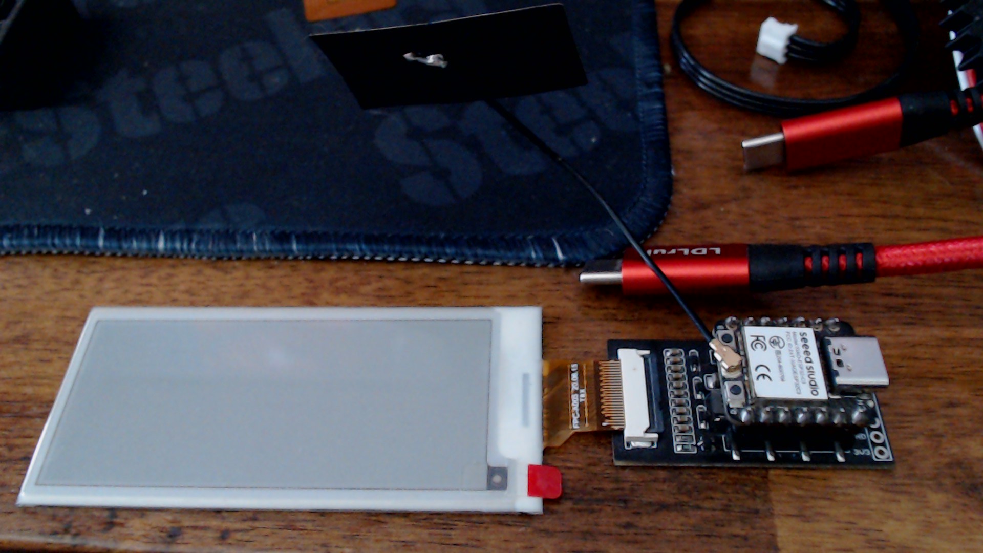

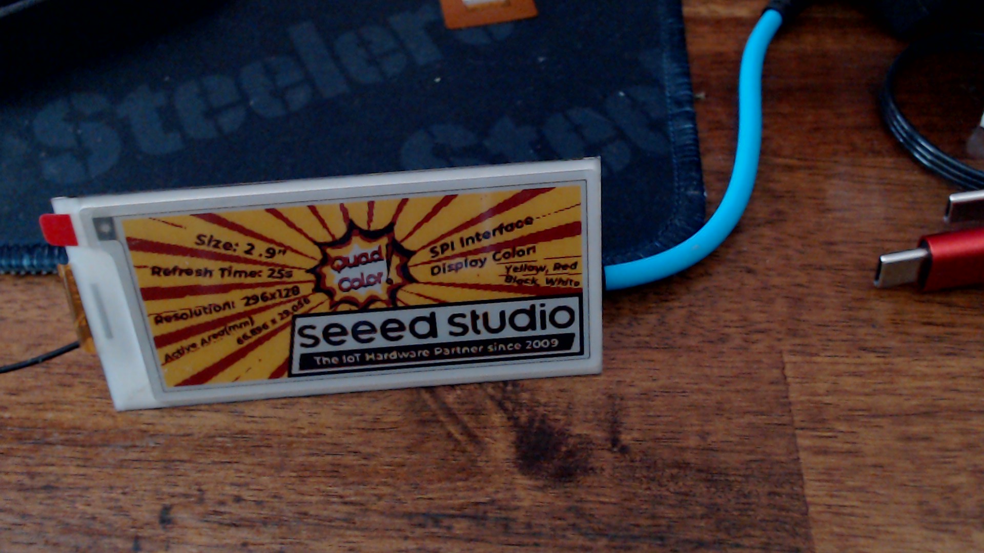

So, yep you are close… These are all the rage NOW. I just putting a Xiao C3 and the Quad 2.9 Display with the “breakout Board”
Great Colors. :+1:
Can you post a picture of it?
and If you can use the code tags up top " </> " paste it in there.
You’ll get good help that way.
The pins and the timing are what will be the key s to success, and the BSP.
I’ll post up the Quad 2.9 with code and video, after mass :folded_hands: today. :grinning_face_with_smiling_eyes:
