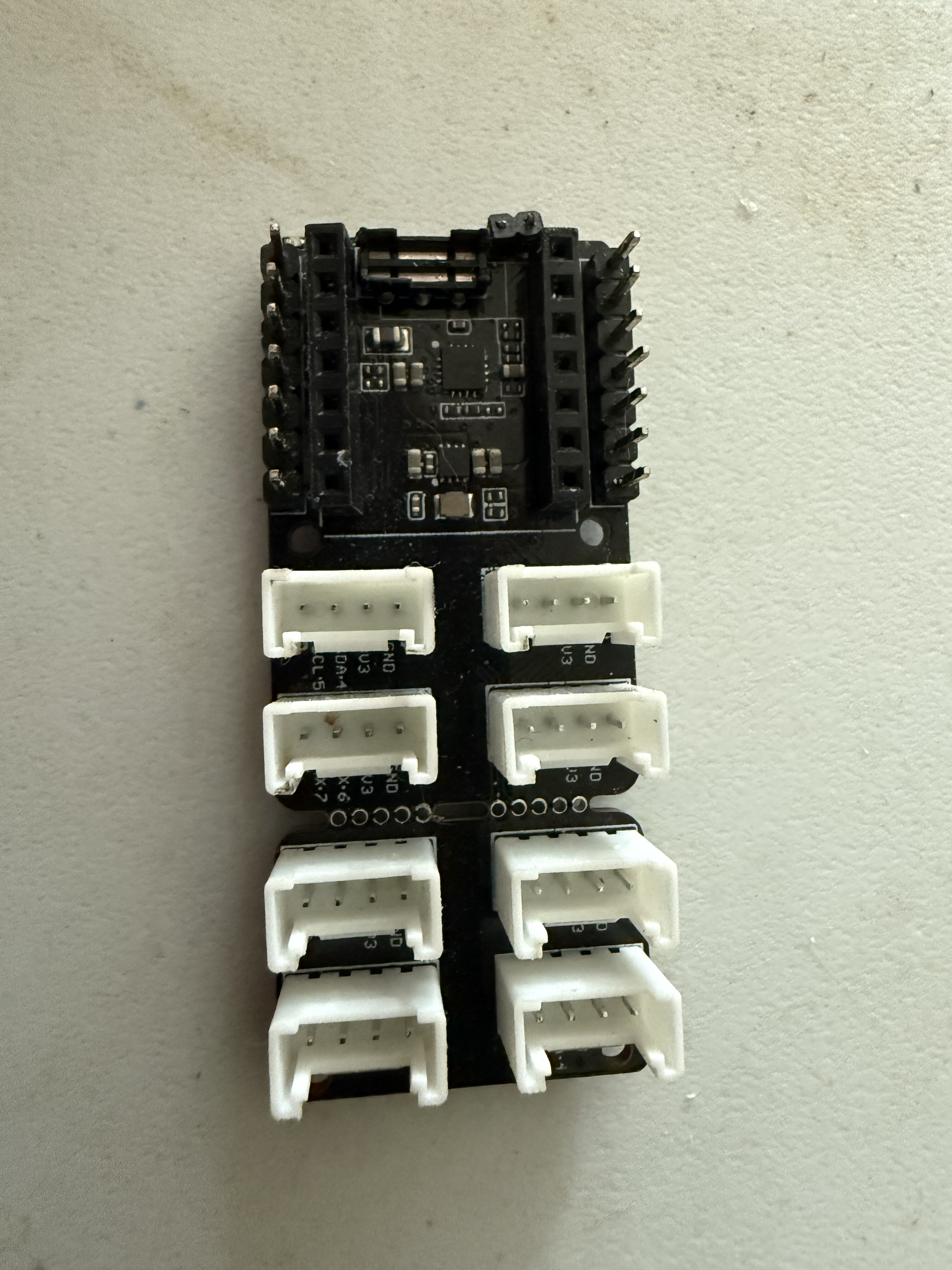

XIAO Grove Shield power switch - is it weak?
I have had the power switch on this device break off… It seems the metal can came off and the guts of the switch came out. When this event was observed it was installed inside a sealed container so not sure it recieved any excessive pressure. Seems to be the same switch as the big expansion board. I usually dont use the switch much and just leave it in the on position… SO i dont think it was from excessive use… I wonder if I deserve a replacement?
\I cant tell if this is one of my older units or a newer one… Not sure about the production dates
PS power connector pins are flemsy too… Is a redesign warrented?
PPS what is the future of the embeded power management chip… Are we thinking this is redundent? are we thinking with the fact that most all modern XIAO have onboard battery management we dont need this anymore?
I am thinking that i do not like the clunky solder to the back method… I like to be able to have the charging function AND be able to connect and disconect the unit
This brings the question… should the XIAO battery connector be moved to new pins… especially for new longer-more pins (Pro) units?
Question… could the 5v pin be reconfigured to also be the battery positive pin? what effect would this have if battery and usb are connected at the same time… I would assume as it is currently designed the usb would bypass the charging circuit and overvolt the battery (assume 3.7v) or the battery would backfeed the usb… Any thoughts?
