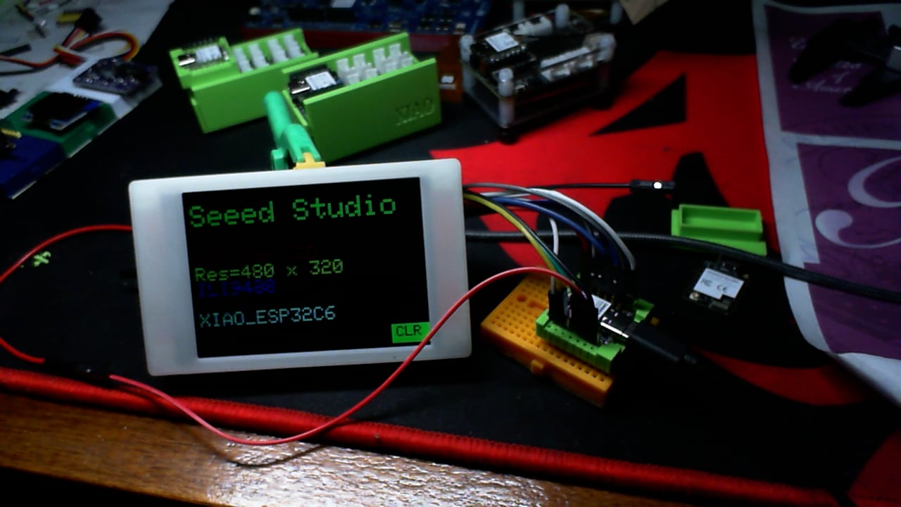

I used the Nexton display same lli9341 LIB :+1:
@Adler_Nunez was trying to get working.
