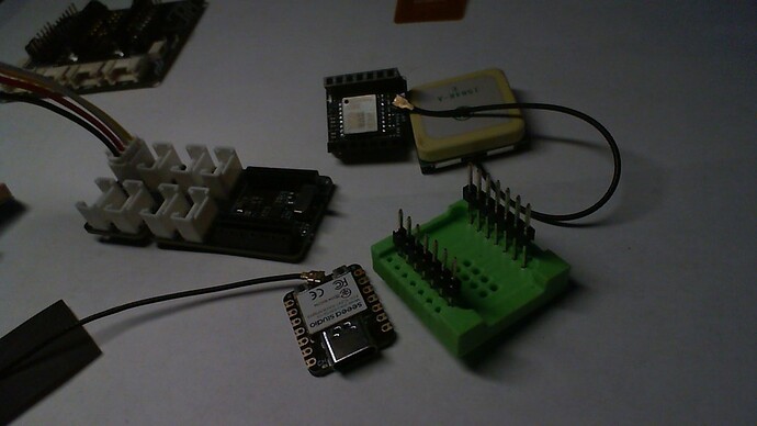

What GPS slab are you using, I’ll dig out my Air530 and start with that too, I have a "L76K GNSS " in the package too, so I can try it.
So two GPS units one Xiao that’s the GAme?
Ah’ I see… So red LED’s are a NO -Go right , Green on SAT lock ?
or what?
One is in the wrong plug.
Well… the current project is to read GPS data and echo it to the Nextion Display… but both devices what hardware serial connection
this study has resulted in the understanding that software serial does not work on ESP
Ok, Actually it does, but the implimintation is Nuanced…
i.e. only works a certain way on ESP that works on other either way, Go figure.
STart with the Hardware Serial , method assign the 9 & 10 pin & plugg the last grove wire into one.
Then use the software serial and pins 6 & 7 and two connectors over.
LMK
:v:
You can’t use those last two groves together as uarts
Unless you flip the pins on the first one
USE— > J6 and J8

must be something wrong with the C3 or My C3 because i just ran the S3 and got something working
LOL, I just got it going with the C3 , LOL
and the Air530 on 9 & 10, :slight_smile:
5 sats and counting…
Gl :slight_smile: PJ :v:

Pins 9 & 10 with Hardware serial… Like a BOSS!
straight Grove cable. J8 is the Money! :money_mouth_face:

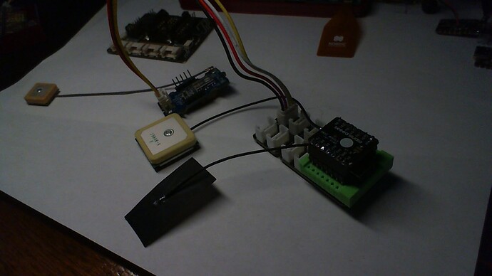

Ok , went to the other code added hardware serial , going , good, adding 2nd gps now…

I got one hardware going on S3
one of the gps is acting up… i dont know if the cmos battery is dead or what
I got them Both going on the C3, edited the example to add a column for which GPS is sending data , based on Age as Priority GPS-1 or GPS-2

Scroll over to the Right most edge…
Hardware Serial on one port and Software Serial on the other. You can swap them too. AFAIK.

This morning ,Rocking a rolling 2 GPS 30+ sats or 15’ish each… LOL

:v:
ROCK SOLID performance from the L76K GSS unit. seems to be a TAD faster and fresher than the Grove connected AIR530 Unit.
I was able to run each device with each method Hardware/Software Serial on either Port.
The key seems to be SoftSerial works better on pins that are already defined as a Uart channel. Hardware Serial can make changes to the interconnected PPI in the chips Peripherals to better support a Brute force or bitbanged io approach to serial comms.
Baud rates also play a role so don’t try to fast at first, test , tune and turn up as needed. :v:
I added the labels and posting current code and output. for others to duplicate.

Code running as Posted…
