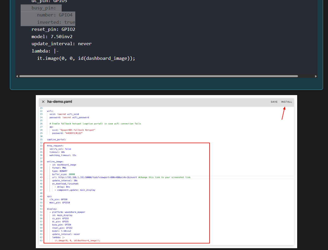

Hi, for the XIAO 7.5" ePaper Panel in combination with Home Assistant I see false and true being used for parameter inverted for the pin connected to the busy pin of the ePaper display.
Following above links shows below and contradicts itself:
Preview on full code shows inverted: true, but the screenshot of ha-demo.yaml shows no definition of parameter inverted, hence it is false.

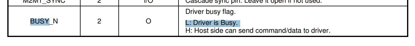

The ePaper display it stated to be using the UC8179 and the datasheet of this component states:
Based on this information, the parameter inverted should be set to true (since busy is low when being busy).
