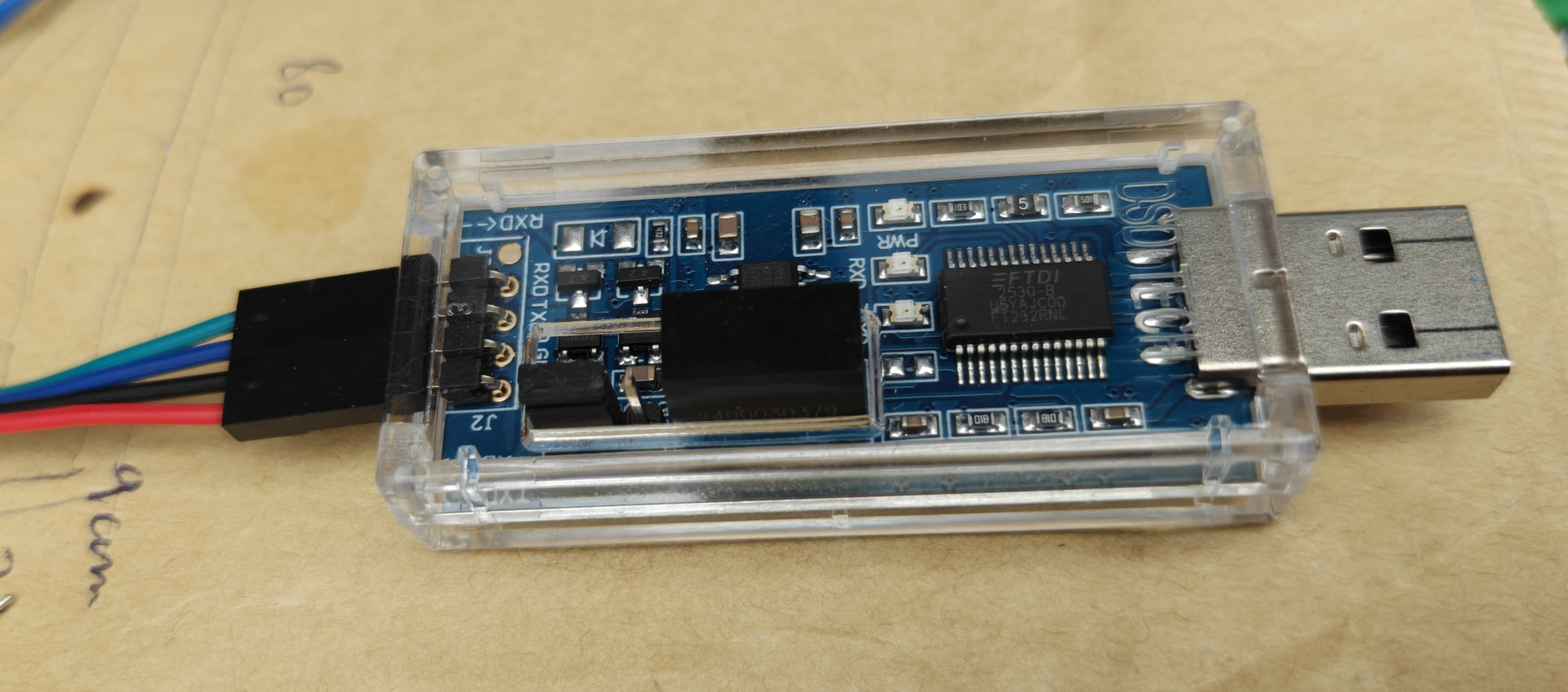

Had something like that , i ended flashing via UART with serial dongle
