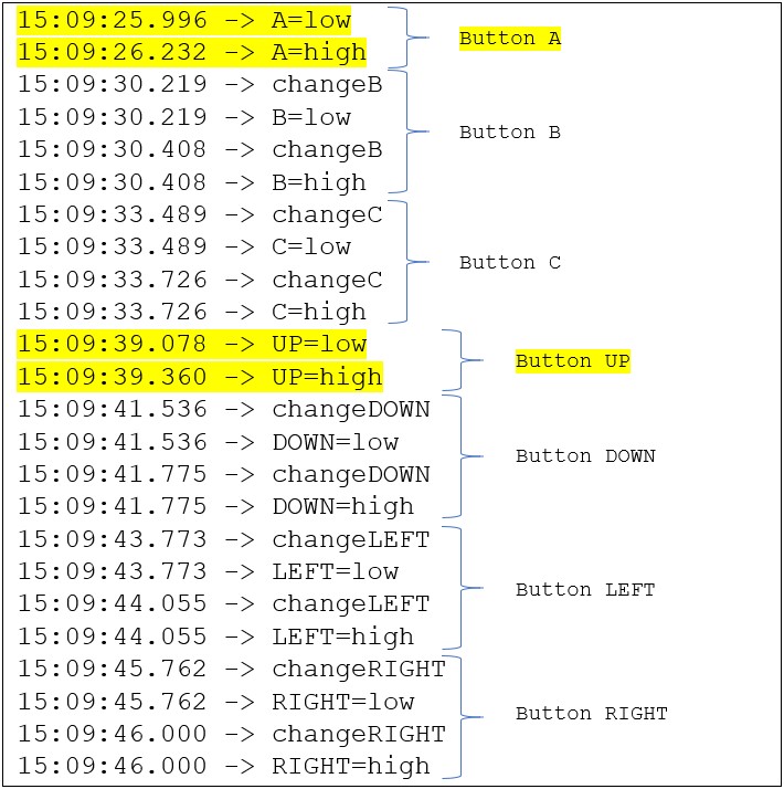

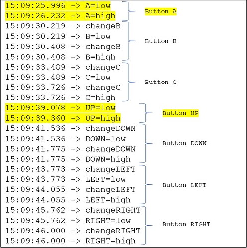

The result is that the “WIO_KEY_A” and “WIO_5S_UP” buttons do not work in interruption.
I don’t see why I have these errors because I just received this material.
These “WIO TERMINAL” might not be fully tested in factory output?
Thanks in advance for your opinion.
Program result
Why ?
