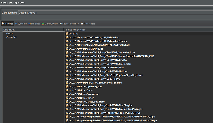

When I try to enable I2C for my sensor communication or anything for the case in Cubemx and build the generated code, all the library references which were previously there just go away and so it throws errors such as no file or directory, macro, structure,etc… exists. Every library folder path is included for the compiler and in paths and symbols, and also all the source folders are well included in the source locations which is why it worked without changing anything using CubeMX.

After CubeMX regenerates code, the include paths might get altered. Check and update the include paths:
Go to Project Properties > C/C++ Build >Settings >Tool Settings > MCU GCC Compiler > Include Paths.
All necessary folder paths are present as relative paths. Will changing it to absolute paths solve the issue?
