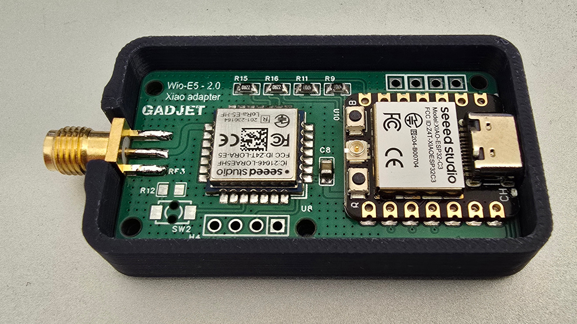

Just an update to my original post, it’s been a while but I now have several working projects using the ATMEGA328 and Wio E5 also the Xiao ESP32 modules connected to a Wio E5.
I’m not using Meshtastic or Meshcore but just sending data via the Wio E5 to a receiver and sending alerts via Pushover, MQTT and hosting a webpage.
