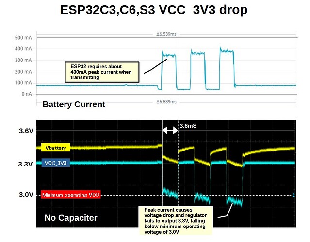

Therefore, using a small capacity battery with high internal resistance will cause a voltage drop and the 3.3V regulator will not be able to output 3.0V, the minimum operating voltage of the ESP32. The result is an unexpected reset, but there has been some scattered information on using a large capacitor to solve this problem.
In this post, we use XIAO_ESP32C3 and a 100mAh LiPo battery to test how effectively a 470uF capacitor compensates for the voltage drop that occurs when TxPower is at its maximum of 21dBm. The capacitor provides most of the peak current required by the ESP32, preventing the regulator from dropping its output voltage.
