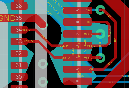

If you are looking for the ATSAMD21 USB pin USB_D+ and USB_D-, it was not exposed in the XIAO via gpio pin or test pads, you might need to use jumper wires and solder directly to the USB pads or the ATSAMD21 pad’s in the XIAO.

I agree on that since it’s connected directly with the controller, it is hard to make jumper wires. or you can make your own Type-C based adapter board that connects the xiao.
