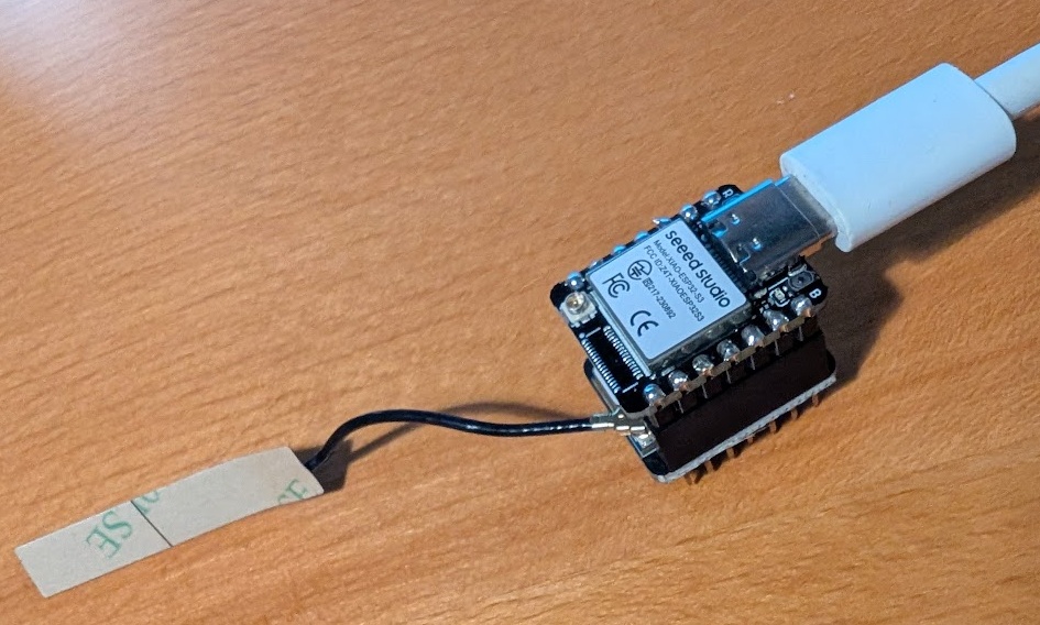

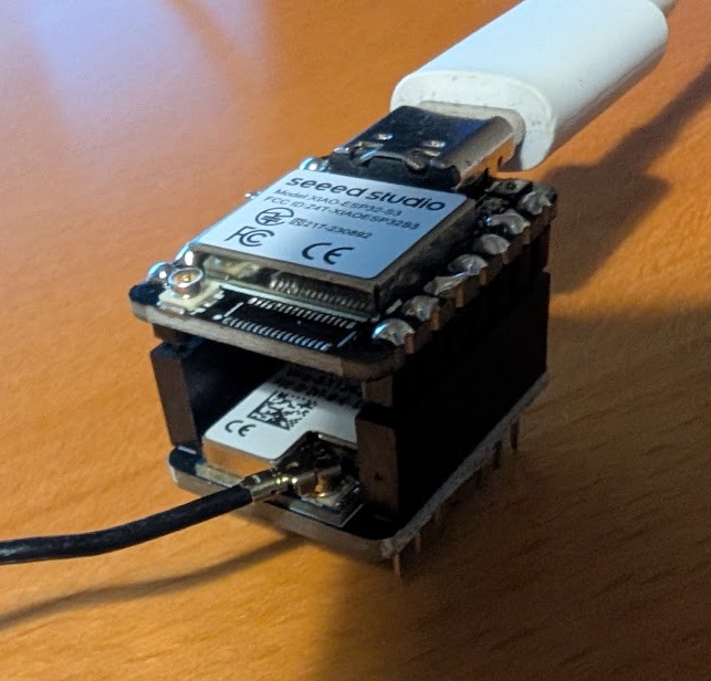

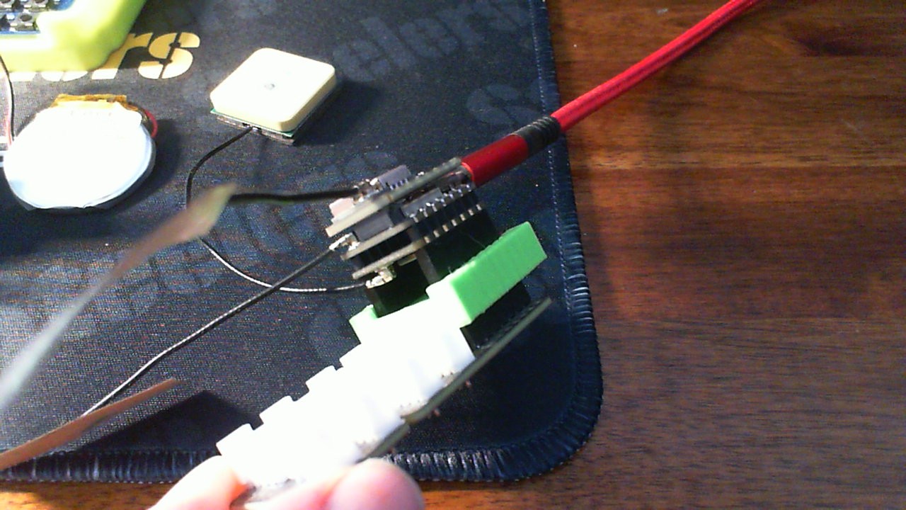

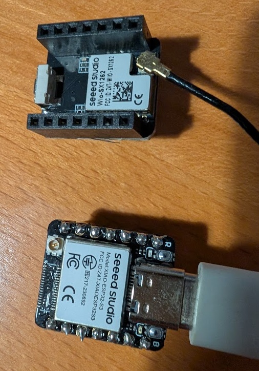

Can you show a picture of this device :+1:
Here are my pictures :

20 years of playing with arduino and I finally found my Xiao-Nemesis :sweat_smile:
LOL…
So you see that isn’t the same Lower unit. :grin:
Thus the pin defines in the code are incorrect… Adjust that and Bob’s Your Uncle :v:

Ok, So you miss understood.

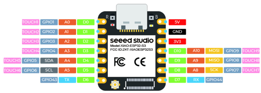

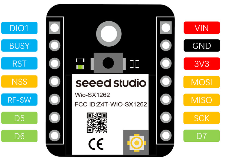

The pins defined in the demo are for the B2B version of the lORA board, You are using the First revision Board for XIAO.
So those pins are incorrect for that version of lora board.
Change them to the GPIO numbers of the silk-screen ) number D1-D10.

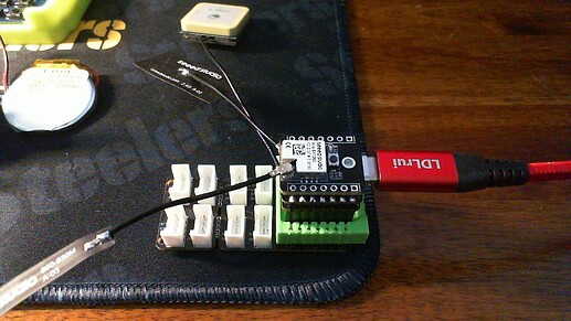

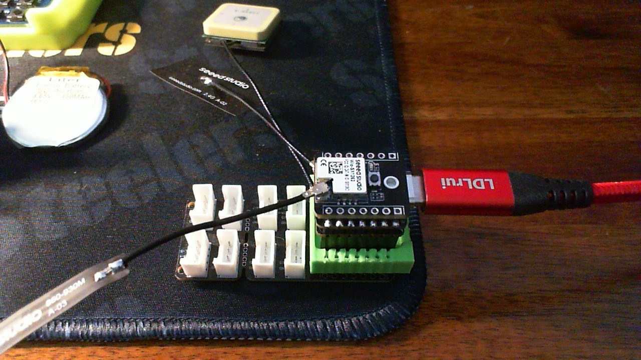

Look at the pictures again. I have the GPS board on there, Here is a thread that goes more deeply into the discussion but the pins are more aplicable.
something along theses lines,
SX1262 radio = new Module(/*NSS*/D4, /*DIO1*/D1, /*NRST*/D2, /*BUSY*/D3);
from this :crossed_fingers:
SX1262 radio = new Module(41, 39, 42, 40);  // NSS, DIO1, RST, BUSY
GL :slight_smile: Pj :v:
you have this one.
You may NOT have PIN 6 though, some boards did not have that connection. :+1:

:raised_hands:FINALLY !!! :clap:
You can’t imagine my relief. Eternal thanks !!!

Did I understand it correctly? Xiao nRF52840 + Wio SX1252 RF_SW=PIN 5, TX=LOW, RX=HIGH and no setDio2AsRfSwitch, right?
I have found a few more settings where you can trade current for a stronger connection:
// Current limit configuration (in 2.5 mA steps from 60 to 140) - default is 120 mA
radio.setCurrentLimit(140)
// CRC configuration (0 to 2 bytes) - default is 2 (adds bytes to load)
radio.setCRC(2)
// Receiver gain boost mode (true/false) - default is false
radio.setRxBoostedGainMode(1)
Hi Johann_S,
I believe that as long as you set D5 to HIGH, RS_SW will automatically switch depending on whether you are transmitting or receiving.
Please note that the maximum transmit power is regulated by the country in which the device is used.
