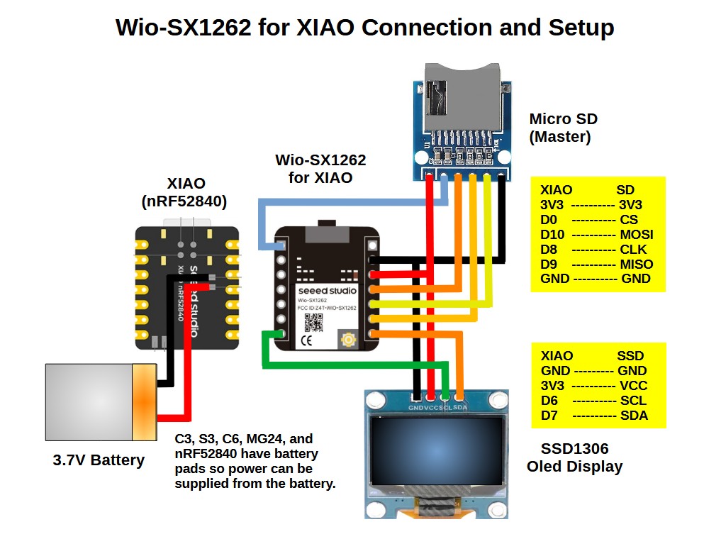

There are sketches for long distance communication experiments with various XIAOs.I think these will work with any master/slave combination.
If you are interested, please use them.
