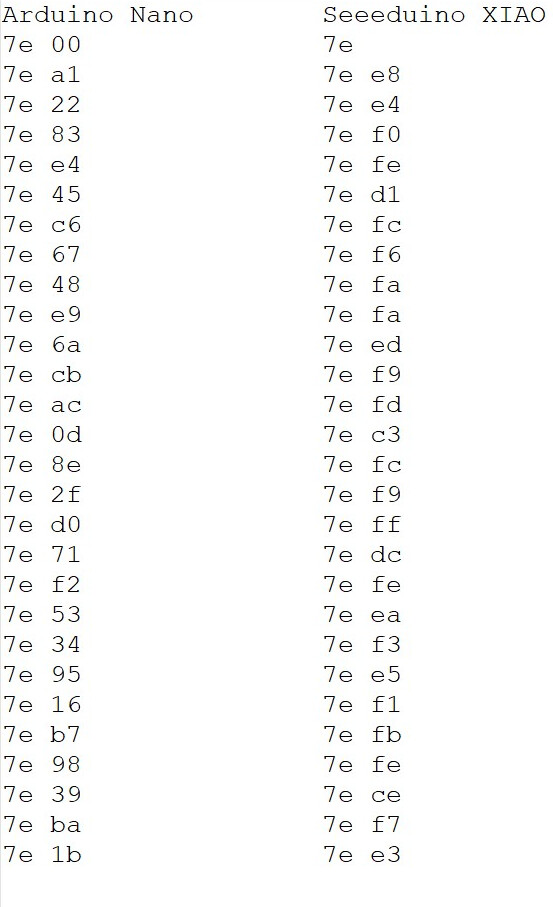

I am trying to move a sketch from Arduino Nano over to Seeeduino XIAO and I have noticed that the SoftwareSerial library does not behave the same on XIAO as it does on Arduino Nano when reading data.
Below I have included a table of pairs of data I am reading from Arduino and from XIAO generated from the same source. The 0x7E is a byte sent to determine that the next byte is a code of a sensor and I would expect the value pairs between the 2 microprocessors to be the same.
