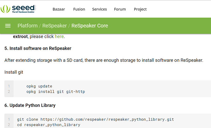

hello all.
I try make a exemple Voice Interaction with Respeaker Core V1 board
but there are several trouble
1- I can not finish 5th step : install software (picture)
2- There is no IDE connect to Respeacker. How can I add code to Respeaker.
thank to support and sorry about my English.

Thank you for the advice!
I try one by one
</s> opkg install git
opkg update
opkg install git git-http <e>
And there are results:
opkg install git : installed in root is up to date. --> OK
opkg update : … check passed. --> OK
but
opkg install git git-http :
[code]Collected errors:
- wfopen: //usr/lib/opkg/info/git-http.postinst: Read-only file system.
- wfopen: //usr/lib/opkg/info/git-http.control: Read-only file system.
- wfopen: //usr/lib/opkg/info/git-http.prerm: Read-only file system.
- wfopen: /usr/lib/git-core/git-http-fetch: Read-only file system.
- wfopen: /usr/lib/git-core/git-remote-http: Read-only file system.
- extract_archive: Cannot create symlink from ./usr/lib/git-core/git-remote-ftp to ‘git-remote-http’: Read-only file system.
- wfopen: /usr/lib/git-core/git-http-backend: Read-only file system.
- extract_archive: Cannot create symlink from ./usr/lib/git-core/git-remote-https to ‘git-remote-http’: Read-only file system.
- extract_archive: Cannot create symlink from ./usr/lib/git-core/git-remote-ftps to ‘git-remote-http’: Read-only file system.
- pkg_write_filelist: Failed to open //usr/lib/opkg/info/git-http.list: Read-only file system.
- opkg_install_pkg: Failed to extract data files for git-http. Package debris may remain!
- opkg_install_cmd: Cannot install package git-http.
[/code]
What wrong with Read-only file system
I used 16GB SD card, whitch first partition 4GB (FAT32) and second partition 12GB (EXT4) - recommendation by SEEED WIKI
