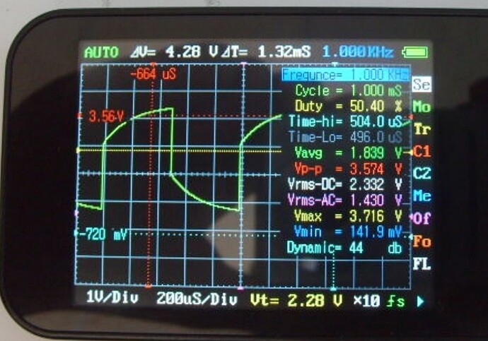

here is the third-party firmware for DSO Nano , it’s written by Paul.
And it modified the UI of DSO Nano base on the DS0201_V1.1 opensorce code , the computed mode of this firmware is reasonable than the source , and the display is more all-around .
here is the pic of this firmware :
you can use the USB interface to update it . the method of operation for this firmware will release soon and you can try it yourself…

If someone new didn’t happen to notice that V1.4 of the Paul firmware was buried in some thread somewhere, they might be very disappointed with the performance of the DSO Nano. I’m using V1.4 on a daily basis, and it is the most stable, most usable, and best looking of the various firmwares I have tried. The use of the “M” button to change the function of the cursor keypad rather than wasting either up/down or right/left for menu navigation is the main thing which makes the DSO Nano a real, usable tool. The pop-up screen which shows all computed measurements at once is great, and makes a huge difference when actually trying to analyze a signal.
