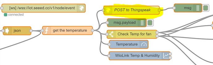

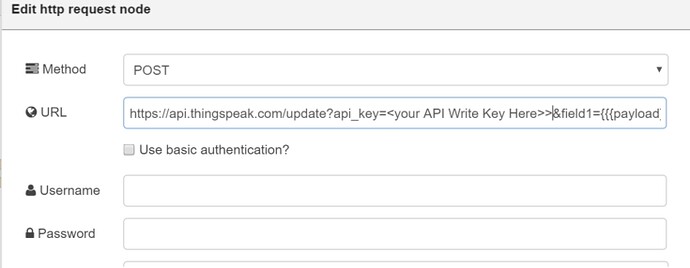

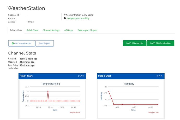

Hello kchios, thanks for letting me know about ThingSpeak. I previously was unaware of it and now I have connected it to WioLink and Grove sensors! I am using node-red and there is a published node on the website: thingspeak.com/) often from now on as it has excellent data analysis using MathLab tools.
