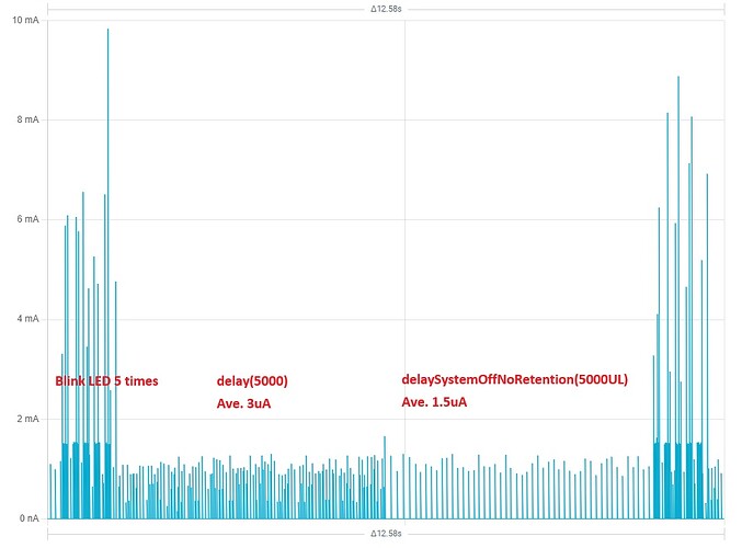

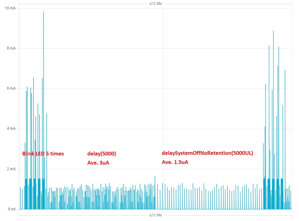

The XIAO nRF54L15 Works with Arduino
I measured the sleep current.
This is a preliminary report, but the values are roughly the same as those for the ncs+zephyr setup, even with ArduinoCore.
// BSP : Nrf54L15-Clean-Implementation v0.1.112
// 2026/03/22
// Important Notice:Tools->PowerProfile=WFI Idle
// Apply 3.8 V to the Vbat pad from PPK2
void setup() {
  pinMode(LED_BUILTIN, OUTPUT);
void loop() {
  // Blink LED 5 times
  for(int i = 0; i < 5; i++) {
    digitalWrite(LED_BUILTIN, LOW);
    delay(100);
    digitalWrite(LED_BUILTIN, HIGH);
    delay(100);
  // Light Sleep (warm boot)
  delay(5000);                        // 3 uA
  // Deep Sleep (cold boot)
  delaySystemOffNoRetention(5000UL);  // 1.5 uA
