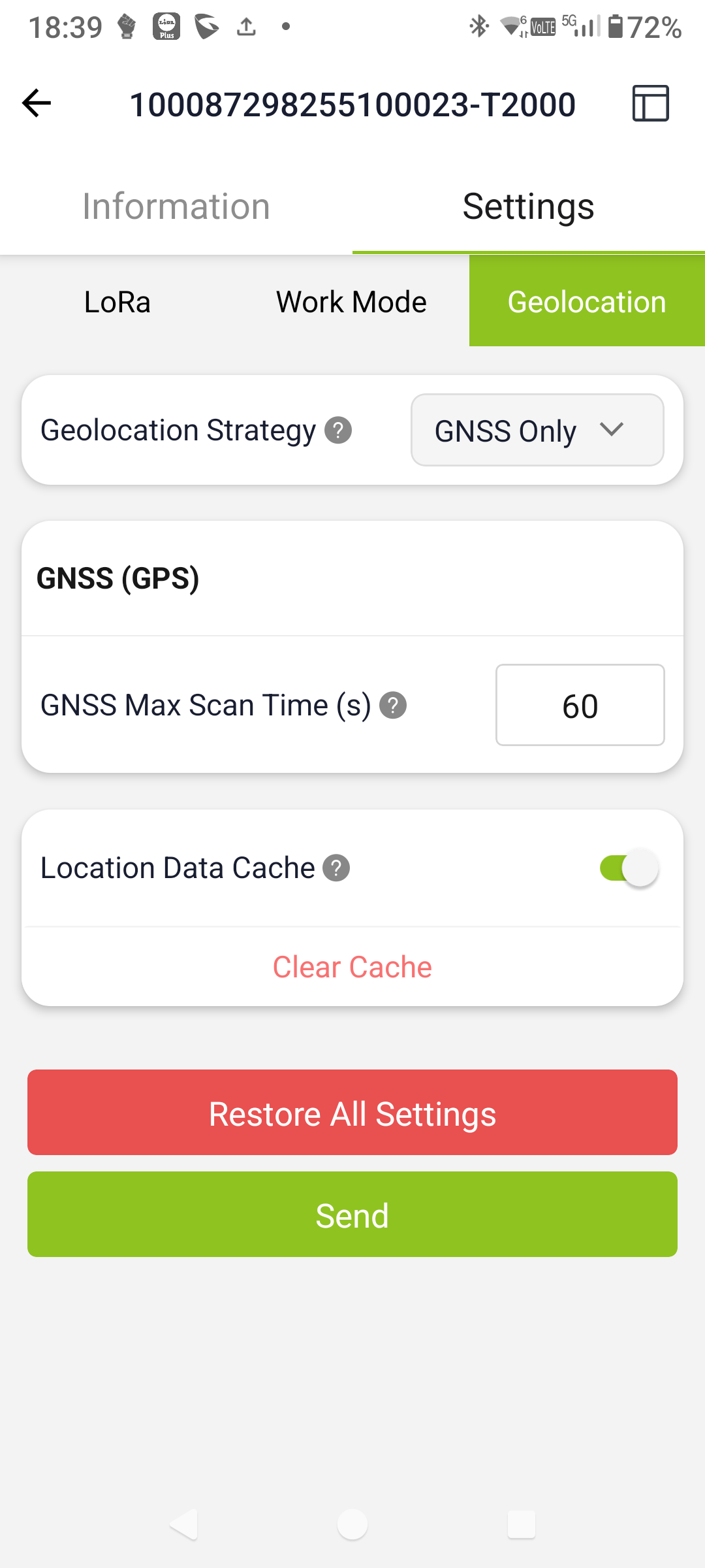

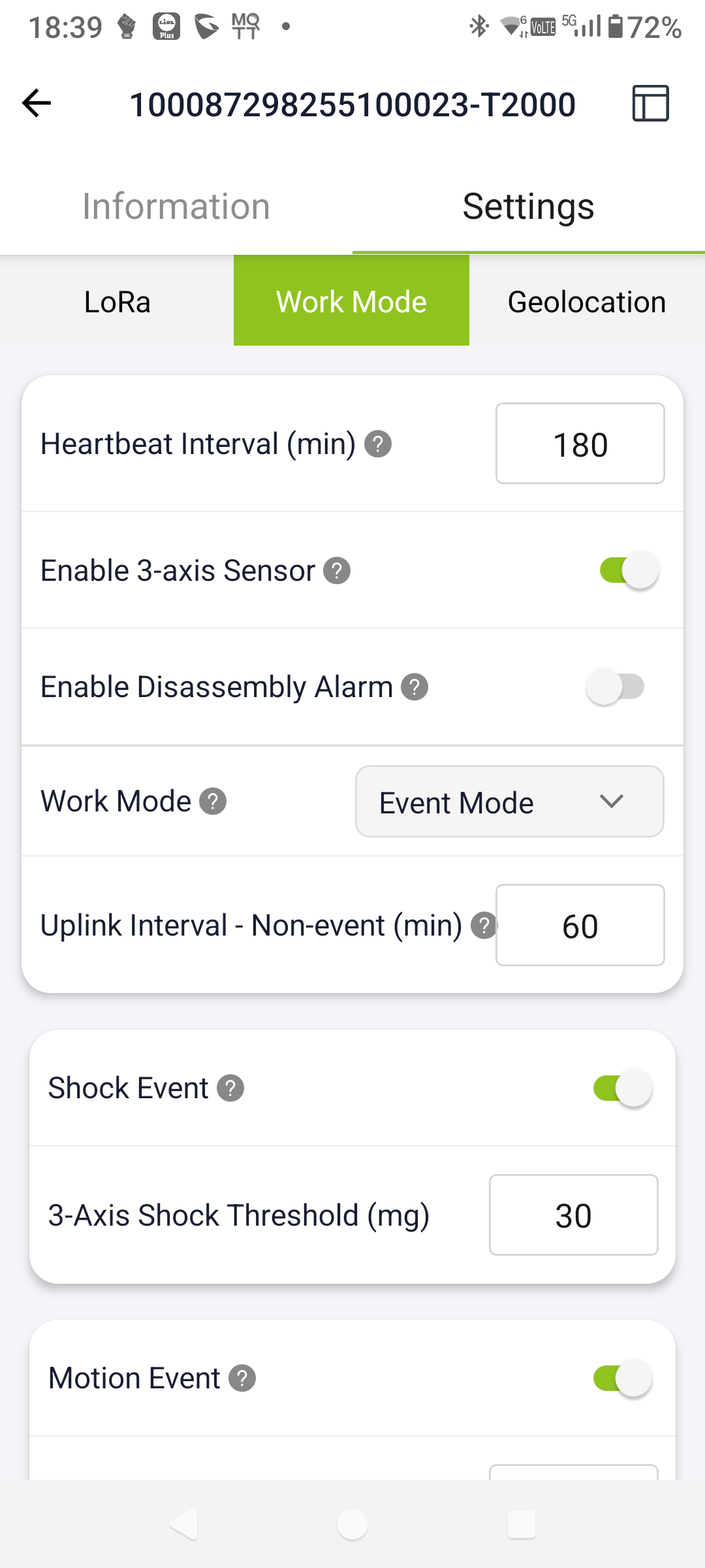

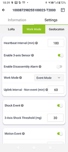

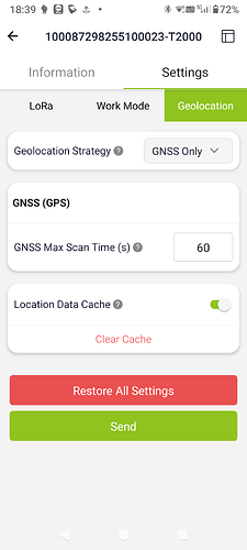

Hi Vincèn, could you please share screenshots of the complete configuration pages of your T2000-C in the SenseCraft App? This will help us better understand your current settings and investigate the issue. Additionally, could you please clarify what you mean by ‘it goes off’? Does the device offline completely or just stop sending uplinks?
Hi @PJ_Glasso
Thanks a lot for your help and here are my answer below :wink:
I’m confused as I don’t have that on my unit ! I have putted it in motion mode.
I have also activated the Motion and shock event so if it’s on someone while walking it should keep it awake and transmitting position no ?
But how to setup that ? I can’t find anything in the Sensecraft app that allows that.
Yeah I have already putted it outside with clear view of sky but I’m still not sure how it wakes up and why sometimes I’m unable to wake it up even using the magnet (or battery is very weak inside).
An additional question also regarding battery: does the device charge as soon as it gets light on solar panel or only if it’s on ?
Thanks

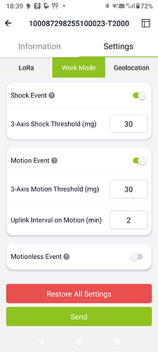

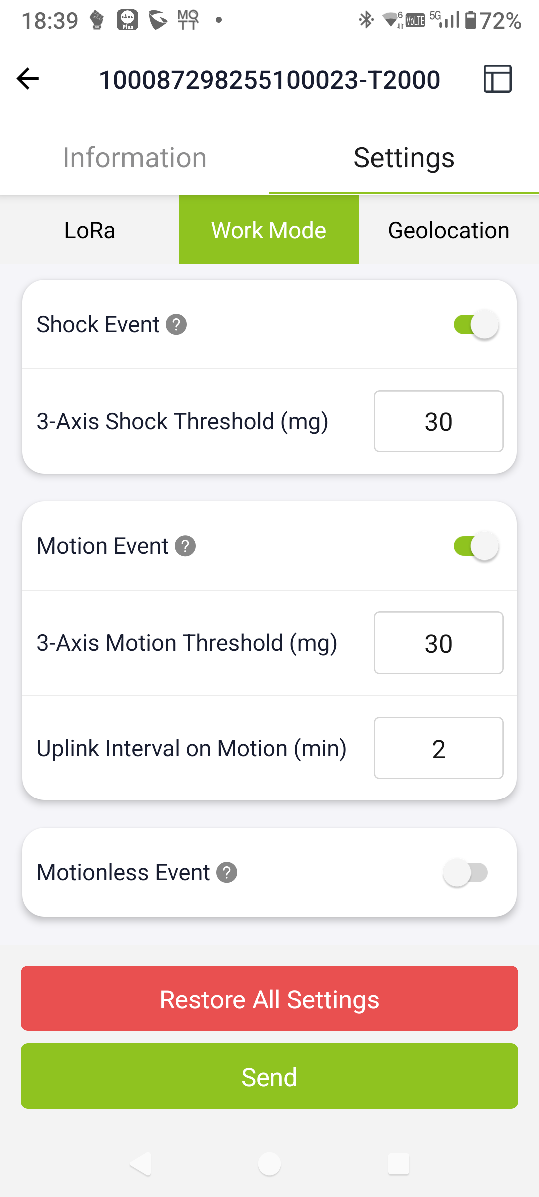

Hi Vincèn,
Please make sure the three-axis accelerometer thresholds are properly configured for the specific events.
  1. For the Shock Event, please try setting the three-axis accelerometer threshold to 300 and test whether the device behavior improves.
  2. For the Motion Event, please slightly increase the three-axis accelerometer threshold and test the effect. If the threshold is too sensitive, the device may not behave as expected in some scenarios.
