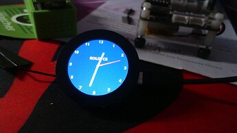

SO, Super Citric Fly’s in and Saves the DAY… NICE one :+1: Working Good Here.!
Here is my successful code demo and it works for both the C3 or C6 without edit.
I loaded some older code too and it worked without using the older TFT_eSPI lib, ver 2.5.23
Very Good!
I have not tested it in conjunction with WiFi or BLE I’ll try that next.
" this is a gauge demo with a Pointer value in the center (after the scrolling text)"
Compiler output and Serial output bellow. :face_with_monocle:
New ROLex…
Gauge Demo
