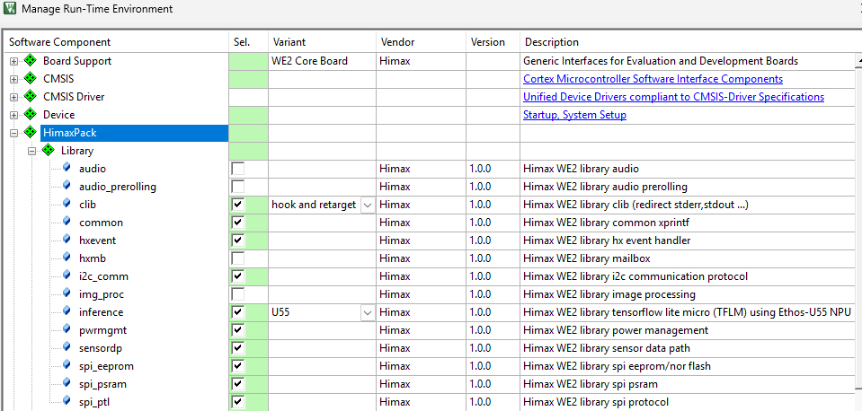

I ended up with the project in uVision, and finding my way to manage my runtime environment and enable i2c_comm, as shown in the image.
