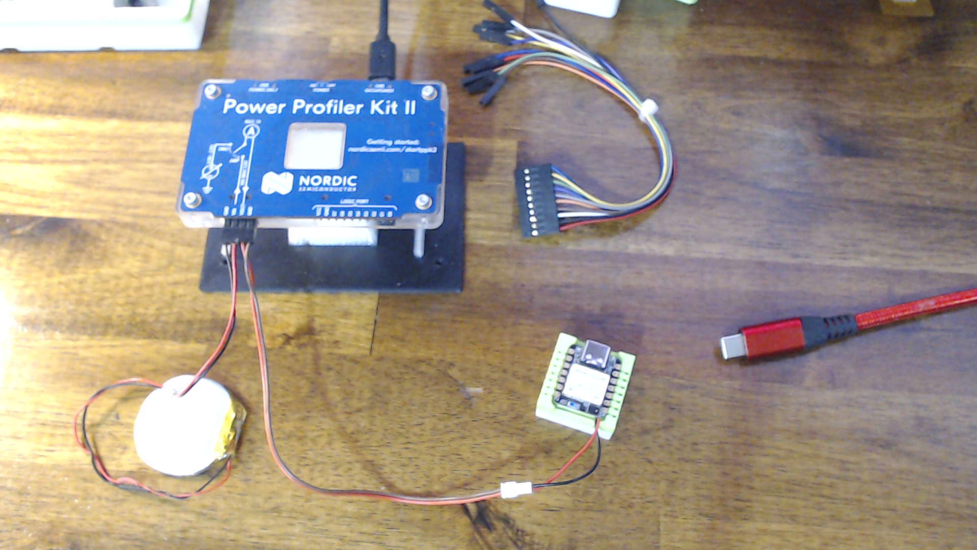

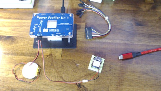

are you using a PPKII (power profiler) ? and which BSP ?

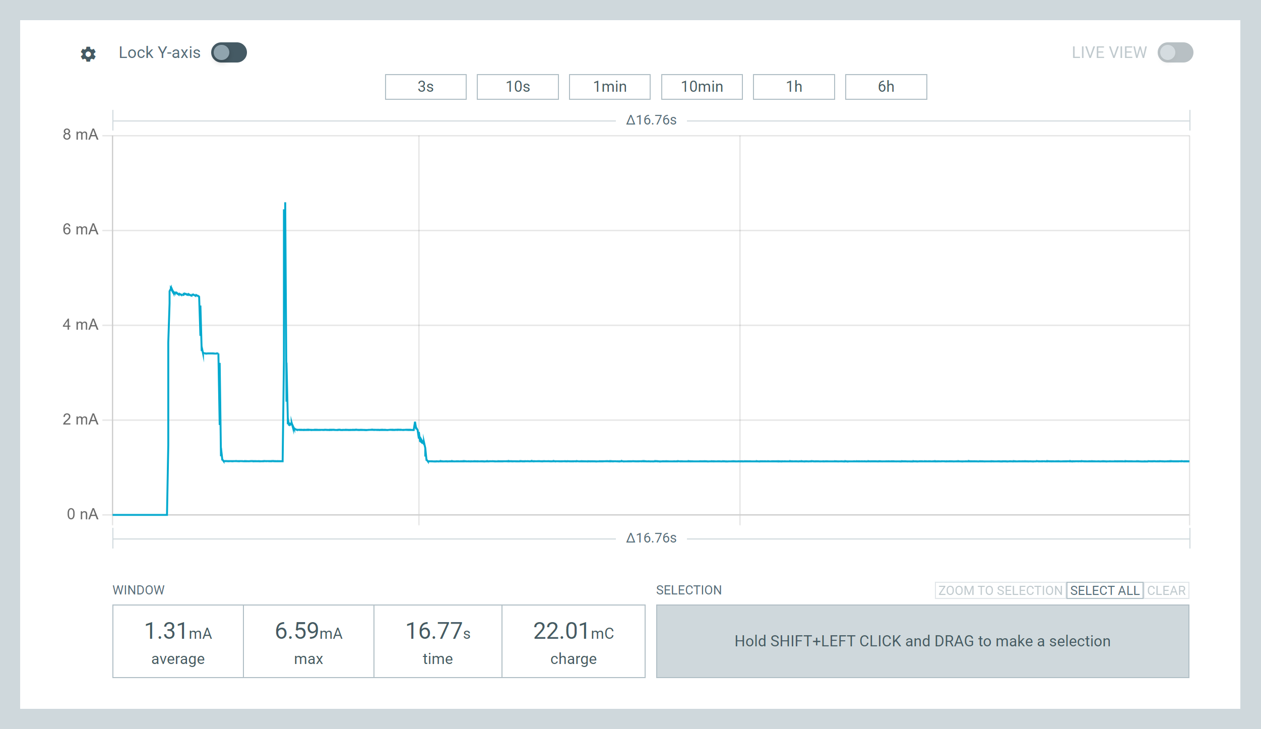

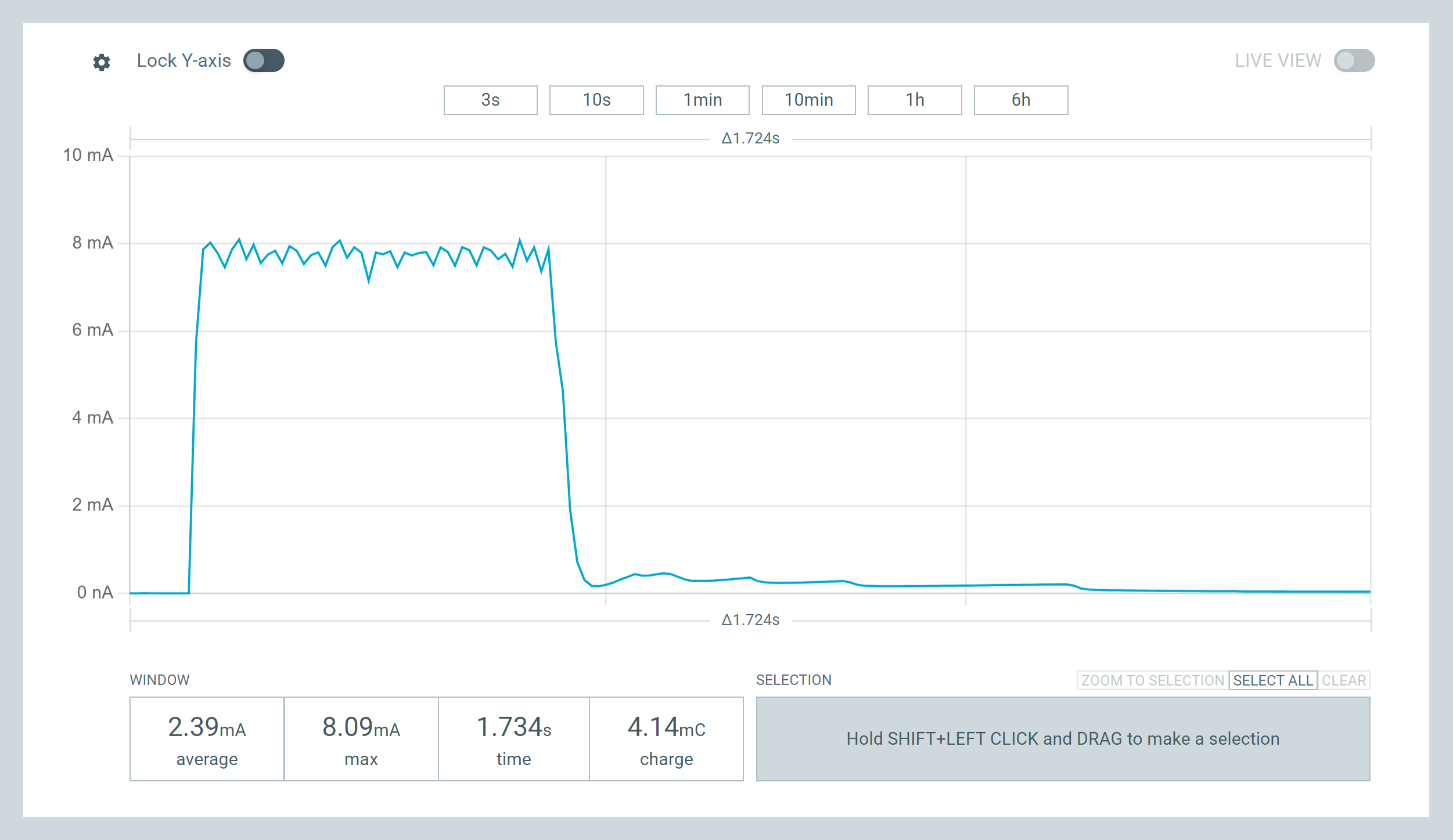

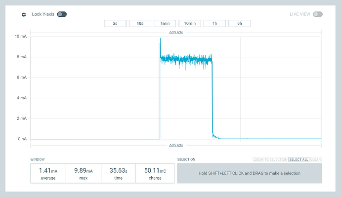

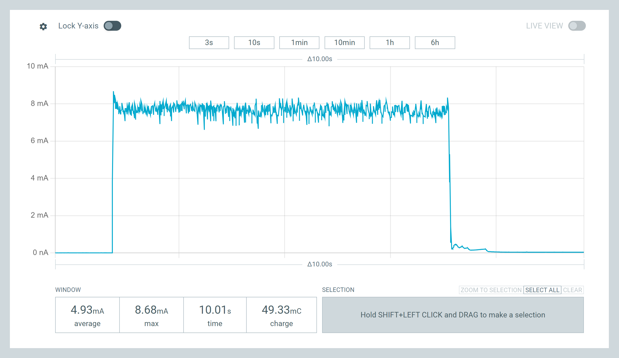

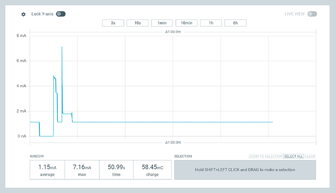

Now let’s dig into the power and sleep business. I have a PPKII hooked up to it now. so I can run it and observer the battery power and sleep currents
Confirmed your 8.4ma. RUN. BLE connected

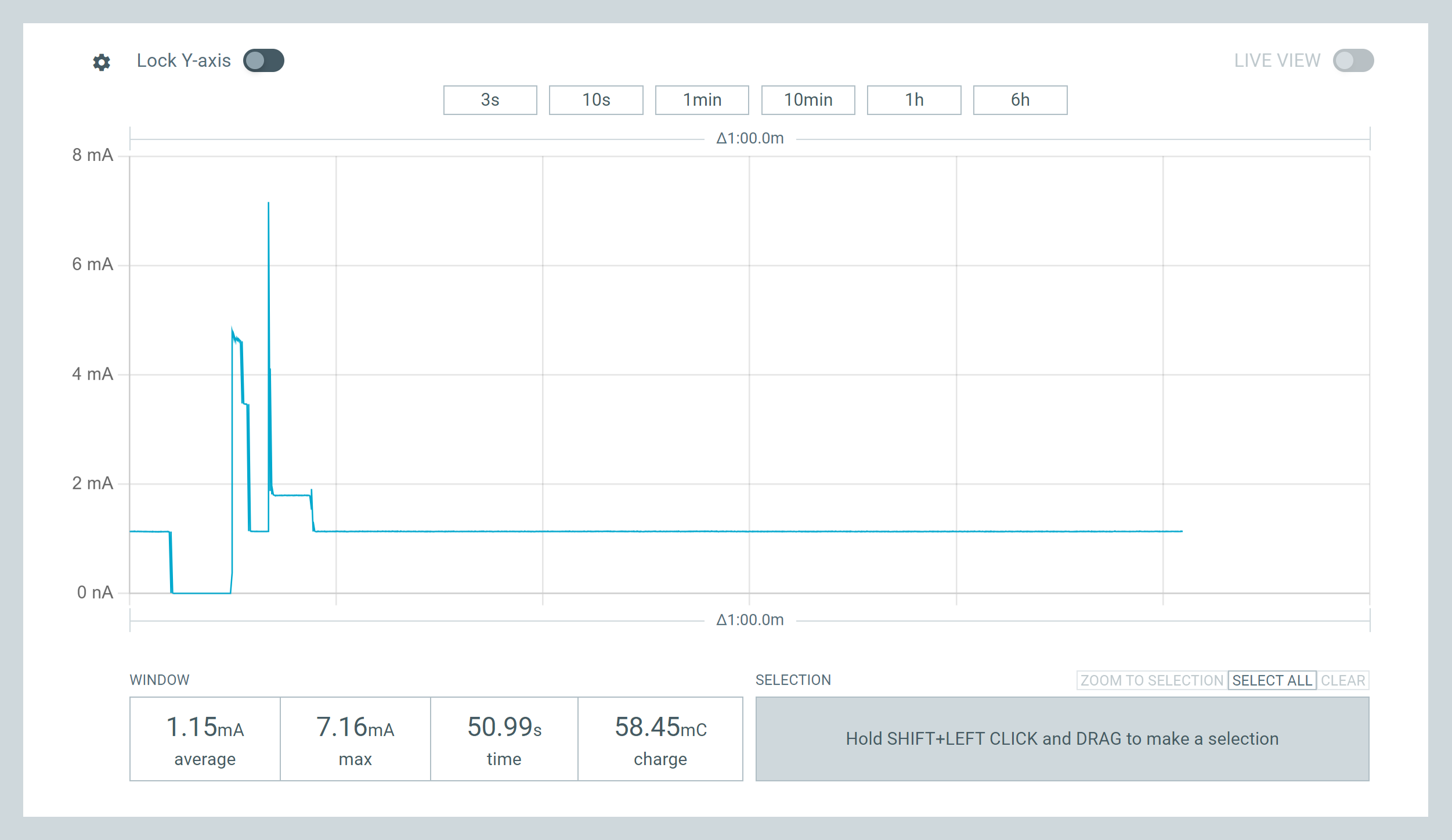

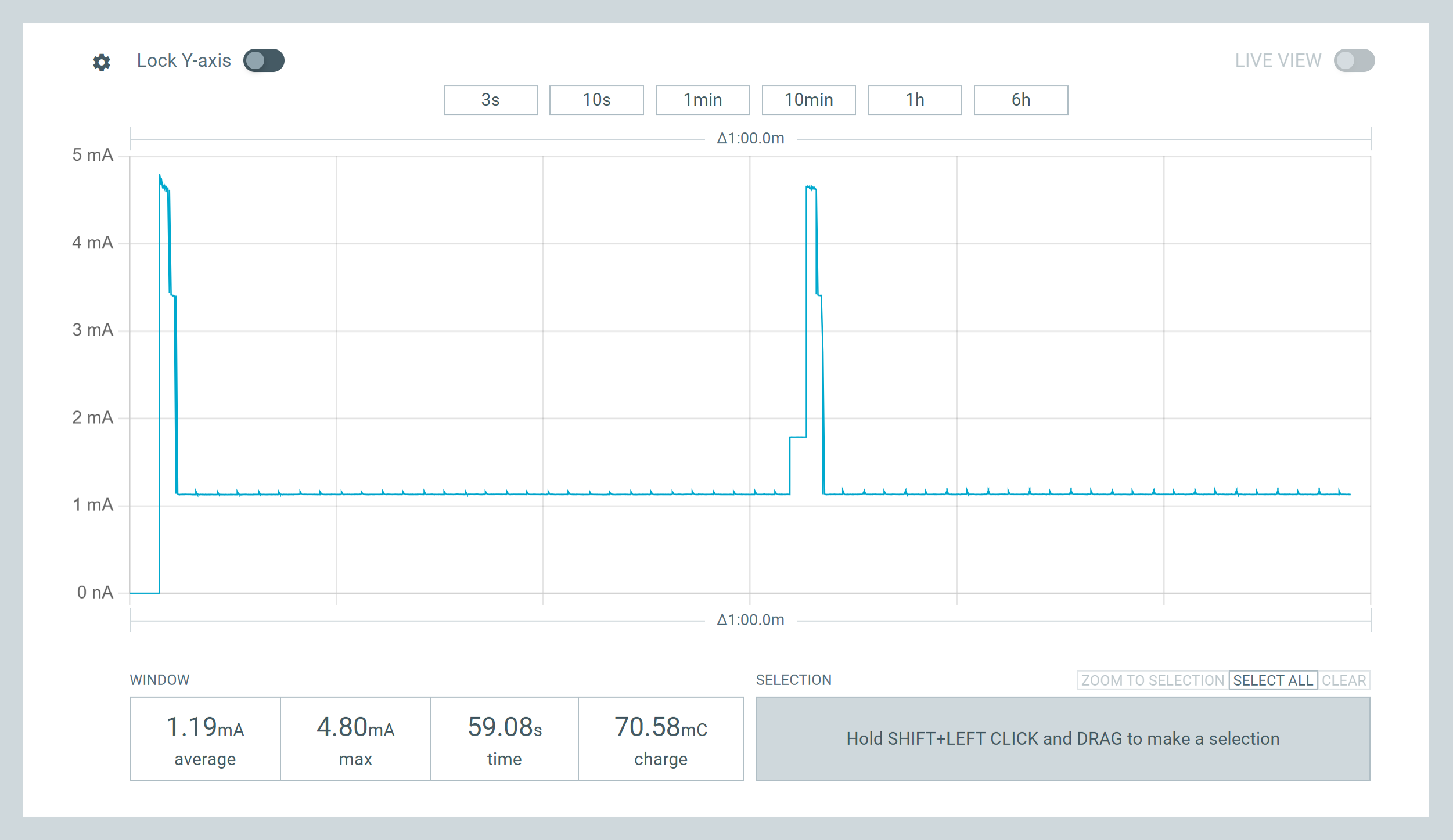

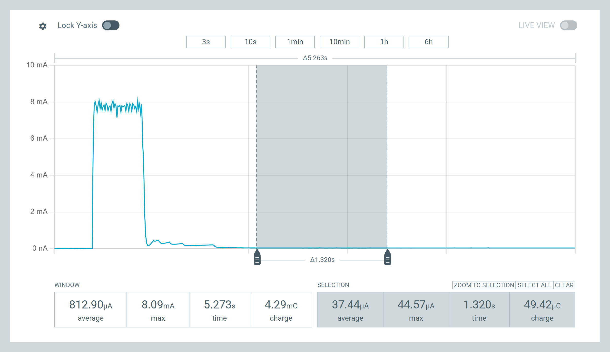

So, I tested and retested and I found some stuff.
XIAO nRF52840 Sense – Sleep Current Investigation
T1) Baseline: ~736–746 μA (SYSTEMOFF confirmed)
T2) BLE Test: Active 4–8 mA, sleep returns to ~746 μA
T3) GPIO Wake: Returns to ~746 μA
T4) Full App (no IMU): ~746 μA
T5) IMU Initialized (no shutdown): ~1.13 mA (+~400 μA increase)
T6) IMU Power Only: ~746 μA (no impact)
T7) Forced I2C Shutdown: ~10 mA (invalid state, not usable) :backhand_index_pointing_left: :face_with_peeking_eye:
T8) Correct Sequence (IMU standby + power off): ~736 μA (resolved)
Conclusion: IMU must be placed in standby before power removal. I2C lines can back-power the sensor if not properly shut down. Avoid Wire.end() on this BSP. :flexed_biceps:
Test 1
something is up on this IMU?
Fixed , getting closer…

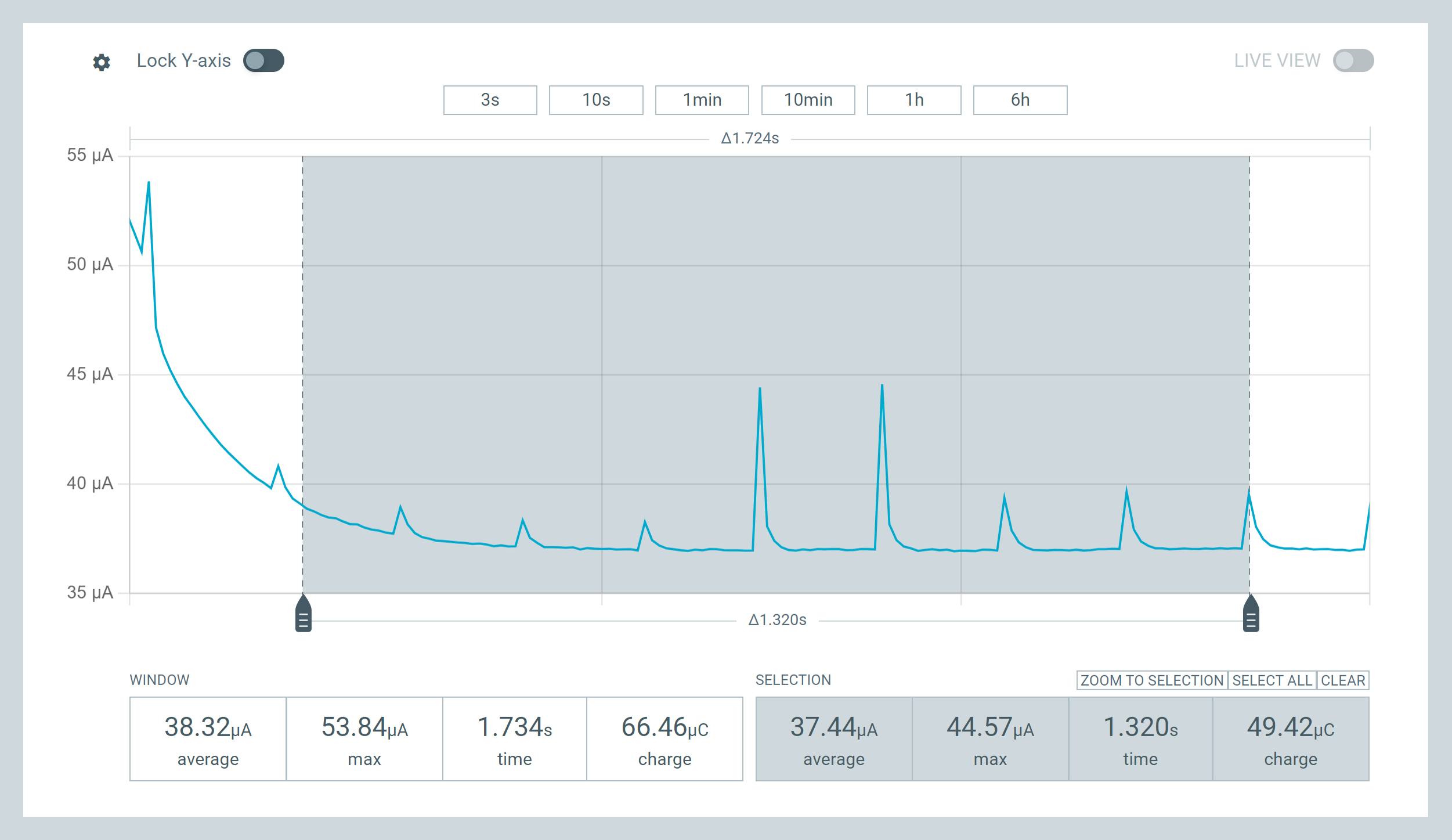

I’m getting 43ua. Sleep now… :shushing_face: Don’t wake it. :grin: :v:
Try this code with the FIX and LMK.. :crossed_fingers:
Sleep_Current_Report_Enhanced.zip (237.0 KB)
also I’m testing a pushbutton wake too, (D5), a little later.
