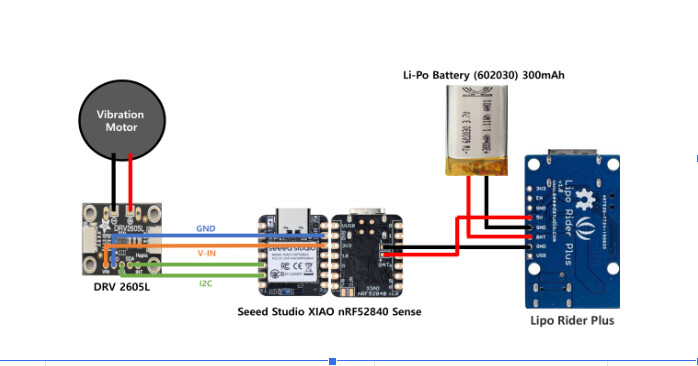

By connecting the XIAO nRF52840 Sense with the Adafruit DRV2605L Haptic Motor Controller, we are implementing a function that allows the vibration motor to vibrate when a specific value is sensed by the imu sensor.
However, since both the Adafruit DRV2605L Haptic Motor Controller and the imu sensor use i2c, the imu sensor is not working, is there a solution?
The circuit diagram is as below
+) Should I implement I2C priority between the two within Arduino code?

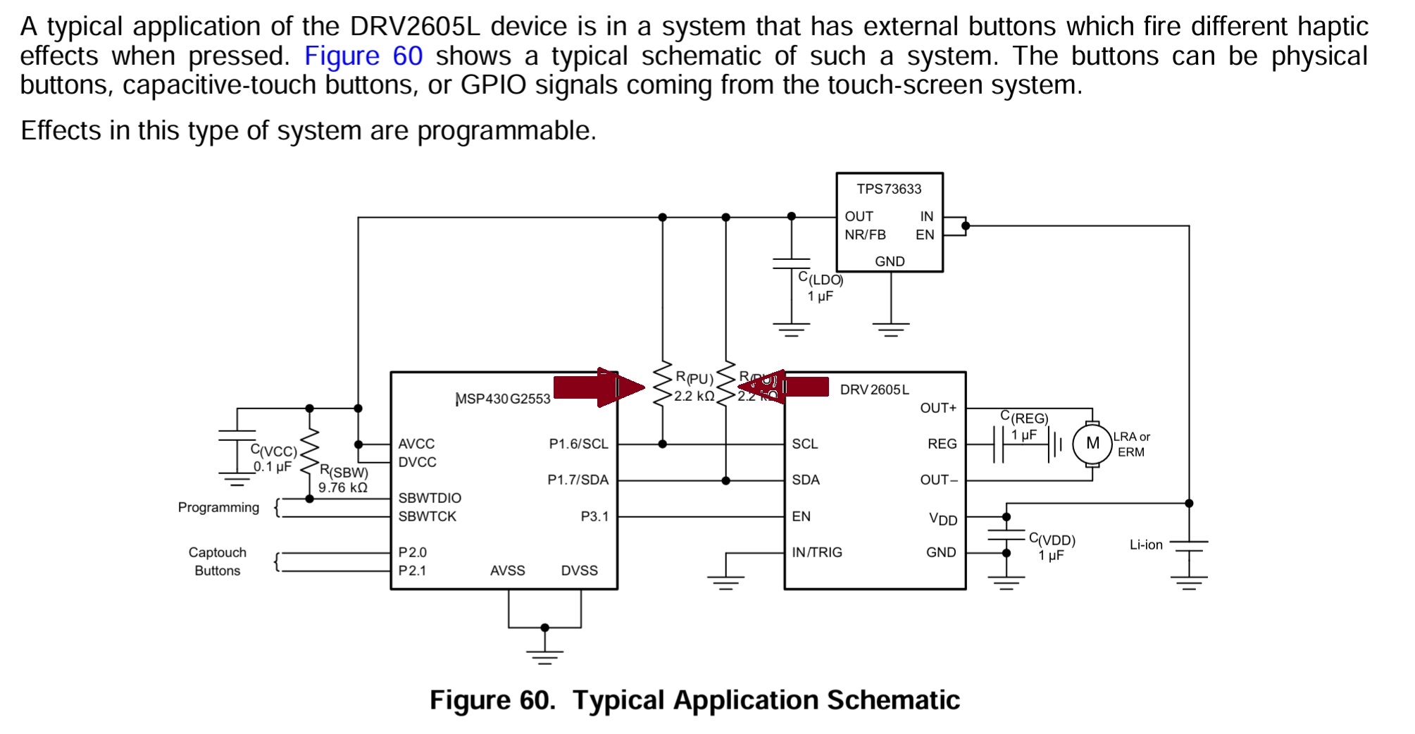

SO, I2C may need the pull-up resistors Does your DRV board have them?
What is the address of the DRV board ? does it differ from the IMU’s? it may be conflicting Addresses (i.e. set the same)

Are you referring to the IMU built into the XIAO? If so, it’s connected via a dedicated I2C bus, so it won’t conflict with the I2C on D4/D5.
We solved the problem by designing i2c independently within Arduino code.
Thank you bro
I might add , I see you power the Driver Board from the Xiao 3.3 v Pin
two things , are you certain the driver board is 3.3vdc device and if so
do you know how much current you need to drive(Xiao Source) the motor board properly ? I think it low like 5 ma.
It might be browning out the system with too heavy a draw ?

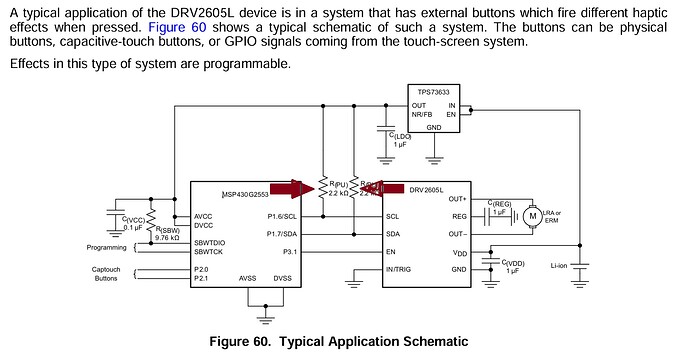

try some pull-ups in the code maybe?
