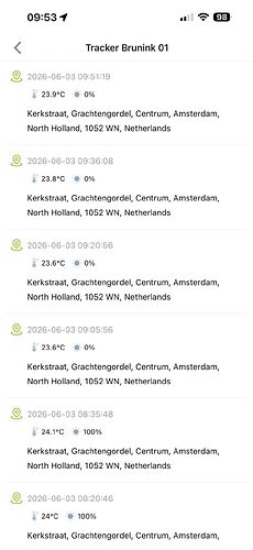

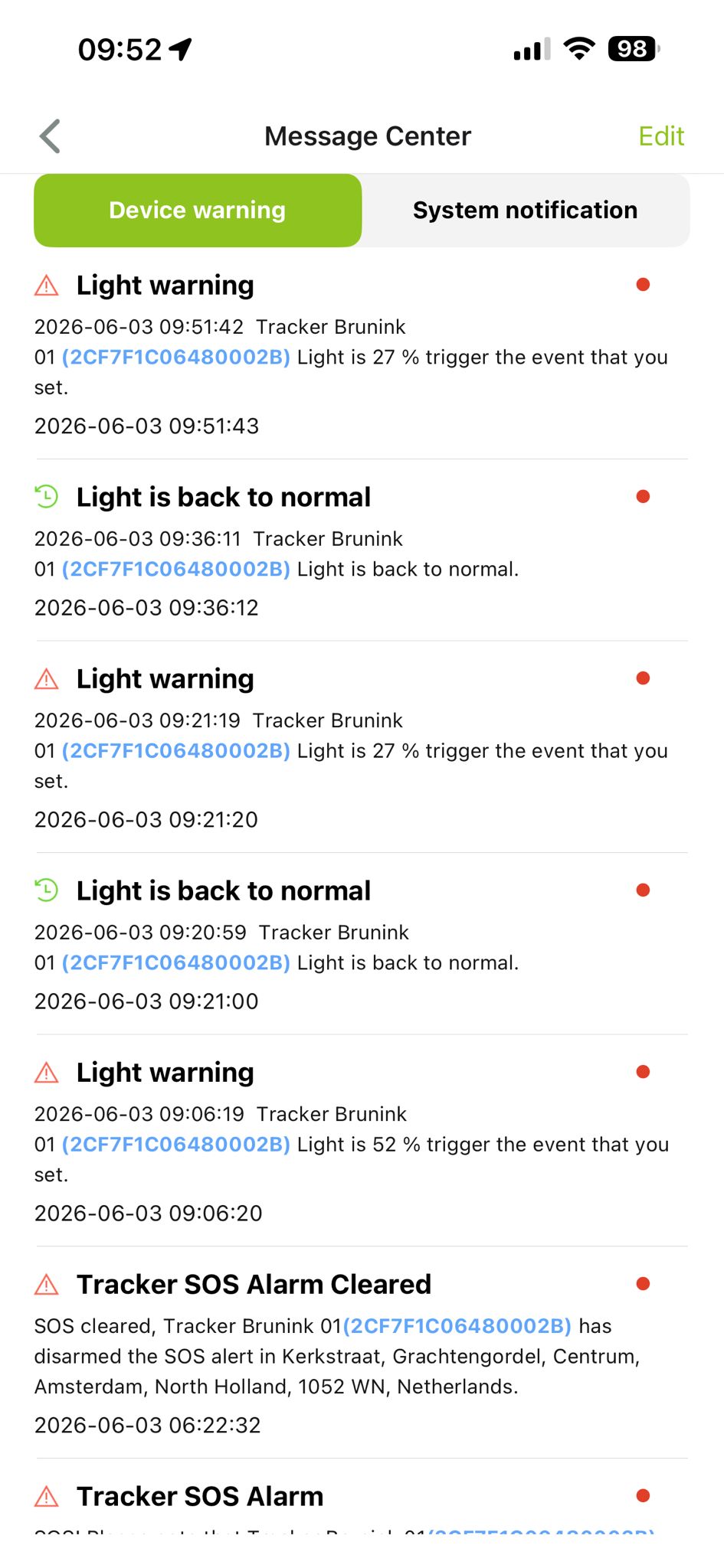

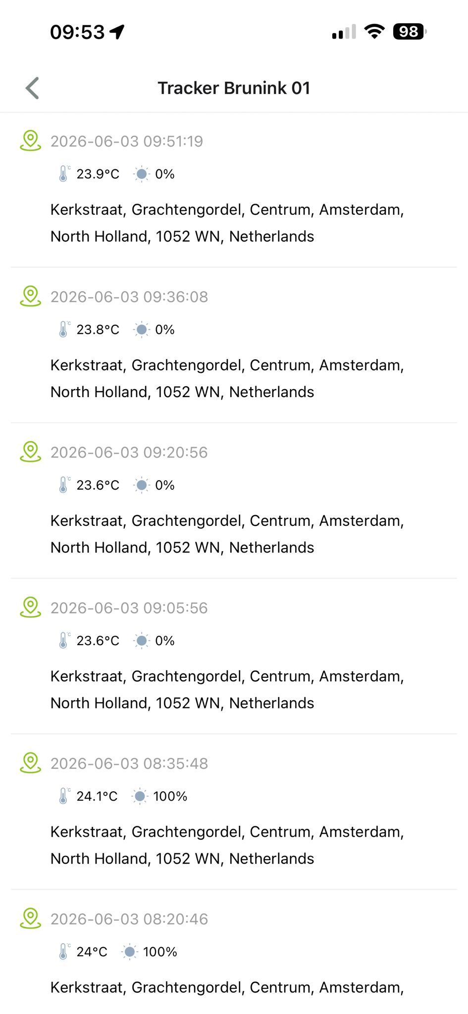

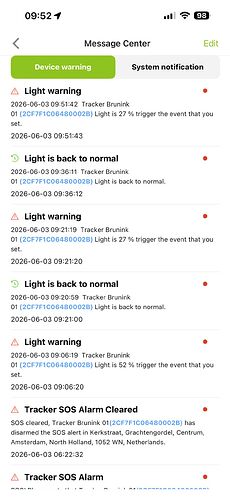

I’m using SenseCraft but getting a lot of push notifications for Tracker SOS Alarms and Light warnings/normal without the SOS button being pressed or any light detected on my T1000-A sensor. The Light warning message values also don’t match the light sensor readings in the GPS history log. Any ideas? Are these old messa…

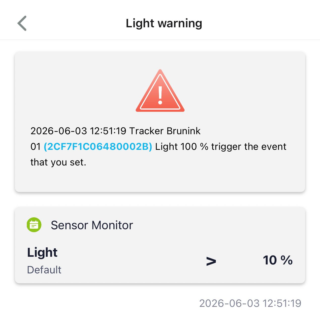

  • Notification rules: Only one rule (>10%)
  • Compare the timestamps: As you can see in the screenshots, there are no delayed or cached events
  • Connectivity issues: The LoRaWAN coverage is not very stable in the center of Amsterdam, but I did not press the SOS button that many times (I can see more than 20 notifications in the last 24 hours)
The notifications appear with a small delay after a data update.
I have the device for testing purposes — I only have one device and one user account.
I don’t see the GNSS Data Cache working at all, even though I have it enabled.

but I just get this one in, but the last Data Upload Time is 12:50:55 (also in the SenseCap Seeed portal) is:
Light-4199 0% 2026-06-03 12:50:55 / 2026-06-03 12:50:59
